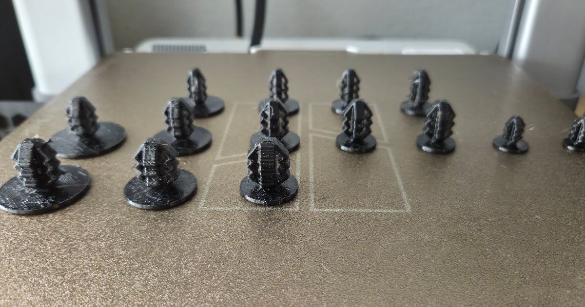

I copied one of the plugs from this guy’s assorted plug .stl and printed it as a plug for my anchor bolt holes.
> **[Automotive Trim Clip Assortment (TPU Only) by Matt Richardson | Download free...](https://www.printables.com/model/1243486-automotive-trim-clip-assortment-tpu-only)**
> Universal trim clip assortment | Download free 3D printable STL models
It prints brilliantly in tpu with no supports in a very short time. Easy in and out of a 3/8" anchor bolt hole. Lays very flat against the floor to protect the anchor from dust and debris.
