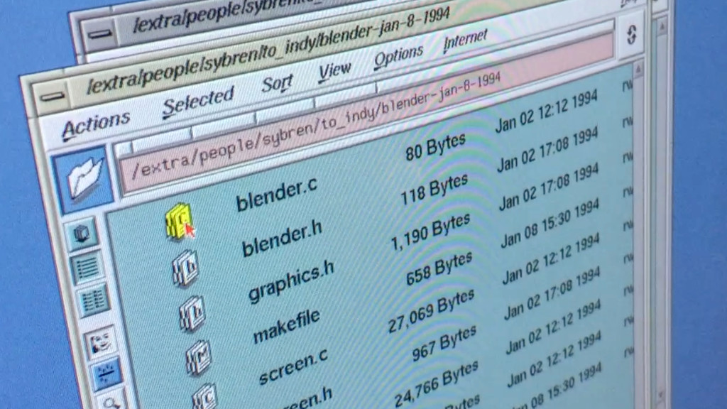

More obtuse but totally free and can do 2 & 3 is Blender.
> **[blender.org - Home of the Blender project - Free and Open 3D Creation Software](https://www.blender.org/)**
There are options to get .svg exports. I also see options to .dfx My son jumped in to blender at about 16 and is now 23, he can kick out a design pretty fast. Lots of youtube on how to get going.
