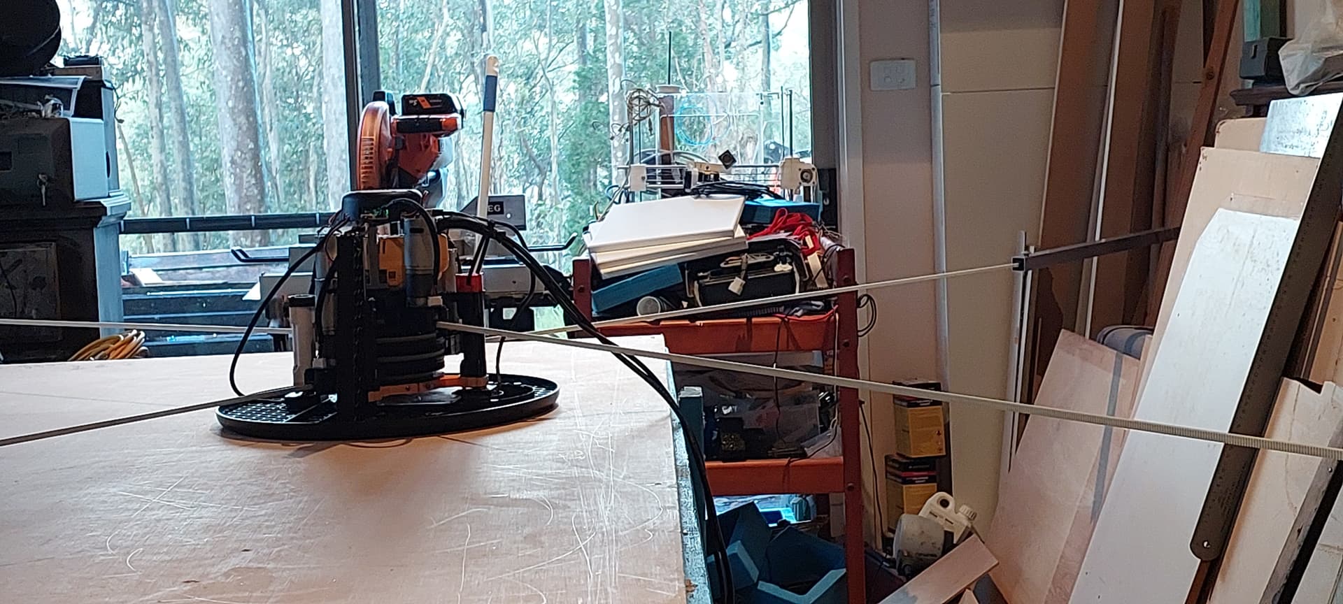

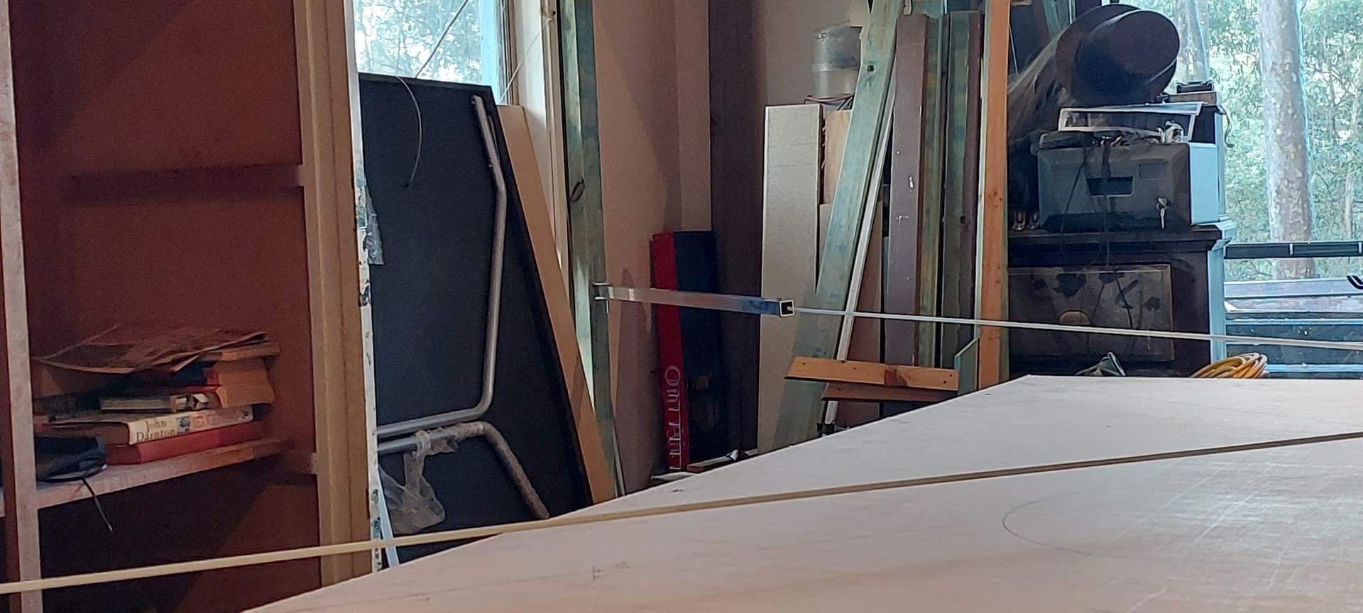

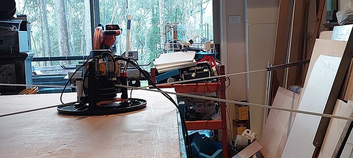

I have had a lot of trouble with the vertical setup, as I couldn’t get enough room to position the belts far enough away from the work area. I have been considering extending the belts by adding a fixed extension to each and going back to a horizontal setup. I have also been worried a broken belt would let the Maslow crash into the concrete floor.
I went into FluidNC Settings, Config items and changed Maslow\_beltEndExtension to 1000 and the Z offsets to 0 and added a 1000mm Sq Aluminium extrusion to each belt at the height of each arm fixed to the wall via angle brackets and a 1/4” bolt. A 10mm bolt attaches the belt to the Aluminium extension. Easy to remove as it just drops in.
I then ran a calibration. Still some work to do but I am pleased with the results so far. Attached Maslow serial Calibration Logfile
[Maslow-serial.log](https://forums.maslowcnc.com/uploads/short-url/aOF4vjT6VuGxf8VaqU0kRDshzim.log) (61.2 KB)
The bench is on wheels so can be pushed out of the way when not in use.

Looking good! I think that you are the first person that I’ve seen to actually experiment with adding extensions like that so I would love to hear how they work and I’m super stoked to hear that the calibration worked with those one there because the math said that it _should_ work but it’s a different story to see it actually working 😀
**Post date:** [August 14, 2025, 9:28pm UTC](https://forums.maslowcnc.com/t/added-1-metre-extension-to-all-belts-and-went-back-to-horizontal/24717/3 "2025-08-14T21:28:10Z")
I ran the config on V1.07 so I wouldn’t have multiple changes to confuse me if anything didn’t work as expected. Only problem I had was I had to extend the belts to reach the anchors, which required me to do a Retract, extend dance. I could not extend without a restart. Looking forward to trying V1.09

Oh interesting - What’s your total ‘frame size’ with the extensions @ian_ab ? Did you find you needed to up the retraction force or anything to get the extensions to swing and be straight or was it working with your usual forces?
**Post date:** [August 15, 2025, 5:45am UTC](https://forums.maslowcnc.com/t/added-1-metre-extension-to-all-belts-and-went-back-to-horizontal/24717/6 "2025-08-15T05:45:41Z")
> [@RandomDave](#):
No, what I did do is pulled the machine apart and sanded the arms where the belt drum rides and greased it with a mixture of graphite (used for key locks) and petroleum grease so they glided smoothly. I then did a retract, extended, set the retract to 200 (not expecting the belts to retract) Retracted (all belts went in). I repeated Retract/Extend but this time held the belts from retracting and then extended them until they were completely extended, reset the Retract to 900, Retracted the belts holding pressure on them so they packed properly. Extended again, and this time did a calibrate with results above. I did a couple of dry runs of a simple job without router or vacuum attached.
Now to try V1.09
> [@RandomDave](#):
From yaml tlx -170.2, tly 4044.4, trx 4496.0, try 4013.8, blx bry & bry 0.0 brx 4532.4 (all rounded to 1 decimal place) . Z values all 0’s. Calibration and Retract values 900. Extend distance 1980

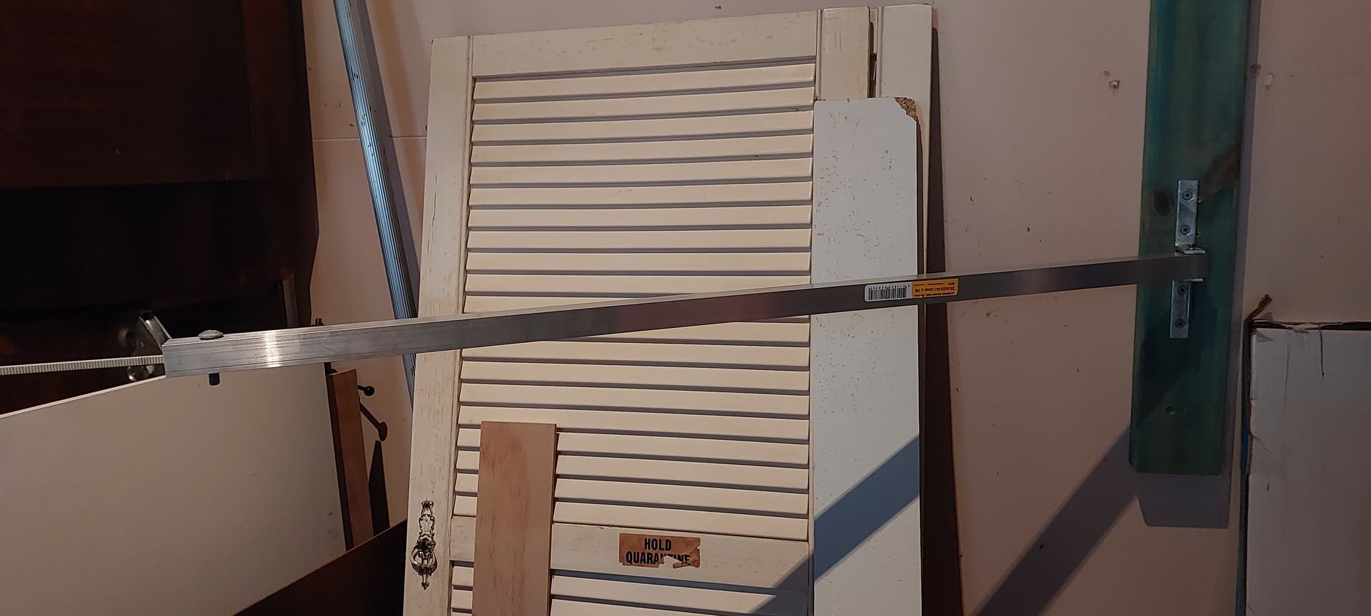

Update on experience with Belt extensions.
I used a standard 1 metre length of square tube aluminium as extensions to the belt, pivoted on the wall with a 6mm bolt, between to right angle brackets. Each was adjusted to be level with the corresponding belt when the Maslow Z was all the way down. On the belt end of the extrusion, I drilled a 11mm hole to drop a 10mm bolt through to intersect with the belt end. Because a window on one wall prevented me from aligning the anchor points in a perfect rectangle, there is an offset of about 120mm in the X direction (which I believe may cause a problem with obtaining a perfect square, more later).
Calibration went well.
Using David Langs software to calculate “Green” cutting area the entire workspace is in the green with plenty to spare.
I have made a pencil lead holder to allow me to simulate cuts without using up material. Using this I have determined, after adjusting, the Maslow appears to be extremely accurate in the X direction, and accurate in the Y direction at the left of centre, but decreasingly accurate as it moves to the right (only off by approximately 3mm after adjustment), so in effect a rectangle marked at maximum spacing is narrower at one end by approximately 3-4 mm. I think this maybe associated with the non-squareness of the anchor points, as it is only off in one direction. If anyone has a perfect rectangle perhaps they can prove this theory.
Overall, I am happy with this change and recommend it if you want to take advantage of available space, while minimizing impairment when doing other work. Also you don’t have to drag out as much belt.
I would also strongly recommend making the belt arms as friction free as possible, as I am confident this has contributed to the accuracy of the Maslow.
