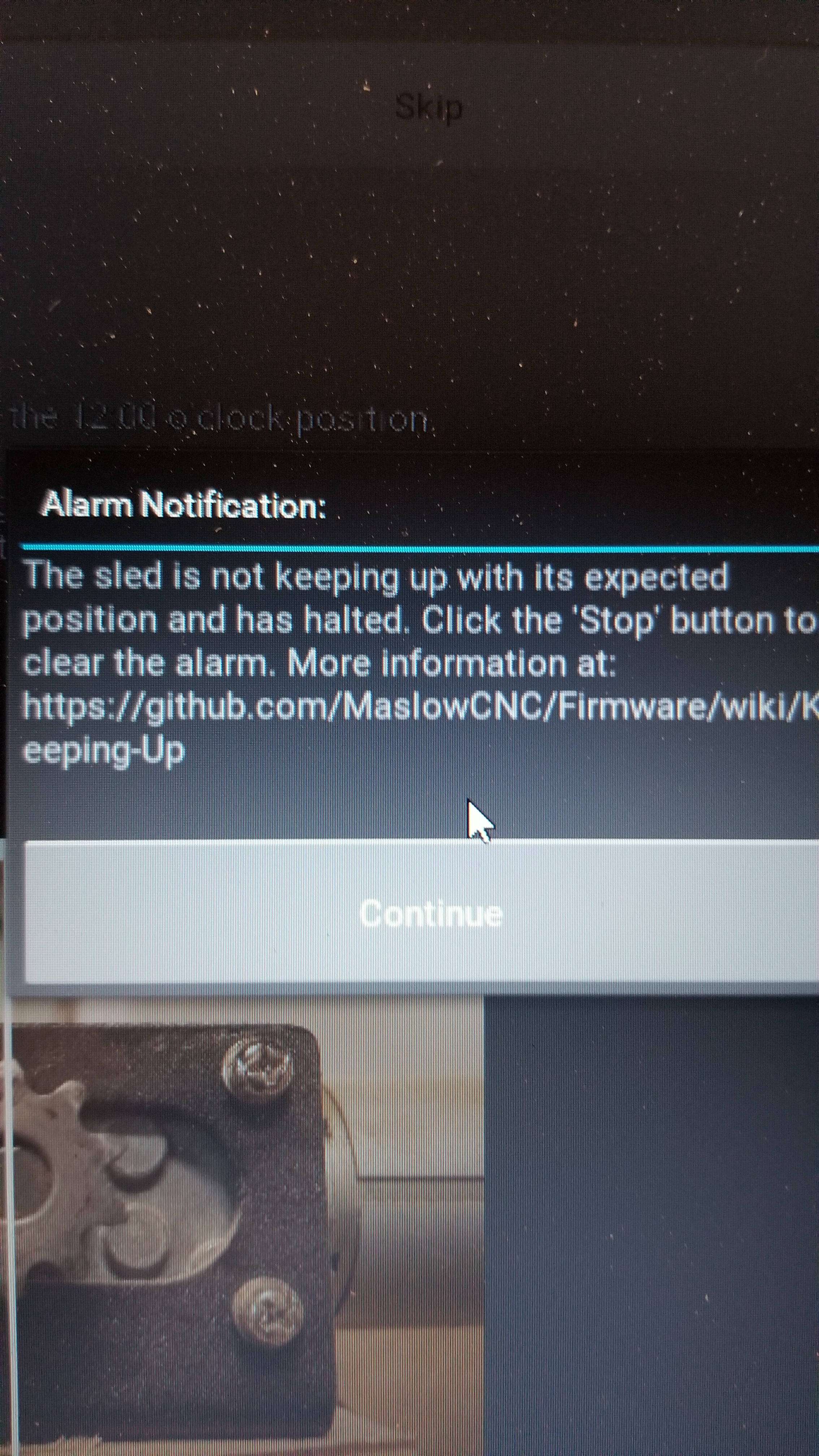

I started this thread, when the thing went a little nutty and kept going up and up and up and the ring bent. [My Maslow is destroyed, please help me figure out what happened](https://forums.maslowcnc.com/t/my-maslow-is-destroyed-please-help-me-figure-out-what-happened/10748)
Eastbay sent me a new ring I installed and now I am trying to calibrate and the motors do not move. Here is the info that may be helpful
- It is plugged in correctly everywhere
- I wiped out the EEPROM
- I reflashed it with version 1.6 of the firmware
- I reset settings to defaults in GC
- It shows as connected in GC
- When I run the motor test all 3 fail
- Beat my head against the wall for a while, didn’t help.
- Unable ti find valid machine position message appears when I first start GC
- Sled is not keeping up appears when I am calibrating.

#### Post date: [August 15, 2019, 6:12am UTC](https://forums.maslowcnc.com/t/all-3-motors-fail-after-rebuilding-from-destruction/10863/2 "2019-08-15T06:12:11Z")
Seeing a failure on all three motors almost always indicates an issue with the controller not getting power, although since this is following a such a big event, lets take that conventional wisdom with a grain of salt. Can you confirm that the green light on the motor controller shield is illuminated, and that it goes on and off when you unplug and replug the power supply?

Don’t worry about sled position errors or sled not keeping up until you can get the motors/encoder test to pass. The controller is the same controller that you were using when things went bad?

Just spitballing here, but I wonder if something got damaged on the motor controller when the damage occurred to the ring. The picture you posted suggests that everything is hooked up correctly. I doubt all three motors could have failed since the z-axis probably wasn’t running… so I tend to look at the motor controller since the arduino board seems to be communicating with ground control.

So the green light on the motor control shield was NOT on. Other green lights were on. For shits I tried a new power supply that I bough when I screwed up previously. I plugged it in and everything works. Can’t imagine how that would go bad when I wasn’t even using it, but whatever. Thanks.
