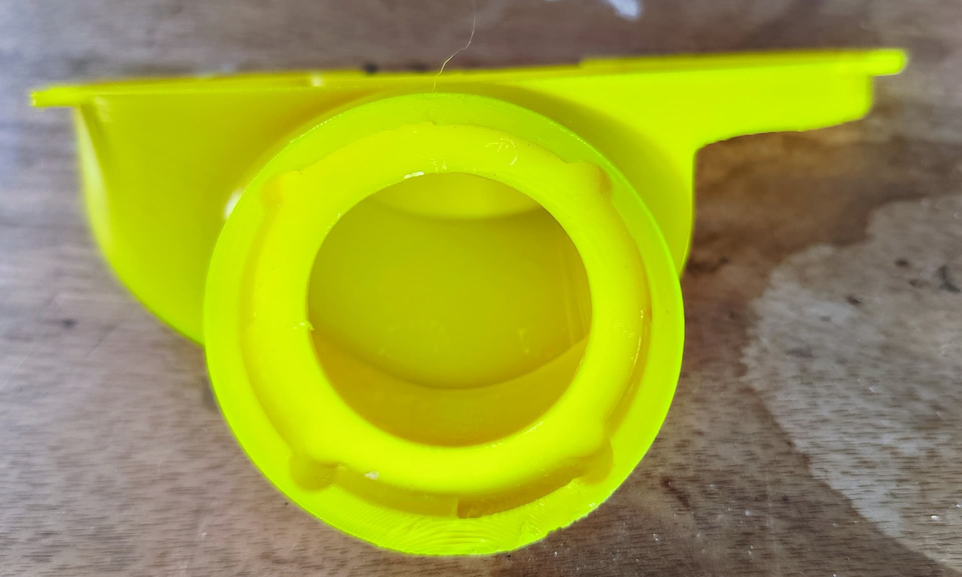

I didn’t like my existing dust port design. There was definitely still the chance for clashes with the bottom left arm should Z be fully bottomed out. Plus I wanted a better connection to the vacuum / dust extractor, where I could get close to the full width of the hose pipe for the outlet.
So here’s some pictures.

And from the connector side of things.
 ![IMG_20240904_115505](https://canada1.discourse-cdn.com/flex031/uploads/maslowcnc/original/3X/4/4/44f9c3457554e784cc969f3930f1d452ea859cd1.jpeg)

**Post date:** [September 4, 2024, 9:58pm UTC](https://forums.maslowcnc.com/t/alternate-dust-port-design/22212/3 "2024-09-04T21:58:36Z")
The disconnect works pretty well. I made the socket part slightly larger than the plug part. But I found that with a really good 3D print they may be just not quite snug enough to really hold together if there’s lots of movement.
However, for the M4 dust port, with all of the support material it needs, the print is just sufficiently “not quite right” to ensure a good snug fit, that’s still reasonably easy to do up, and undo
