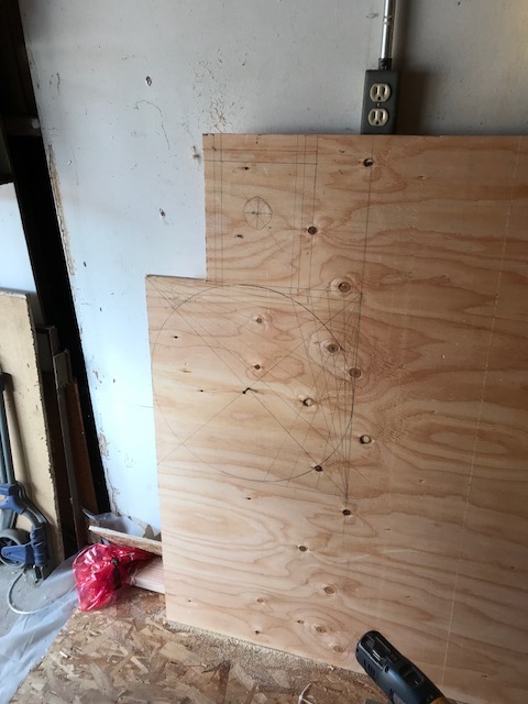

Here’s my original test drawing of a top mounted design:
 ![Top-mount linkage8-25-17](https://canada1.discourse-cdn.com/flex031/uploads/maslowcnc/original/2X/e/e24fc4104df27601606e2224be8ce3dc69879bb8.png)
And [here’s David’s improvement on that design](https://forums.maslowcnc.com/t/throwing-my-hat-in-the-sled-modification-ring/193/257) by using cut-outs for chain clearance. Note that the actual lengths of the bars is not critical as long as they clear your router. The critical part is that they are _consistent_ with each other. The distance between the top hole and center hole in the vertical bars must equal the distance between the top and bottom mounting points on the sled _ **AND** _ the distance between the center hole and the chain mounting hole in the vertical bars must equal the distance between the bottom mounting point on the sled and the center of the router bit. The length of the “horizontal” bars will dictate how where that red dotted line is, this is the point that the tip of the chains will trace in space. All 4 horizontal bars must match each other.
And here is my original 45˚ design drawing:
 ![45DegreeMount8-25-17](https://canada1.discourse-cdn.com/flex031/uploads/maslowcnc/original/2X/5/5a3fd3315375a65d22d3bff21c41feb90361e15e.png)
Similar rules apply, parallel bars need to be the same length as each other. Lengthening the pivoting bars will move the red dotted line. Lengthening the two 45˚ bars (the bars that the chains attach to) will buy you more clearance for the router. The chain mounting point does not have to be in the center of the bar, but it must match the distances between the sled mounting points and the router bit (4.5" in this drawing).
Both designs use the same principal of a parallelogram to trace a concentric circle around the router. The biggest mechanical difference between the two is probably that the joints in the top mounted design are under both compression and tension and joints in the 45˚ design are all under tension.

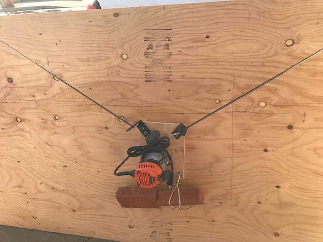

So some quick pictures of my progress - I will be writing up the information on the framing in a post later tonight.
 ![IMG_3322](https://canada1.discourse-cdn.com/flex031/uploads/maslowcnc/original/2X/f/fb2e9b55d3af05df0ad35a93e097a6cd46fa165a.jpg) ![IMG_3327](https://canada1.discourse-cdn.com/flex031/uploads/maslowcnc/original/2X/d/d648fbbf44977651a83f4c0d6964c54a662e4f82.jpg) ![IMG_3343](https://canada1.discourse-cdn.com/flex031/uploads/maslowcnc/original/2X/c/c558d4246543f9bef241d6edf33d1f6f462bacee.jpg) ![IMG_3359](https://canada1.discourse-cdn.com/flex031/uploads/maslowcnc/original/2X/f/f16ecdd2244556e57f20aa64b39eeaad266194ff.jpg) ![IMG_3341](https://canada1.discourse-cdn.com/flex031/uploads/maslowcnc/original/2X/5/595dbf8fe6fc34927ab9d972349bb0edc62247d7.jpg)
I did a little cable management at the end. I need to counter sink some bolts and I need screws to mount the router. I also need to mount the Z axis. Progress is being made.

![20171116_165104](https://canada1.discourse-cdn.com/flex031/uploads/maslowcnc/original/2X/9/923738ed92d7e081ef1f7dd0a5da117f4346ce57.jpg)My first Sled is on it’s way.

Tip number 2 - I’m going to use Bees Wax on my sled. I’m also considering replacing the bricks with water bottles for adjustability.

So I made lots of progress today. I have the basic setup and calibration done. In theory it is ready to cut. Monday I will add the Z axis. Then switch to working on the final sled design. My linkage should be on it’s way today. I also have an idea for a triangular sled design.
I did have about an hour of my day go out the window due to a faulty powerstrip. Once over that speed bump it was smooth sailing.
I added a Parts/Shtuff holder & a Pencil holder.
Once I’m done I’m writing a book. I have a grip of little tips to make it easier to build.
