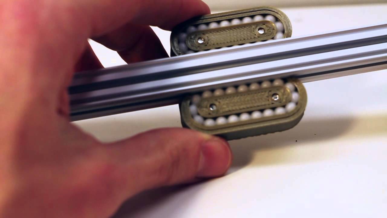

small linear rails are not that pricy, but I do wonder about their survivability
in the fine dust around a maslow. I would look at 8020 style rails and either
wheels or recirculating bearings along the lines of
[![](https://img.youtube.com/vi/UTxivqmK4s0/maxresdefault.jpg "3D printed recirculating carriage") ](https://www.youtube.com/watch?v=UTxivqmK4s0)
I have a CAD model of them at
> **[Onshape](https://cad.onshape.com/documents/26ee0e5b03c66a9be90c58d1/w/d1099d18ac6dfbbd3e15d280/e/92afbf062997c6e0ad010ccb)**
> Sign in to Onshape, the #1 fastest growing CAD system in the world with over 3 million users.
which works pretty well (you can get 5/16 or 3/8 bearings really cheap if you
look on Amazon for slingshot ammo)
while the aluminum rails are soft enough that grit may end up getting embedded
in them over time, they are cheap to replace and available in many widths to
be able to get a wide enough base to make them solid.
