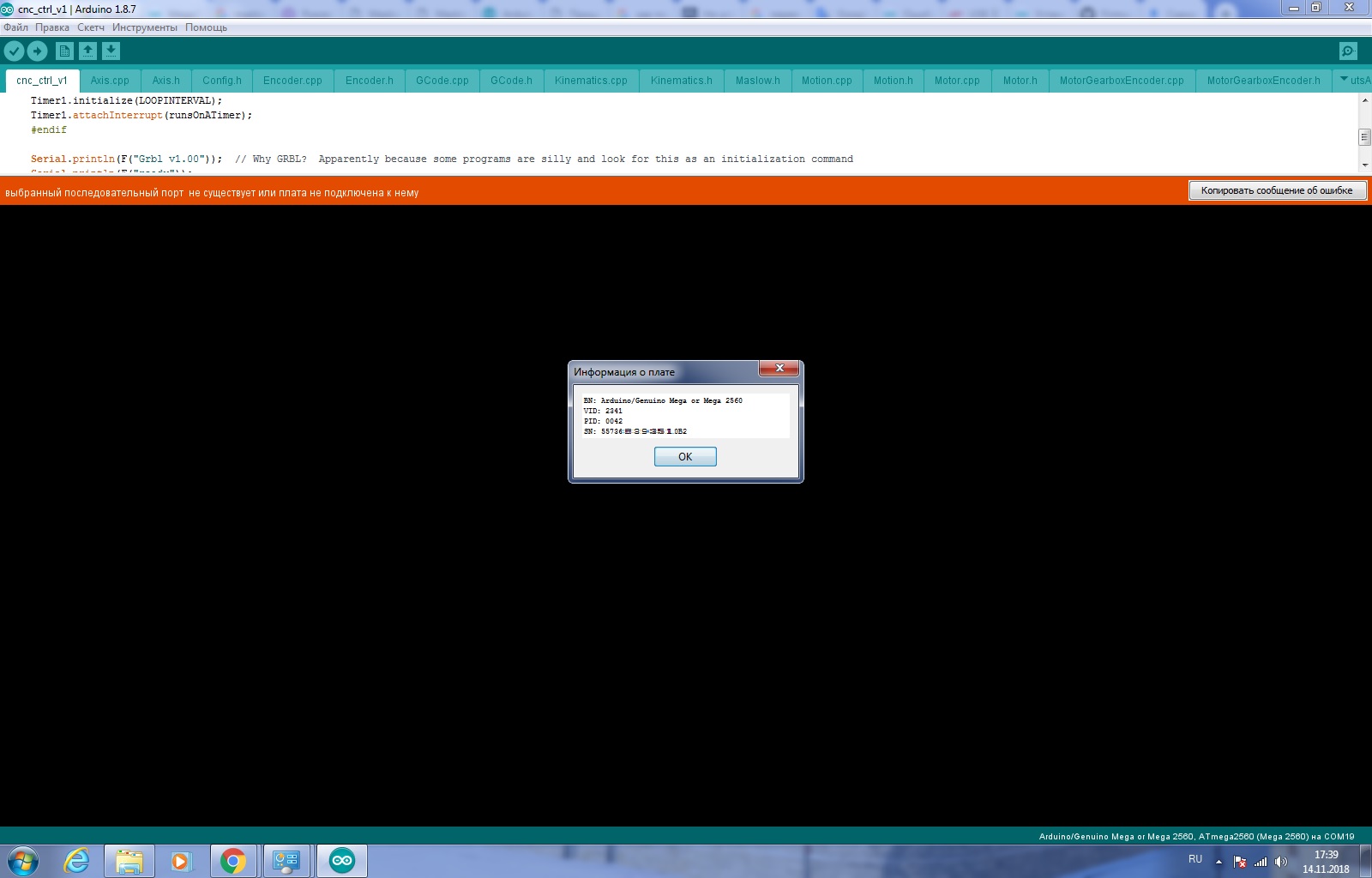

**Author:** ![UNUS\_TRESQUATRO](https://yyz1.discourse-cdn.com/flex031/user_avatar/forums.maslowcnc.com/unus_tresquatro/32/10082_2.png) [@UNUS\_TRESQUATRO](https://forums.maslowcnc.com/u/UNUS_TRESQUATRO)\
**Post date:** [November 13, 2018, 1:21pm UTC](https://forums.maslowcnc.com/t/aurdino-proble-help/7702/3 "2018-11-13T13:21:54Z")
![%D0%B2%D0%B2%D0%BC](https://canada1.discourse-cdn.com/flex031/uploads/maslowcnc/original/2X/1/17bf2f91e570d0944b7f573d0afa547f562dbdff.jpeg)
one port only
**Post date:** [November 13, 2018, 1:26pm UTC](https://forums.maslowcnc.com/t/aurdino-proble-help/7702/4 "2018-11-13T13:26:53Z")
Looks OK.
Did you try to upload the ‘blink scetch’ from the examples? Does that also give an error?
Also maybe try the stable arduino IDE instead of the ‘nightly build’.

**Post date:** [November 13, 2018, 2:08pm UTC](https://forums.maslowcnc.com/t/aurdino-proble-help/7702/10 "2018-11-13T14:08:55Z")
So there is no good communication with the Arduino Mega.
> <https://stackoverflow.com/questions/19645441/avrdude-stk500v2-receivemessage-timeout/29135050#29135050>
If it’s the ‘bootloader’, there was a trick somewhere to press the reset button at the right timing. Let me see if I can find that.

 ![image](https://canada1.discourse-cdn.com/flex031/uploads/maslowcnc/original/2X/3/3fcb03d492969882e1ecf08091cb6382d3e51db0.png)
**Post date:** [November 14, 2018, 12:31pm UTC](https://forums.maslowcnc.com/t/aurdino-proble-help/7702/18 "2018-11-14T12:31:09Z")
Do you get an answer from -\> tools -\> board info?
 ![image](https://canada1.discourse-cdn.com/flex031/uploads/maslowcnc/original/2X/c/cb32ff1ad11f1a51efcf37cb480558e6b00b231e.png)

We found one problem, it was a driver per port, it was not updated, we manually updated it. There is a new problem …
I did not receive information about the board before, how to install the driver manually, now there is information about the board
 ![%D0%B2%D0%B2%D0%BC](https://canada1.discourse-cdn.com/flex031/uploads/maslowcnc/original/2X/1/1e592fb9a3949fbf9654b3c1bbd4a5130f1a9075.jpeg)

выбранный последовательный порт
не существует или плата не подключена к нему
**Post date:** [November 14, 2018, 3:18pm UTC](https://forums.maslowcnc.com/t/aurdino-proble-help/7702/20 "2018-11-14T15:18:37Z")
That means the Mega is connected, so the bootloader has an issue.
COM port 19??? What else is connected to the computer?
Is this the Arduino Mega from the original batches or where did it come from?
Is there a USB-Hub between the computer and the Mega?
There are options to load a new bootloader to the mega, but that requires a second arduino and skills to follow instructions by the point. I would not recommend that if you don’t have done something similar before, or you might end up with an unusable board.
