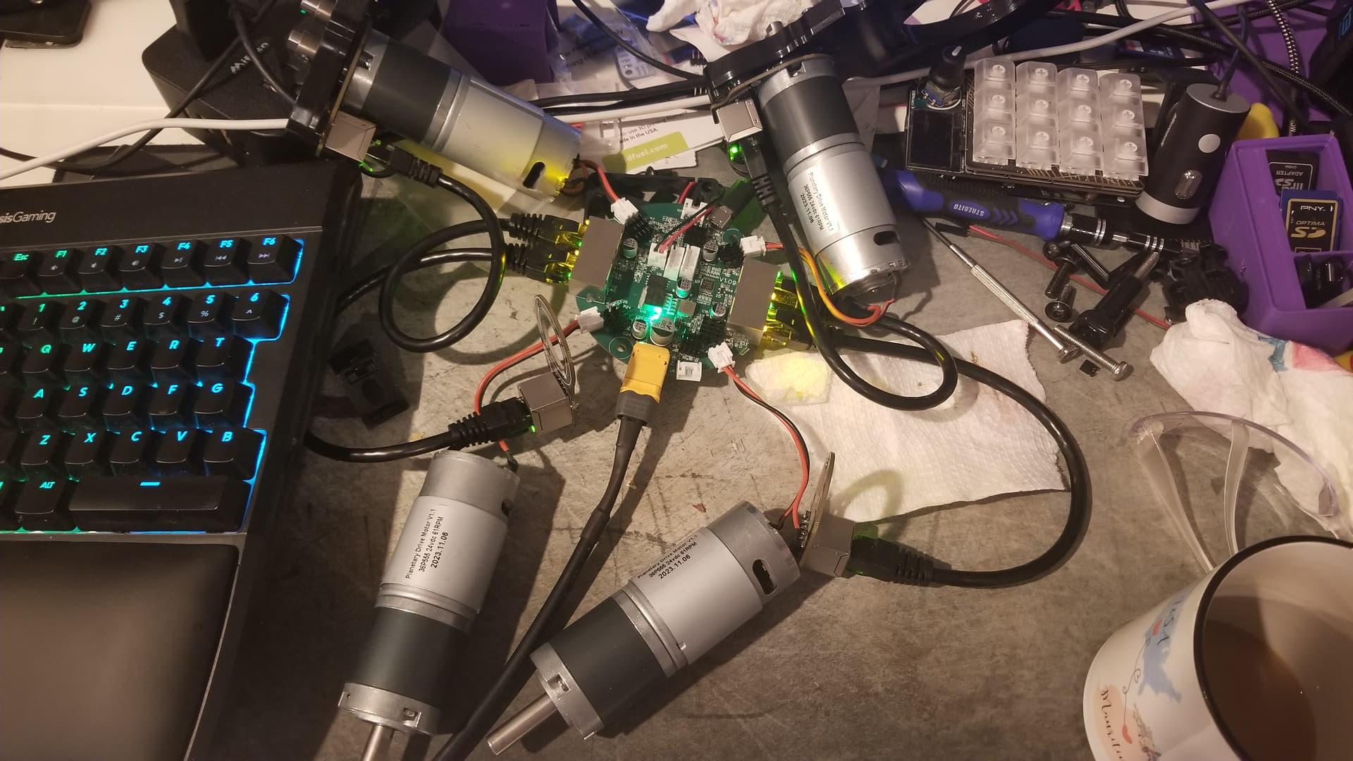

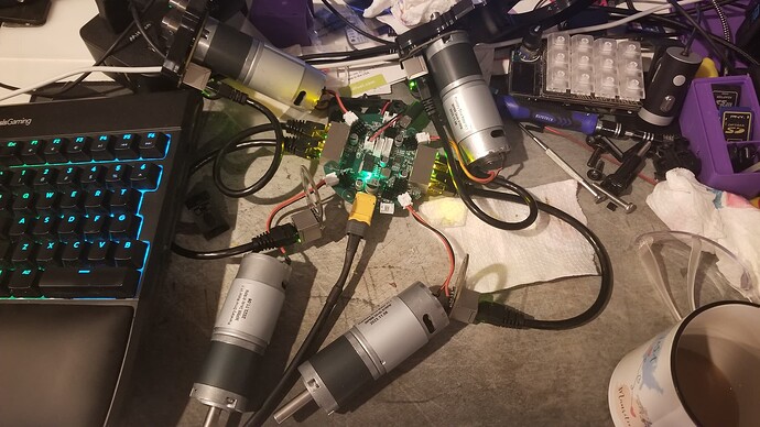

In the mean time am screwing around with trying to control the motors using custom firmware loaded onto the 4.0 PCB, would be neat to repurpose the board for another project. Curious if anyone’s done something similar? I don’t need full FluidNC functionality, I just need to move the motors when a button is pressed, for now. I appreciate the open sourced PCB schematic, layout and [forked fluidnc firmware](https://github.com/barbourSmith/FluidNC) are all shared to play with, thank you!
 ![20250621_120012](https://canada1.discourse-cdn.com/flex031/uploads/maslowcnc/original/3X/e/8/e81b71b1431f29802c487826f0f0662c6349f1e3.jpeg)
**EDIT:** 🙂, reading this gave me a much needed laugh…

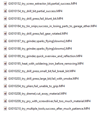

Cheers for the Sock-It-Out suggestion. I appreciate all the M3 button head bolt removal suggestions the community have been sharing on other topics too.
Ended up having to try out more approaches than anticipated, including angle grinding to release gear after I stripped a set screw (grub screw)…
[![](https://img.youtube.com/vi/Oo6RdAE886g/hqdefault.jpg "Maslow 4.1 upgrade, removing 4.0 bolts, try grinder, flying sparks and F Bombs...") ](https://www.youtube.com/watch?v=Oo6RdAE886g)
After that fluff up, for one of the other motors, I had better success by pre heating set screw with a soldering iron first (~20-30 secs) before loosening with a regular Allen key, the heat definitely helped soften the thread locker.

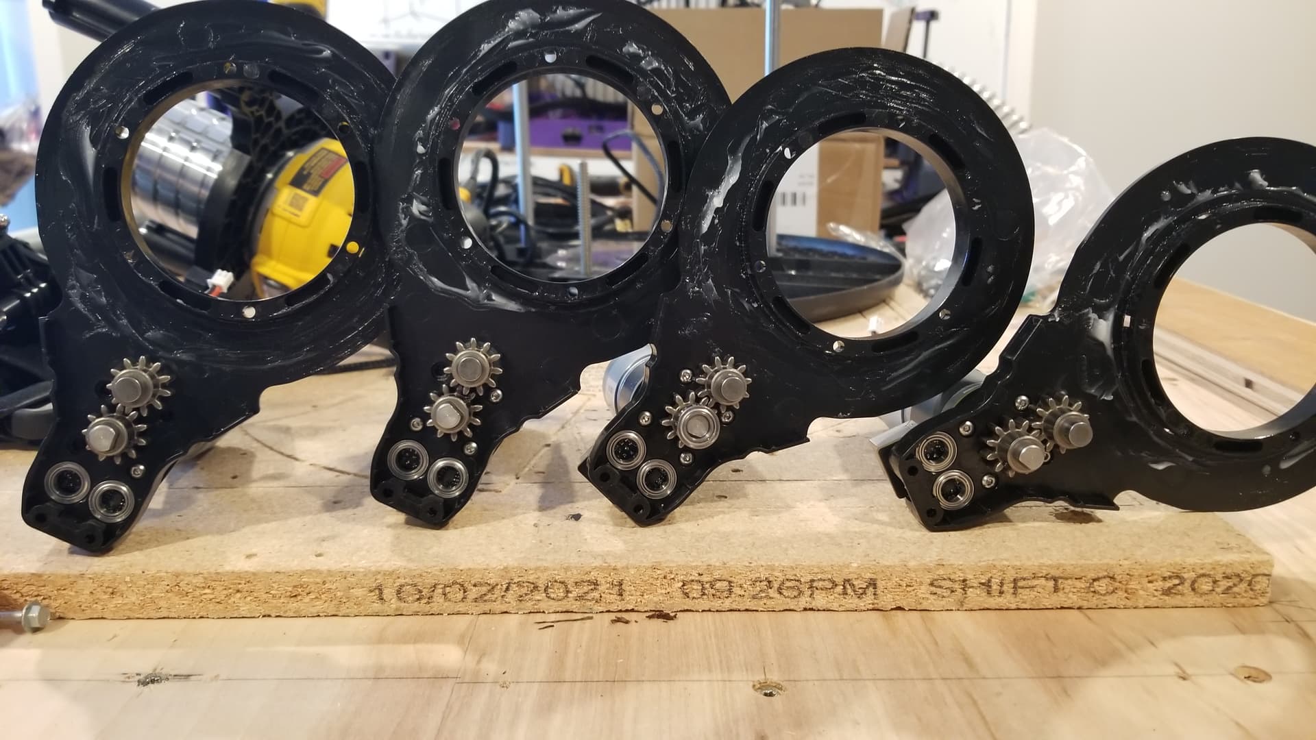

Noticed what looked like white thread locker on the brushed motor mount screws when removing them, but, I don’t remember using white thread locker during 4.0 assembly. So, guessing the motors originally came with pre applied dry thread locker?
I will be using blue Loctite 243 for my 4.1 build when mounting the motors to the new PCBs and arms. Hoping blue will be good enough, and less frustrating if/when modding/updating in the future.
I can share details on other approaches tried if anyone’s interested in info/fluff-ups?

Powdery white stuff on a screw coming out of the motor might be a corrosion product from aluminum or zinc.
Honestly, ANY loctite is better than none. I don’t think you need anything more fierce than the “small screws easy removal” type. The strong ones are WAY too strong for tiny screws.
