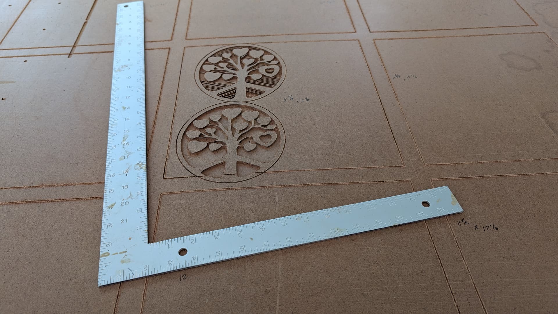

Is there a method now to add a correction coefficient for the X and Y axis, or should I scale this in CAD as previous threads suggested? I made a simple test grid of nine 12"x12" squares separated by an inch boarder in the center of the spoil board. Each was made by re-homing the CNC, and running gcode for a single square. The boxes measure a seemingly constant 11 5/8" (y axis) X 12 1/8" (X axis) on the hourglass frame.. If I can hone this in to around a 1/32" total variation on an axis, things will be close enough for my first projects.

probably best to do this in the CAD right now.

Any reason on why this is? I have a pretty consistent error on my y axis as well and was just planning on changing the “axes/y/steps\_per\_mm” to be higher by 1% like ive done on previous gantry style cnc routers. Is there something about the maslow as to why this wont work? I would really prefer not to have to scale in cad
**Post date:** [April 25, 2025, 5:01pm UTC](https://forums.maslowcnc.com/t/basic-x-y-accuracy-analysis-advice-needed/23892/4 "2025-04-25T17:01:48Z")
I think that it seems like a pretty easy thing to add to the settings. I’ll put it in there for the next version.

the maslow does not have the steps\_per\_mm setting given it’s very different
kinematics

So whats the steps\_per\_mm setting in the yaml config then if its not that
**Post date:** [April 25, 2025, 9:15pm UTC](https://forums.maslowcnc.com/t/basic-x-y-accuracy-analysis-advice-needed/23892/7 "2025-04-25T21:15:18Z")
FluidNC requires it to be there, but it’s not used for anything (except for the z-axis which has stepper motors).
Basically every other hobby level CNC router uses stepper motors so the software just expects us to have a value to put there.

Ah i see, well yeah if its possible to add that in, that would be a great tool!
**Post date:** [April 25, 2025, 10:28pm UTC](https://forums.maslowcnc.com/t/basic-x-y-accuracy-analysis-advice-needed/23892/9 "2025-04-25T22:28:13Z")
I should be able to get it in for next week’s update!
