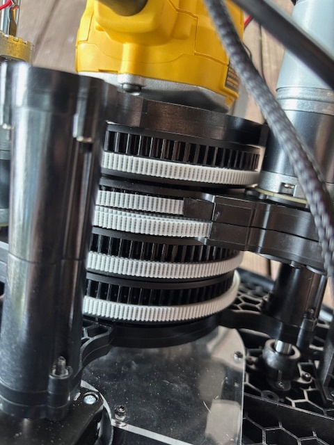

When trying to get through my initial calibration procedure the belt seems to have gotten jammed underneath the guard.
 ![IMG_6008](https://canada1.discourse-cdn.com/flex031/uploads/maslowcnc/original/3X/5/b/5bbbcf138664717ad7d36fd95a00bd255eeb830e.jpeg)
Is there any good way to try to recover from this scenario without having to disassemble the whole unit and take that arm apart? Any advice to prevent this?

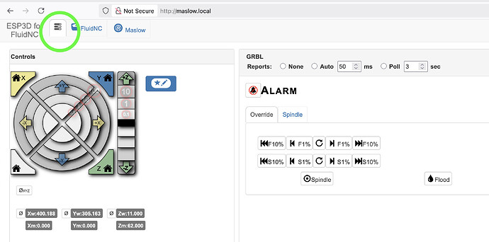

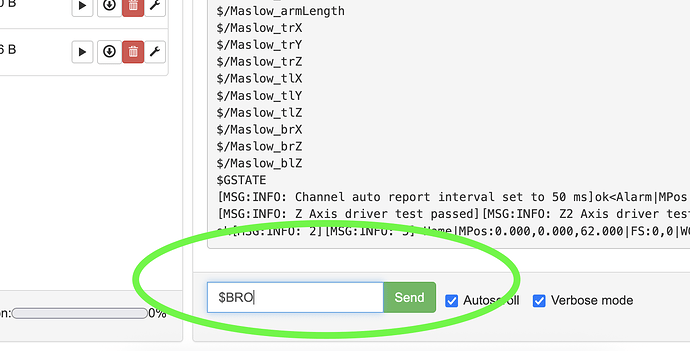

To extract the belt without taking things apart you can use the command “$BRO” (bottom right out) entered here:
 ![image](https://canada1.discourse-cdn.com/flex031/uploads/maslowcnc/original/3X/6/7/67564a836097025349575919c3b438f1805ecd8b.jpeg)
 ![image](https://canada1.discourse-cdn.com/flex031/uploads/maslowcnc/original/3X/e/a/eac5b438e6ea70c4ca8b4dcdcf6c7c07df64aa0a.png)
It’s kind of a hidden feature because you can pretty easily break things with those commands. Basically it will overide every safety check and give the bottom right motor full power in the out direction
**Post date:** [June 23, 2025, 7:25pm UTC](https://forums.maslowcnc.com/t/belt-jam-under-belt-guard/24410/3 "2025-06-23T19:25:17Z")
You can also use `$BRI` if you want to go the other way

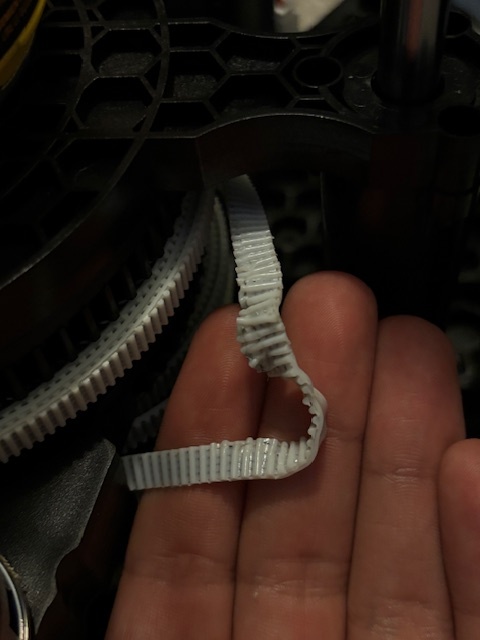

Thanks for the tips that worked great for clearing out the jam! Unfortunately the belt came out of the other side pretty mangled so I guess I will be having to rebuild anyway

If the mangle is near the end you might be able to cut it out. It depends how big your frame is too.
