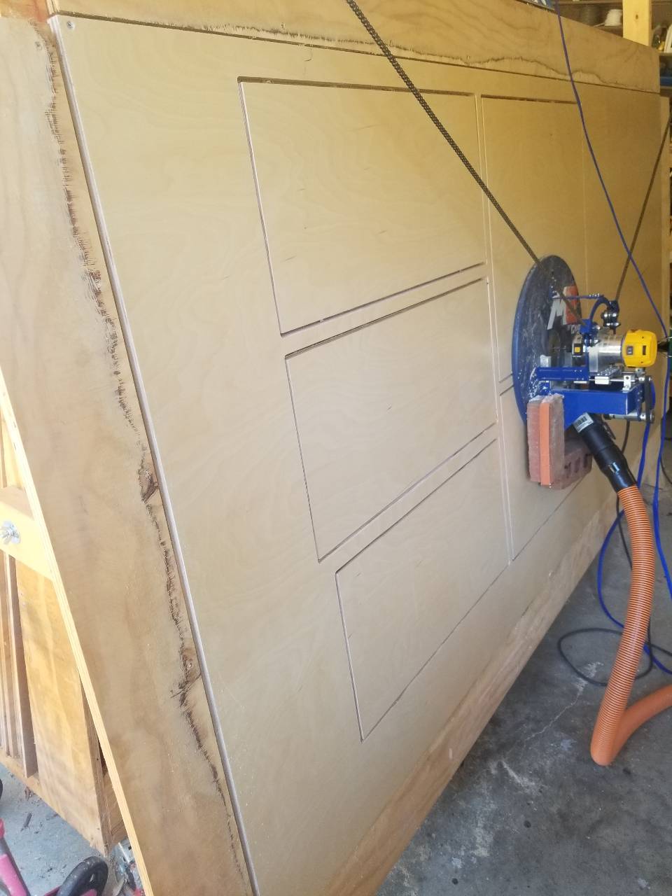

On y axis at left side bottom of 8 x 4 Sheet. Also wanders on the x axis when over on the right side (last 4~5 inches) on a 4 x 8 sheet. I can get it to cut straight if I press down on the router adding about 5lbs to the pressure.
Have extended chains on 12’ span.

The set up is exactly 15% per the digital gauge. Levels on X & Y axis confirm level and plumb. Full skirt shaved down to below work piece to preclude sled from catching as it slides to the edge of the workpiece. The material is prefinished one side birch plywood cabinet grade (very smooth).
Vertical cuts on both sides toward the edge it wanders to the center of the workpiece. On the right side the horizontal cuts wander up at about 8" from the side of the workpiece.
Slowed cut to 18" per minute. Router is at lowest setting with 1/4" compression bit. Chip size is good, not making powder and bit is not discolored from heat build up.

**Post date:** [September 27, 2022, 7:18pm UTC](https://forums.maslowcnc.com/t/bit-wanders-at-extreme-edges/18296/10 "2022-09-27T19:18:03Z")
compression bits are a bad idea, they work on the idea that you have the center
of the bit at the center of the workpiece, which is not the case with the
maslow.
can you post a video showing it misbehaving?
