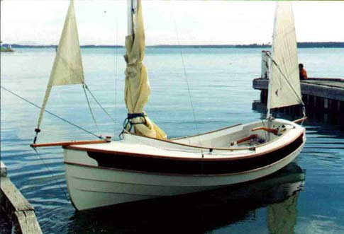

![](https://canada1.discourse-cdn.com/flex031/uploads/maslowcnc/original/2X/f/fdfbb66ec59fcba8f52c9d5ac80f2e27b749352d.jpg)
It’s been a minute since I discussed boats that one could CNC and we’ve been discussing boats with bluff bows and hard chines for reserve buoyancy on another thread. You can’t really have that discussion without mentioning the San Francisco Pelican or it’s siblings the Great Pelican and Pacific Pelican. The original SF Pelican was designed by Bill Short specifically to be able to handle the blustery conditions on San Francisco Bay. I taught sailing there for three years and can attest to how exciting it can get. It was also designed to be easily home-built, in fact, I’m not aware of any company that produced these. EDIT: I forgot that Smith Brothers (of El Toro fame) built Pelicans on Samish Island, WA.
They feature hard chines and scow bows for lots of bouyancy when and where you need it. I love any boat with a bowsprit and these sport a nice-sized jib for light air to balance the sprit rigged mainsail. While looking like a bathtub on the hard, these are graceful swans on the water. We just joined the Center for Wooden Boats on Camano Island and they actually rent these beasts, so I’m going to head over there soon and literally get my feet wet.
The plans are reminiscent of the old Popular Mechanics style line drawings, but you could apply some modern stitch & glue techniques to possibly simplify the build. Also, being pretty much slab sided, I’m not sure how much a Maslow would help, but that’s why we’re all here. Once again, scarf/puzzle joints and possibly tiling your cuts rear their ugly heads, but that’s part of the design challenge fun. I believe these boats are also built on a frame/strongback so you have to cut the boat free once you’re done, rendering the frame pretty much useless if you want to build a second one.
An option that a lot of builders go for is putting a cabin top on their Pelican for dry storage and possibly a drier sleeping arrangement. With or without the cabin, these boats are serious camp-cruisers. This boat is definitely on my short list of potential future builds. I’m also a member of the Yahoo Group, which is a great source for info & support.

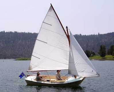

Over the years, I’ve found several catboats that could definitely be built with the help of a Maslow. While some purists have had stability and handling issues with the various Stevenson Projects designs, I think the [Pocket Cruiser](http://www.stevproj.com/IntroPCPg1.html) might be a bit more forgiving. Knowing their approach, this is probably one of the more simple builds available.
 ![image](https://canada1.discourse-cdn.com/flex031/uploads/maslowcnc/original/2X/9/9802b7a2f9df1a9b367aef5d049c3c71f0c6b14e.jpg)
I believe Sonny built his Bolger/Payson project based on the plans and the book (available on [Amazon](https://www.amazon.com/Build-Instant-Catboat-Harold-Payson/dp/1934982091/ref=sr_1_1?ie=UTF8&qid=1533137234&sr=8-1&keywords=build+instant+catboat) or [Payson’s website](http://www.mcssl.com/store/hhpaysoncompany/instant-boat-plans/catboat))

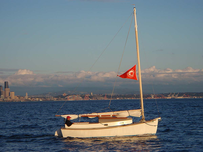

Also, you can’t really discuss stitch & glue catboats without mentioning Sam Devlin’s [Wompus Cat](https://www.devlinboat.com/tag/cat/). He’s a great designer and I believe modified a Ted Brewer design for S&G construction. I’m lucky enough to live in the PNW, where I attend the Port Townsend Wooden Boat Festival in September every year. Sam is also local, so I’ve been fortunate enough to both see a bunch of his designs in real life and actually get to meet/chat with him.
 ![image](https://canada1.discourse-cdn.com/flex031/uploads/maslowcnc/original/2X/b/bd246c0e6c7655cf17f63ecc14c3d6d6ff0f8ebb.jpg)
So now that I’ve made the introductions, let’s discuss what catboats are all about. BTW, there are probably other designs out there that I’m just not aware of. Anyway, catboats are known for having a few distinct advantages. First, they are really beamy (wide) for their length. This does a couple of things. It means you can have a nice roomy cockpit for crew. It also means a ton of reserve buoyancy (the more it heels/tips, the more it resists).
The second advantage of being a catboat is they tend to be very simply rigged. They often have unstayed masts and only a single (albeit rather large) mainsail. This means they’re much more simple to sail, especially if you have a bunch of people in the cockpit. With that being said, there are plenty of catboats out there that the designers/builders have opted for a bowsprit for a jib to help with tacking.
Catboats are great, elegant daysailers (makes me want to wear that white captain’s hat). You could easily be the prettiest boat on the water every day you take her out (don’t forget the pennant on the top of the yard and to paint the top of the mast white).
If I lived on a lake, I would definitely build a small catboat to keep in the slip out back. I guess you could probably figure out a way to make one for camp-cruising, especially since a lot of them have a cabin option.

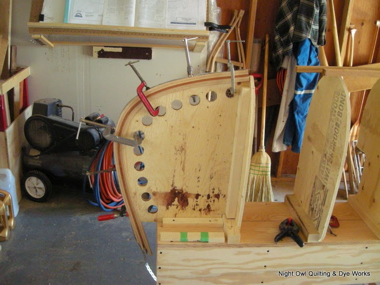

As I mentioned previously here or on Sonny’s thread, you can even use a Maslow to cut forms for steam bent/bent lamination parts. For example, the stem of many boats is bent around a form while the glue cures. Even cedar strip canoes are built this way, so the applications are endless.

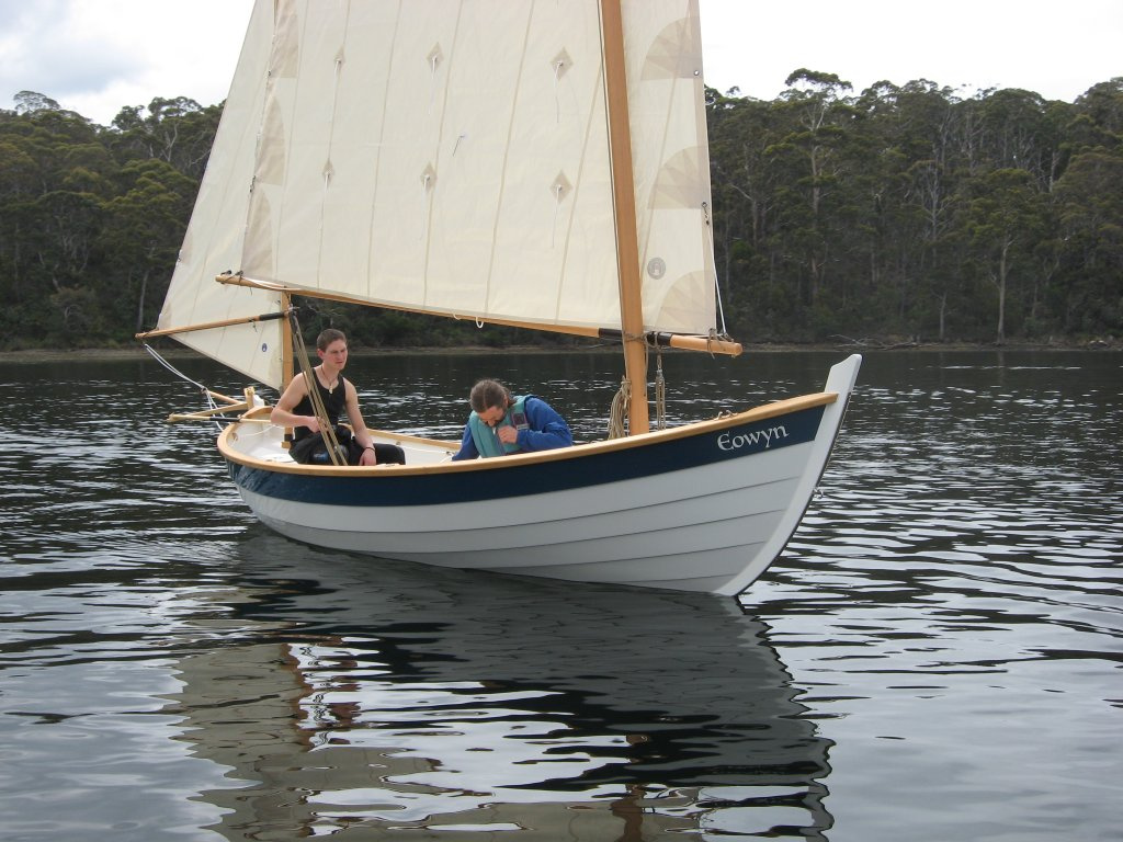

The last of the top 3 entries in this category for me is Ian Oughtred’s Caledonia Yawl. It’s literally a remaster of a classic design that has proved its seaworthiness over the last couple hundred years. The yawl sail plan is very flexible and can be very effective in both light and heavy air.
 ![image](https://canada1.discourse-cdn.com/flex031/uploads/maslowcnc/original/2X/0/0f36b0b2c0a7b04864ea67c80a996cf6b7a63760.jpg) (Oughtred’s Caledonia Yawl)
These boats are all doable by garage builders. Yes, the build times for these boats are in the several hundreds of hours (I’m already over 200 hours on my Passagemaker build) and will probably take a couple of years to build, but in the end, you have an indescribably beautiful boat that is also extremely functional by some of our generation’s best designers. While I certainly can’t recommend these for first-time boat builders (unless you’re already an accomplished woodworker), you could certainly tackle one of these after having successfully built one of the more standard stitch & glue designs.

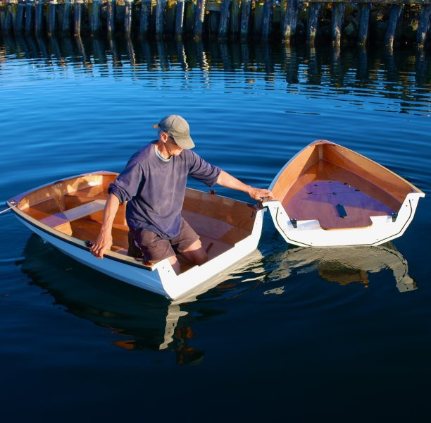

![image](https://canada1.discourse-cdn.com/flex031/uploads/maslowcnc/original/2X/0/09a1b0cb75e2aba4558d33e0133cd0c3de37fd57.jpeg)
PT Eleven (not available as plans)
This will probably be my last entry on this topic of this type. I’m starting to run out of ideas, but here goes. There are many sailing YouTube channels out there and on a couple they’re talking about nesting dinghies. The ability to disassemble your dinghy into two parts is very convenient if you have limited space with your vehicle or on the foredeck of your sailboat. However, there are a bunch of trade-offs to be able to break your boat down into two parts that fit together. That completely dictates about half of the design. When you add built-in flotation, it gets even more narrow.

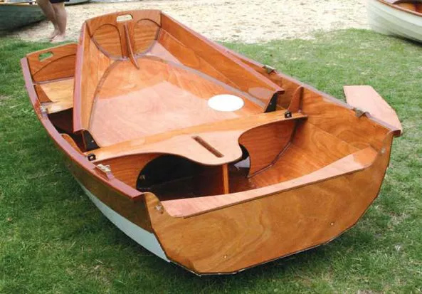

![image](https://canada1.discourse-cdn.com/flex031/uploads/maslowcnc/original/2X/b/bcd697f68eaf1ac989abf7dce97fca181cf70080.jpeg)
Spindrift Dinghy
The [Spindrift](http://bandbyachtdesigns.com/spindrift/) is an interesting design that is available as plans, which can be converted to cut files. It has some design features that make it look similar to the [PT Eleven dinghy](http://www.ptwatercraft.com/ptwatercraft/PT11Home.html), which is highly praised (but only available as a kit).
The common thread among nesting/take apart dinghies is that at some point during the boat build, you have to cut the boat in half. This is so the boat has nice, fair lines at the joint. If you built the boat in two halves, you’d have an ugly kink at the joint. This boat builder gave serious thought to the take apart option, but in the end opted out, partially due to the design differences necessary to make it a take-apart, but also partially due to the anxiety the cutting step would induce. I’ll see if I regret that decision while I’m wrestling with a one piece 12’ long dinghy that weighs 100 pounds.

You shocked me hard for a second with the first picture. I was relieved when I did not see the second part of the legs in the front of the boat and knew it was not a swordfish accident.
