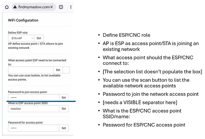

On the user interface, a few ideas:
Change the access point and password descriptions to something that make -sense-. They are totally cryptic right now!
Add some checks before the “calibrate” button actually works. Right now if you don’t do the whole dance (retract, extend, tension) you are going to get into stuck Maslow mode… and no way to stop things.
Would it be possible/valuable to put a little box at the top of the button panel for setup that shows the current state of the machine? IE: retract, extend, tension, release, etc.
what do you suggest?
very good idea
> A button that gives you a “stop whatever the heck you are doing ESP32” function feels useful. It may just be my newbieness talking 😉
it’s being worked on

I will need to take a bunch of screen shots to support this…
Here’s the one I actually have with annotation! This is SUPER confusing and has terrible english.
BTW, a different bar or double bar where I added the blue line would help clarify that the upper stuff and lower stuff are -different- things.

While getting up and running yesterday, I took a bunch of screenshots. It really looks like the wifi menu is the most confusing one!
 ![image](https://canada1.discourse-cdn.com/flex031/uploads/maslowcnc/original/3X/c/9/c9248747c8f1fad7a75bbc93f150e6ad15f9a6a6.png)
 ![image](https://canada1.discourse-cdn.com/flex031/uploads/maslowcnc/original/3X/9/9/99a69bafa5e23d083b5f0f11fd0dc9f655f26e5a.png)
