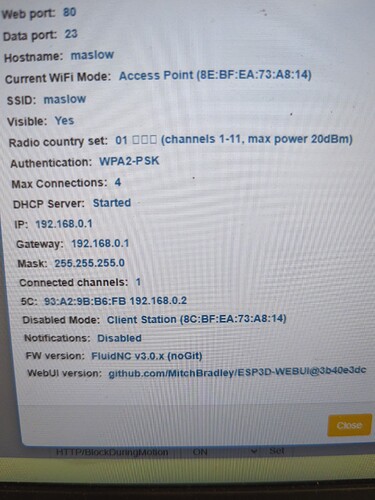

I’ve been calibrating for 24 hours.
I’ve been using this standard settings of 7x7 etc.
My laptop is definitely a bit older but it has passed calibration before.
Anyone have any tips or information on how to get through calibration a little more successfully. Is there any way to tell whether or not the fitness will be too low early on before waiting for the whole thing to end?
Also my FW version is v3.o.x (noGit)
I have uploaded the latest 1.06 firmware though…
I had left out one digit on the frame size so I imagine That’s what kept me calibrating forever.

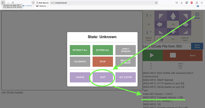

I don’t see anywhere that lets me know my current firmware version. When the machine starts up it prints out. The index version but not the firmware.
Is there a place where I can check my firmware version?
The Setup → Test button will print out this information for you:
