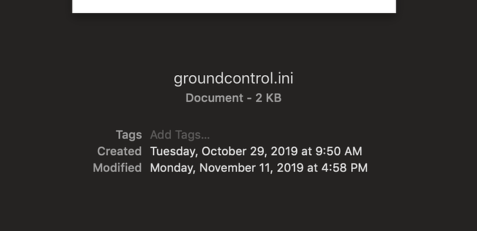

Can you post both a picture of your frame as well as the contents of your groundcontrol.ini file.
**Author:** ![Flaming\_WoodWorks](https://yyz1.discourse-cdn.com/flex031/user_avatar/forums.maslowcnc.com/flaming_woodworks/32/14818_2.png) [@Flaming\_WoodWorks](https://forums.maslowcnc.com/u/Flaming_WoodWorks)\
**Post date:** [November 14, 2019, 9:22pm UTC](https://forums.maslowcnc.com/t/calibration-problem-skewed-cuts/11607/25 "2019-11-14T21:22:10Z")
How do I get a picture of the contents of the groundcontrol.ini file?
**Author:** ![buhlig](https://yyz1.discourse-cdn.com/flex031/user_avatar/forums.maslowcnc.com/buhlig/32/14574_2.png) [@buhlig](https://forums.maslowcnc.com/u/buhlig)\
**Post date:** [November 14, 2019, 9:52pm UTC](https://forums.maslowcnc.com/t/calibration-problem-skewed-cuts/11607/26 "2019-11-14T21:52:18Z")
by doing a screenshot?
**Post date:** [November 14, 2019, 9:56pm UTC](https://forums.maslowcnc.com/t/calibration-problem-skewed-cuts/11607/27 "2019-11-14T21:56:48Z")
![GroundControlIni](https://canada1.discourse-cdn.com/flex031/uploads/maslowcnc/original/2X/8/87e87e4a779cbae133422ad7b674242bb8ea8d82.png)
This doesn’t have “contents” … but here is the screenshot.
**Post date:** [November 14, 2019, 10:12pm UTC](https://forums.maslowcnc.com/t/calibration-problem-skewed-cuts/11607/28 "2019-11-14T22:12:45Z")
Dear, you have to open the file with a text editor first, then do the screenshot … but this might require 2-3 screenshots as the file is longer than the screen …
Just open the file with a Texteditor, mark all, copy to clipboard and paste into a reply
