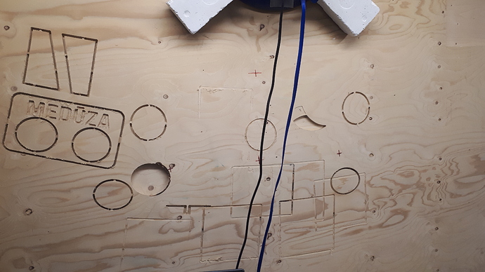

Hi my maslow works fine, but i hawe some problem maybe with calibration i think. It cut circle. But the center is circle but other plale is not circle. What can i do?
 ![20201006_195727](https://canada1.discourse-cdn.com/flex031/uploads/maslowcnc/original/3X/6/5/659c2e6c4da96cac8b4b37e2e0a6ade121e13114.jpeg)

**Post date:** [October 8, 2020, 5:58pm UTC](https://forums.maslowcnc.com/t/calibration-quastion/14864/4 "2020-10-08T17:58:09Z")
A common issue with due users and early makerverse versions is the machine home location at the absolute center of the work piece and not changing that when setting the work home/zero that positions the cut location origin. When you move the sled to set the work origin, did you rehome the sled or did you just zero the work x and work y axes?

**Post date:** [October 10, 2020, 6:32pm UTC](https://forums.maslowcnc.com/t/calibration-quastion/14864/10 "2020-10-10T18:32:47Z")
machine home does not equal cutting position home. In the early makerverse versions, it is really easy to move the sled and destroy your calibration by pressing the home button, when you really just want to zero the x and Y work axes
 ![image](https://canada1.discourse-cdn.com/flex031/uploads/maslowcnc/original/3X/c/0/c05402bf021b1c891b39936c25f32c4394e223d2.png)
set home. Move the sled to where the origin of your cut is, then press the circled buttons to zero the work position x and work position Y setpoints. Then try your cut.

**Post date:** [October 11, 2020, 11:55am UTC](https://forums.maslowcnc.com/t/calibration-quastion/14864/18 "2020-10-11T11:55:14Z")
you need the newer version of makerverse. Make sure you select Maslow when you set up your machine.
 ![image](https://canada1.discourse-cdn.com/flex031/uploads/maslowcnc/original/3X/1/d/1d1e5243a37b540ddbeba24cedc188e84ee99584.png)
It needs to look like this:
 ![image](https://canada1.discourse-cdn.com/flex031/uploads/maslowcnc/original/3X/b/8/b8386f4e045913aa6665f1222094e326d6e5cb1d.png)
click on the calibration bullseye and follow the instructions and that should fix your size issues
