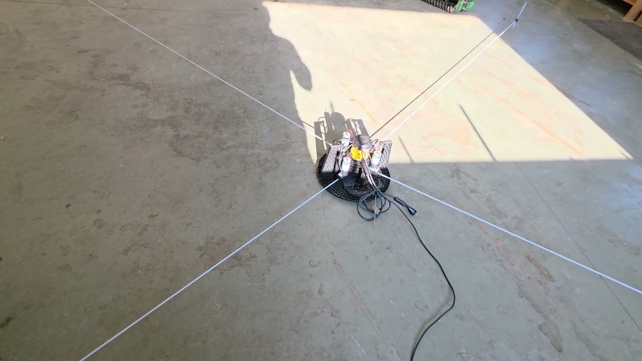

Hi everyone.
I’m hoping for some help. I’m running 4.1 and just updated to the latest firmware (1.23 I believe)
I just got fresh spools and belts installed, because I snapped my last belt trying to calibrate.
I just got it re-assembled today, and retraction was a breeze at 700 force. The spools move so much more freely with the new spools.
I still can’t calibrate though, I’m experiencing lifting and super tight belts in the lower left corner during calibration. It gets so tight that I can hear it struggling when it’s in the lower left during calibration… It starts lifting and and tightening, so I pulled the plug as I didn’t want to snap new belts or hurt my new spools.
My setup is concrete floor anchors with 5/8 bolts. Very little flex. I have the belts parallel to the floor , each anchor has a spacer so that it’s the correct height to the arm/spool. Thus, I have the z offset values all at 0. (Am I wrong here, and could this be causing my over tightening?)
I have me belt end set as 40mm as I had to 3d print larger ones to fit my 5/8 anchors.
Other than that, I’ve set my work peice to 1200 by 2400
My anchors are approximately, 4375mm × 3772mm
Can some one help me find the light? 🕯 Lol

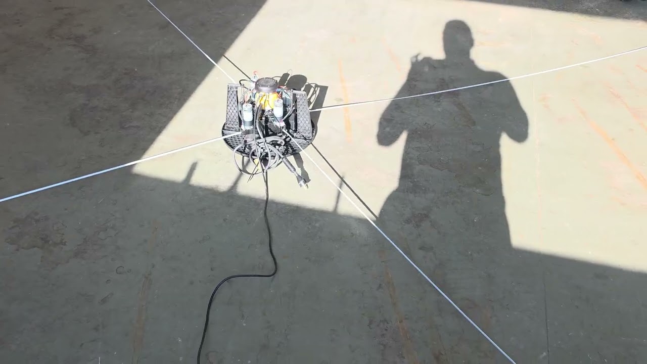

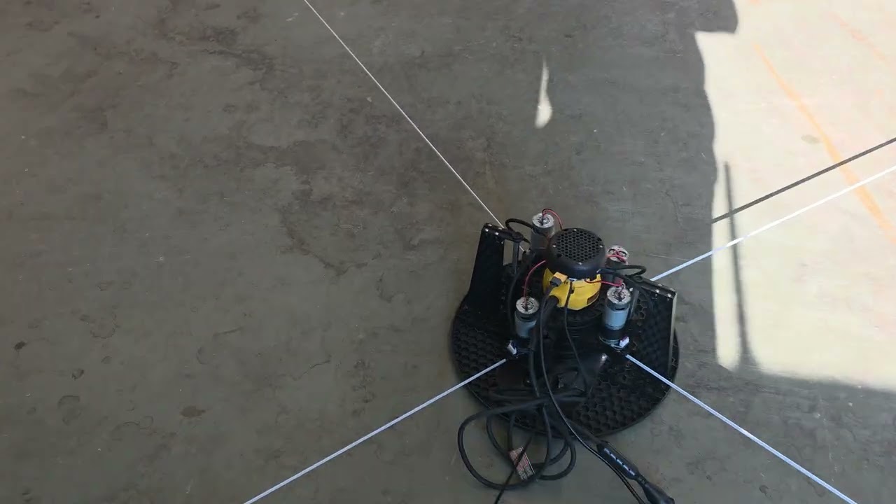

I filmed some videos of it. It’s repeatable Everytime., struggles a bit in the 2nd calibration lap, and the 3rd it really struggles on bottom left corner.
[![](https://img.youtube.com/vi/OeGEZMH4q88/maxresdefault.jpg "Failed Calibration 1") ](https://www.youtube.com/watch?v=OeGEZMH4q88)
[![](https://img.youtube.com/vi/iu-7AzF3__M/maxresdefault.jpg "Failed Calibration 2") ](https://www.youtube.com/watch?v=iu-7AzF3__M)
[![](https://img.youtube.com/vi/RWgze1OvZEQ/maxresdefault.jpg "Failed Calibration 3") ](https://www.youtube.com/watch?v=RWgze1OvZEQ)
