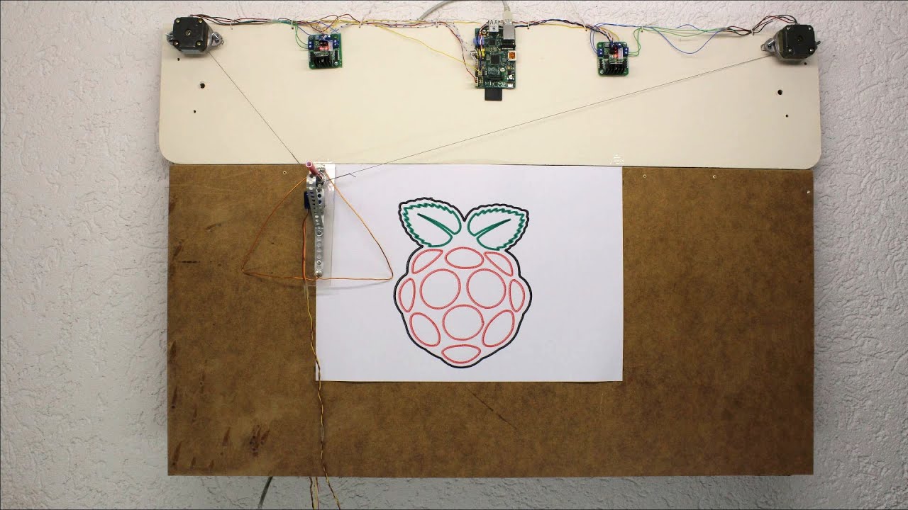

Take a look at this cool video describing a hanging plotter build project (Maslow concept) and discussing sources of innaccuracy (including drum diameter change with cable winding)
Discussion of accuracy starts around 6:00 minute mark if you don’t want to watch the whole thing.

Also, with the sprocket/chain design the stretch of the used length of chain is possible to calculate because we can easily calculate the used length of chain. The rest of the chain doesn’t come into play.
With a cable/drum setup, the full length of the cable is always subject to tension because it’s effectively a rope tied at one end and being pulled. The problem is, stretch would be very difficult to calculate. Yes, you know the length of cable being stretched (namely the full length all the time) but as the cable winds on the drum, the friction forces between increasing amounts of cable and the drum opposing that stretch (and hence affecting the true position if the sled) are very difficult to estimate.
In the end, if you’re not looking for a high level of position precision then all this doesn’t matter, and we could use chain, cable, rope, cotton thread or elastic bands even, depending on what level of accuracy we’re looking for.
