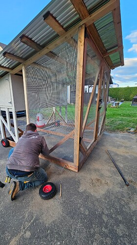

Here are a few in-progress pics of the coop I built last fall. I don’t have pics of the 100% finished product but this should give you an idea.
It’s 8x8 feet total, but with a divider in the middle so it’s basically 2 4’x8’ coops.
The “indoor” space is about 2 ft wide, so each side has about 8 square feet of indoor space. It has full-width openings along the back for easy cleaning, and smaller openings on the sides for egg collection.
The “outdoor” space is accessed through 2 full-width doors on the front.
I’ve added a few electrical boxes to plug in lamps & heaters during the winter. They all feed to a single plug so I only have to run one extension cord to the coop.
This is the second version of a coop I built ~10 years ago that my wife liked a lot, so I made a few upgrades to make the build process easier & cheaper, as well as some other quality-of-life improvements (like the wheels).
Hard to say the total cost, as it was mostly built from leftovers I had laying around. Only the roof, wire mesh and various bits of hardware were specifically bought for this project.
No CNC involved here, though…
