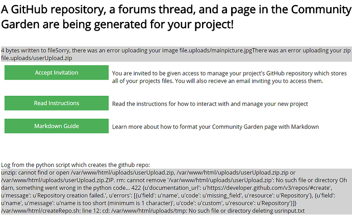

> Archive: /var/www/html/uploads/userUpload.zip inflating: /var/www/html/uploads/Lift-desk0-2-b.jpg inflating: /var/www/html/uploads/lift-desk2.0final.dxf inflating: /var/www/html/uploads/liftdesk.stl Adding GitHub User: GeroBH GIT URL:\> [https://github.com/MaslowCommunityGarden/Lift-Desk-Light---Project-upload-Test](https://github.com/MaslowCommunityGarden/Lift-Desk-Light---Project-upload-Test) \<— Congratulations! Your project is has been created and will appear soon
is what I get.
The error from @geeklimit is
> unzip: cannot find or open /var/www/html/uploads/userUpload.zip, /var/www/html/uploads/userUpload.zip.zip or /var/www/html/uploads/userUpload.zip.ZIP. rm: cannot remove ‘/var/www/html/uploads/userUpload.zip’: No such file or directory Oh darn, something went wrong in the python code… 422 {u’documentation\_url’: u’[Repositories - GitHub Docs](https://developer.github.com/v3/repos/#create%E2%80%99), u’message’: u’Repository creation failed.’, u’errors’: [{u’field’: u’name’, u’code’: u’missing\_field’, u’resource’: u’Repository’}, {u’field’: u’name’, u’message’: u’name is too short (minimum is 1 character)’, u’code’: u’custom’, u’resource’: u’Repository’}]} /var/www/html/createRepo.sh: line 12: cd: /var/www/html/uploads/tmp: No such file or directory deleting usrinput.txt”

**Author:** ![geeklimit](https://yyz1.discourse-cdn.com/flex031/user_avatar/forums.maslowcnc.com/geeklimit/32/5967_2.png) [@geeklimit](https://forums.maslowcnc.com/u/geeklimit)\
**Post date:** [June 26, 2018, 8:37pm UTC](https://forums.maslowcnc.com/t/com-garden-upload-error-with-zip-solved/4530/14 "2018-06-26T20:37:49Z")

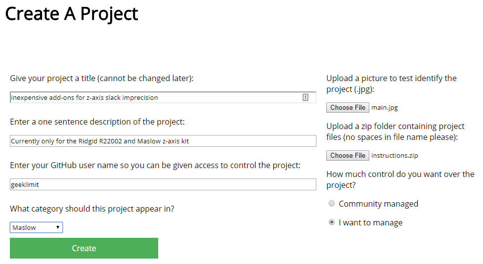

OK. just tried again. It seems like it uploads, then fails. For troubleshooting:
 ![13%20crop](https://canada1.discourse-cdn.com/flex031/uploads/maslowcnc/original/2X/2/23c22ad42cd309a3fe45dbdc40dd6df7a52a7833.jpg)
What was submitted:
 ![image](https://canada1.discourse-cdn.com/flex031/uploads/maslowcnc/original/2X/6/634f5de693ea39ee3a4c21eca2c4c8f7a7ce663f.png)
What it shows after it’s done uploading:
 ![image](https://canada1.discourse-cdn.com/flex031/uploads/maslowcnc/original/2X/8/86ffe4989d3603b59cb854913cb8e263551f9f87.png)
On Windows 10, using Chrome Version 66.0.3359.181 (Official Build) (64-bit)
**Post date:** [June 26, 2018, 8:38pm UTC](https://forums.maslowcnc.com/t/com-garden-upload-error-with-zip-solved/4530/15 "2018-06-26T20:38:45Z")
It looks like I’m allowed to upload here in the forums, but it doesn’t like the zip file.
“Sorry, that file is too big (maximum size is 3072kb)”
I don’t really have files for this project, so it’s a .zip of pictures 10x bigger than that limit

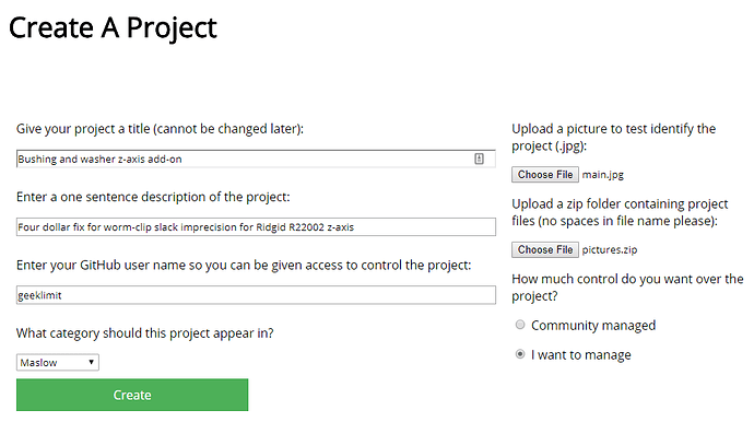

OK. New test, I’m guessing zip size.
 ![image](https://canada1.discourse-cdn.com/flex031/uploads/maslowcnc/original/2X/c/c3fbe96ba0f4874f84ddb83ef6283ceddfe363da.png)
 ![image](https://canada1.discourse-cdn.com/flex031/uploads/maslowcnc/original/2X/e/e7f9b2bcab4caa73d78df9f45e4d2728039707ca.png)

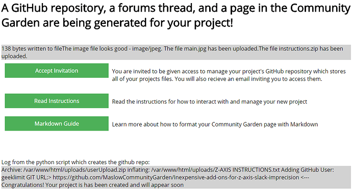

I copy-pasted the instructions test from my thread into a .txt file, and made a .zip out of that. Works fine.
 ![image](https://canada1.discourse-cdn.com/flex031/uploads/maslowcnc/original/2X/4/4a68c0bd78994a6f8ba9c994bae73b82847da3b6.png)
 ![image](https://canada1.discourse-cdn.com/flex031/uploads/maslowcnc/original/2X/b/be1fb78e11aac520d6e880dce21240885e1b43ad.png)

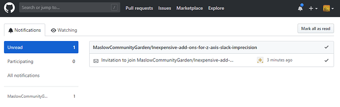

email invite received from github 2x:
 ![image](https://canada1.discourse-cdn.com/flex031/uploads/maslowcnc/original/2X/3/3ba8d4094aa0f31edd7912a59798569f5e146083.png)
and in github, OK:
 ![image](https://canada1.discourse-cdn.com/flex031/uploads/maslowcnc/original/2X/b/b0b662726c29678a22d8a2c35bdd7d2d8dcd7903.png)
