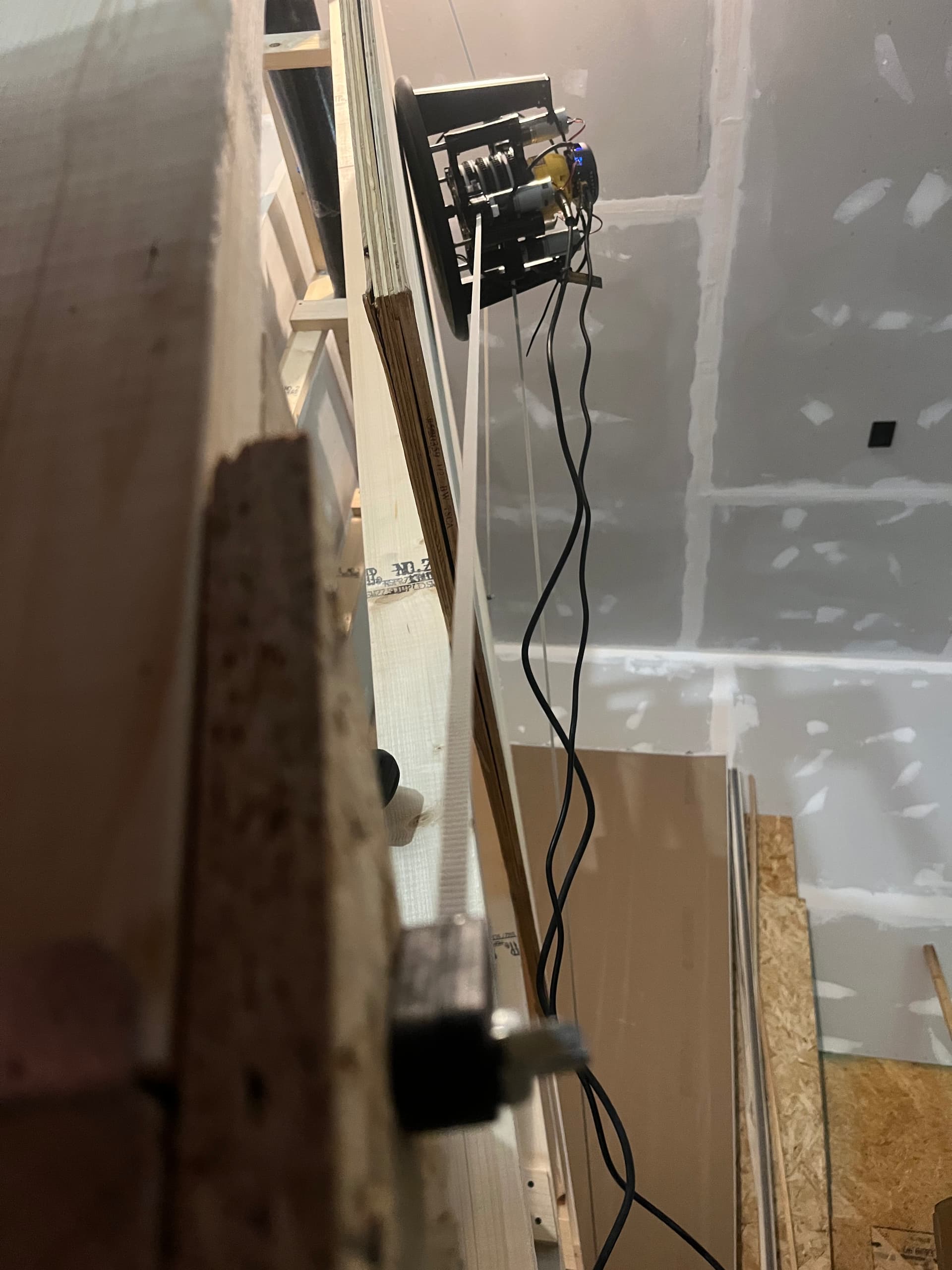

![IMG_5314](https://canada1.discourse-cdn.com/flex031/uploads/maslowcnc/original/3X/2/5/251dde7a203d663f886e99a0f55e26a93006cb49.jpeg)
**Post date:** [June 10, 2025, 10:43pm UTC](https://forums.maslowcnc.com/t/completed-calibration-but-something-is-off/24334/22 "2025-06-10T22:43:54Z")
What angle is the frame at, David’s advice
> [@dlang](#):
> if the sled still tips, tilt the frame back some more.
> David Lang
**Author:** ![themanro](https://yyz1.discourse-cdn.com/flex031/user_avatar/forums.maslowcnc.com/themanro/32/28229_2.png) [@themanro](https://forums.maslowcnc.com/u/themanro)\
**Post date:** [June 10, 2025, 10:49pm UTC](https://forums.maslowcnc.com/t/completed-calibration-but-something-is-off/24334/23 "2025-06-10T22:49:35Z")
![image](https://canada1.discourse-cdn.com/flex031/uploads/maslowcnc/original/3X/1/6/16645ff8837114ef20cdb46225dedfc6535bbba6.jpeg)
Pretty standard. It seems like there is issue with bottom belts being too tight, but I’m not sure what to look for. It performs ok in the middle of the sheet.
**Post date:** [June 10, 2025, 10:53pm UTC](https://forums.maslowcnc.com/t/completed-calibration-but-something-is-off/24334/24 "2025-06-10T22:53:10Z")
Only other thing I noticed, when I press release tension, nothing happens, it makes a slight noise but tension is still there. If I press it again, then at releases it, but then you have to go through retract/extend procedure.

**Post date:** [June 11, 2025, 6:11pm UTC](https://forums.maslowcnc.com/t/completed-calibration-but-something-is-off/24334/31 "2025-06-11T18:11:07Z")
Hmmm…Can you try running the calibration process with a lower calibration force?
 ![image](https://canada1.discourse-cdn.com/flex031/uploads/maslowcnc/original/3X/2/4/2480d39a8e68c536b8b5ed44ebc7659513b24dfa.png)
That should reduce the tension in the belts
**Post date:** [June 11, 2025, 6:49pm UTC](https://forums.maslowcnc.com/t/completed-calibration-but-something-is-off/24334/32 "2025-06-11T18:49:52Z")
Roman Rusinov wrote:
> @bar any other thoughts on why this could be happening?
you could just be having the sled not sliding cleanly. waxing the bottom of the
sled or putting slippery tape on the bottom of the sled can help
some people have found that the 15 degree angle that’s listed in the
instructions isn’t enough and that they got better results tilting to 20-25
degrees.
**Post date:** [June 11, 2025, 8:09pm UTC](https://forums.maslowcnc.com/t/completed-calibration-but-something-is-off/24334/34 "2025-06-11T20:09:19Z")
UPD: We are cutting!
I removed the wing nuts from the bolts where belt anchors go, so they can pivot. That alone improved a lot of things. Calibration ran without hiccups.
Sled still lift ever so slightly in places, but one I get vacuum hooked up it should be enough weight to keep it down.
There is some stutter here and there, so I’m going to try adding some wax to the bottom of the sled.
Accuracy is pretty good, however I had a 5mm deviation on one of the corners of the bottom shelf piece. Not sure what caused that. I think that was near the corner of plywood sheet. So maybe I need to calibrate using even larger perimeter (I did 2000x1000).
There was a hiccup with the travel passes, where bit was suppose to be above the surface, but didn’t. That might be those settings in fusion that I didn’t get right.
Overall, not too terrible for a first cut.
