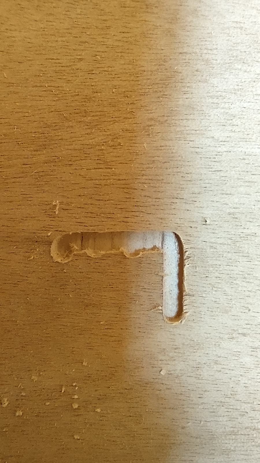

**Author:** ![HobbyBody](https://yyz1.discourse-cdn.com/flex031/user_avatar/forums.maslowcnc.com/hobbybody/32/22894_2.png) [@HobbyBody](https://forums.maslowcnc.com/u/HobbyBody)\
**Post date:** [August 16, 2024, 9:30pm UTC](https://forums.maslowcnc.com/t/consistency-with-cuts/21014/47 "2024-08-16T21:30:47Z")
So I’m guessing I change the “/Maslow\_brZ”??
Tightening that down a tad should push the cutter in and up to get rid of that bottom right imperfection??
How much adjustment are we talking here and in what direction is tighter?
 ![17238437711397303621151430538177](https://canada1.discourse-cdn.com/flex031/uploads/maslowcnc/original/3X/b/4/b427096c59a28f28546af54c03f0c034c6aafa01.jpeg)
**Post date:** [August 16, 2024, 9:48pm UTC](https://forums.maslowcnc.com/t/consistency-with-cuts/21014/48 "2024-08-16T21:48:35Z")
you don’t adjust the Z to tighten belts, you adjust the Z if the height between
where the belt is anchored and the arm doesn’t match what you have configured.

**Post date:** [August 16, 2024, 11:16pm UTC](https://forums.maslowcnc.com/t/consistency-with-cuts/21014/49 "2024-08-16T23:16:11Z")
Oh gotcha.
Tested on the spoil board (flat) and with a raised 3/4inch work piece. That didn’t seem. To change the behavior. Still getting those little tear drops as the cutter goes in. Tested a few feet left of center, center, and a few feet right. Got slightly different results.
Didn’t provide new theories. Any ideas?
Pictures are left to right.
 ![IMG_20240816_153123158](https://canada1.discourse-cdn.com/flex031/uploads/maslowcnc/original/3X/3/a/3a71720358bf3558fe244b92e539f62aab6e3bbf.jpeg)
 ![IMG_20240816_153128743](https://canada1.discourse-cdn.com/flex031/uploads/maslowcnc/original/3X/d/1/d1b3b140321a1a6c9b83d0ba0c1491edc7104acd.jpeg)
 ![IMG_20240816_153134437](https://canada1.discourse-cdn.com/flex031/uploads/maslowcnc/original/3X/8/4/849069b7689df4290be2dc0242cf715e81ae1102.jpeg)
**Post date:** [August 16, 2024, 11:36pm UTC](https://forums.maslowcnc.com/t/consistency-with-cuts/21014/50 "2024-08-16T23:36:15Z")
can you make a video of this so we can see exactly what’s happening? If your phone/camera supports doing slow-motion video, that would be good.
a picture of the bottom of the bit would be good (is it designed to be able to plunge or not)
re: Z offsets, you would want to make sure they are correct for calibration and for your cutting, but you need to make all 4 (one for each arm) correct.
It may make sense for you to manually measure where the anchor points are (all 6 possible measurements) and then put them into the onshape manual calibration doc I created to see how they compare to the calculated numbers.
once you have the anchor locations defined correctly, you should not have to re-do calibration unless the frame changes

@dlang I finally was able to get back to projects and made a video. I am running .84 version and the issue i had before seems more pronounced.
The issue is when doing any x/y/z jogging i get this little lift and let down in the video. So this really has nothing to do with onshape or cad software conversion etc. I couldn’t figure out the slow-mo but i think you can see it clearly here as i job the machine. Note this occurs right after I calibrated it and calibration was ‘accurate’.
Keep an eye on the sled and it you will see it pop up at the beginging and down at the end of the jog command (first is a straight move right; second a z command up).
**Post date:** [October 4, 2024, 8:48pm UTC](https://forums.maslowcnc.com/t/consistency-with-cuts/21014/59 "2024-10-04T20:48:14Z")
This is caused by the belts being extra tight and the system relaxing when the servos power down. It shouldn’t happen during a cut because the servos are powered up the whole time.
