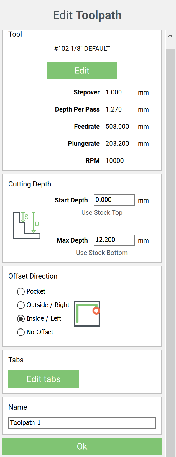

1. click toolpath button for each tool path
- click drawing components and select
 ![image](https://canada1.discourse-cdn.com/flex031/uploads/maslowcnc/original/3X/5/c/5c4f8b23eae92e7f679afa9cb44c812f7389c461.png)
- click edit if the bit feedrates need to change (go back to show tool database and change so each path need not be edited)
- 2.5 mm depth is ok but may make some fuzzies on the first pass
- feedrate of 550 mmpm
- plunge rate of 800 mmpm
- max depth of 14
- cut location on outside for the outer edge
- click edit tabs for the outline because this will go all the way through. Put 4 tabs at about evenly spaced locations around the perimeter by clicking
\*\* tab length 10 mm
\*\* tab height 3 mm
 ![image](https://canada1.discourse-cdn.com/flex031/uploads/maslowcnc/original/3X/a/4/a4e0a7c86f5f3fd41fb3fb50993543d0c96249b2.png)
\*\* click ok

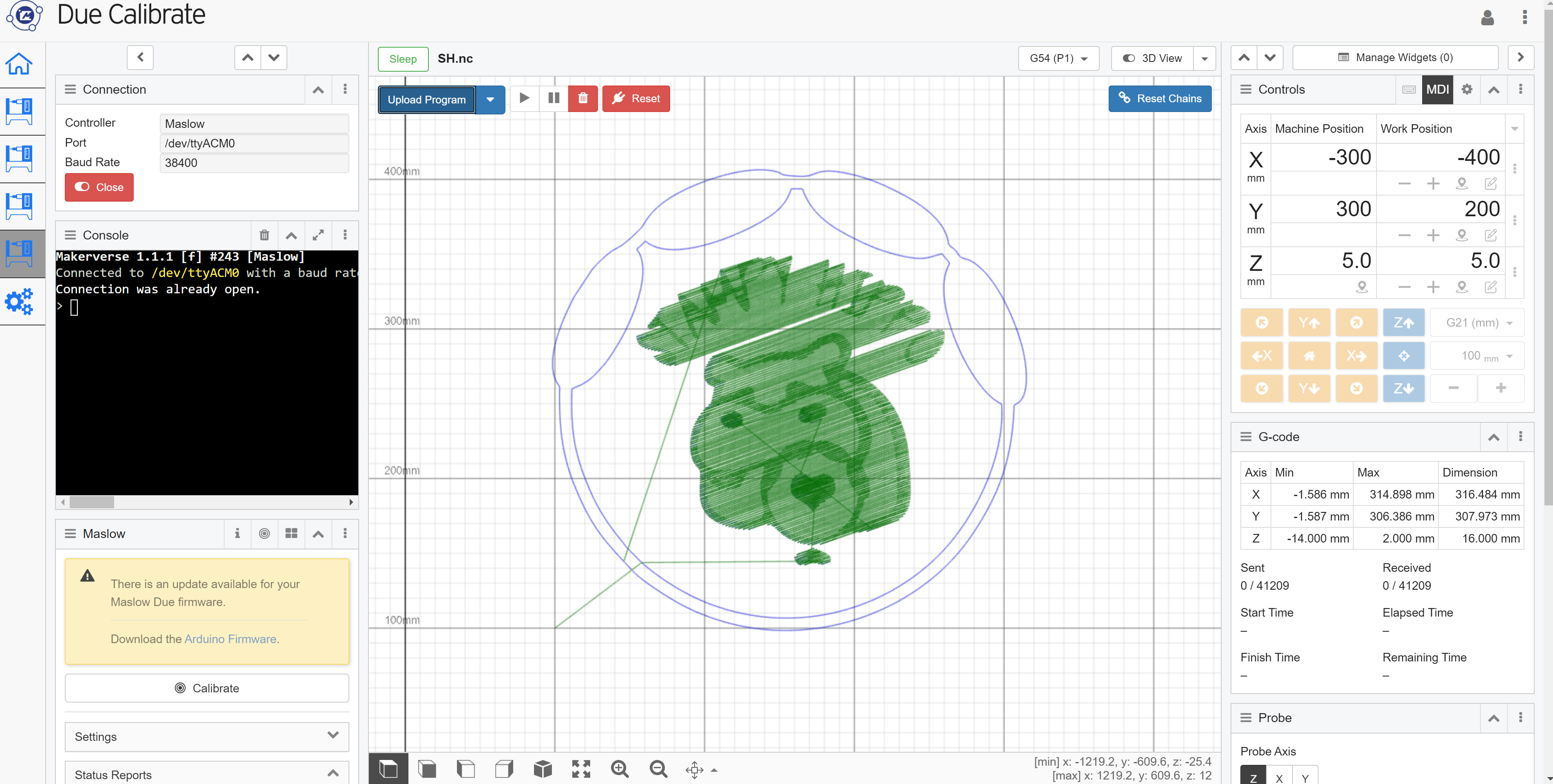

Webcontrol:
 ![image](https://canada1.discourse-cdn.com/flex031/uploads/maslowcnc/original/3X/9/0/90038ee13908ea2a4a0f4302cc13333d0164b998.png)
Makerverse:
 ![image](https://canada1.discourse-cdn.com/flex031/uploads/maslowcnc/original/3X/8/0/80f00aa7266b2f4469ca6004412a667ad574b411.jpeg)
