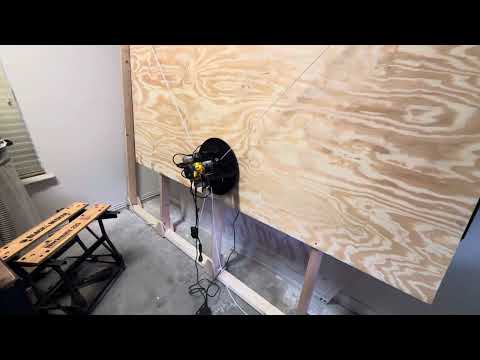

I’ve been working through setup this morning. I got to the spot where I press calibrate and the sled starting going down and went off of the spoil board. I was able to stop it, but I’m not sure where I went wrong. I followed the directions on the newest YouTube video. Any help would be much appreciated!

If your initial anchor size estimates are incorrect, this could happen.

Here are my settings and what is happening.
 ![IMG_0148](https://canada1.discourse-cdn.com/flex031/uploads/maslowcnc/original/3X/d/8/d8d00426ed872d1f0bebf0891410b9b3457129ff.png)
I’m 100% sure this is user error, but I can’t figure it out.
When I press calibrate, it does this:
[![](https://img.youtube.com/vi/LhRTykQBm5g/hqdefault.jpg "Maslow calibration issue") ](https://www.youtube.com/watch?v=LhRTykQBm5g)

**Post date:** [April 28, 2024, 2:07am UTC](https://forums.maslowcnc.com/t/could-use-some-help-with-setup-calibration/20826/11 "2024-04-28T02:07:11Z")
from what Bar has been saying, this is probably due to the estimate of the frame
size being too far from reality.

I’m using a starting value of 2250 for my vertical measurement and my sled is coming 1/3 off the top and bottom of the frame during the 9x9 at the end of calibration, which seems just about perfect.
Noticed your value is a bit bigger than that and your frame looks to be the standard height like mine. Might be worth trying that value. Same for maybe dropping the starting value for the width by 100-150.
I was getting good results using 3400 and 2250 for an 8x12 instead of the more-accurate 3530 and 2386. I had the same issue as you when I was giving accurate values, so I’m still using these values even with fw 0.70.2.

Looks like that was the issue. Calibration is proceeding as expected now after updating the frame size
**Author:** ![Jason\_Cornelius](https://yyz1.discourse-cdn.com/flex031/user_avatar/forums.maslowcnc.com/jason_cornelius/32/23628_2.png) [@Jason\_Cornelius](https://forums.maslowcnc.com/u/Jason_Cornelius)\
**Post date:** [April 29, 2024, 12:30am UTC](https://forums.maslowcnc.com/t/could-use-some-help-with-setup-calibration/20826/18 "2024-04-29T00:30:37Z")
Thank you, everyone, for your help. I deleted and reinstall software, updated the firmware and it worked like a charm! I appreciate you all and your willingness to help!
