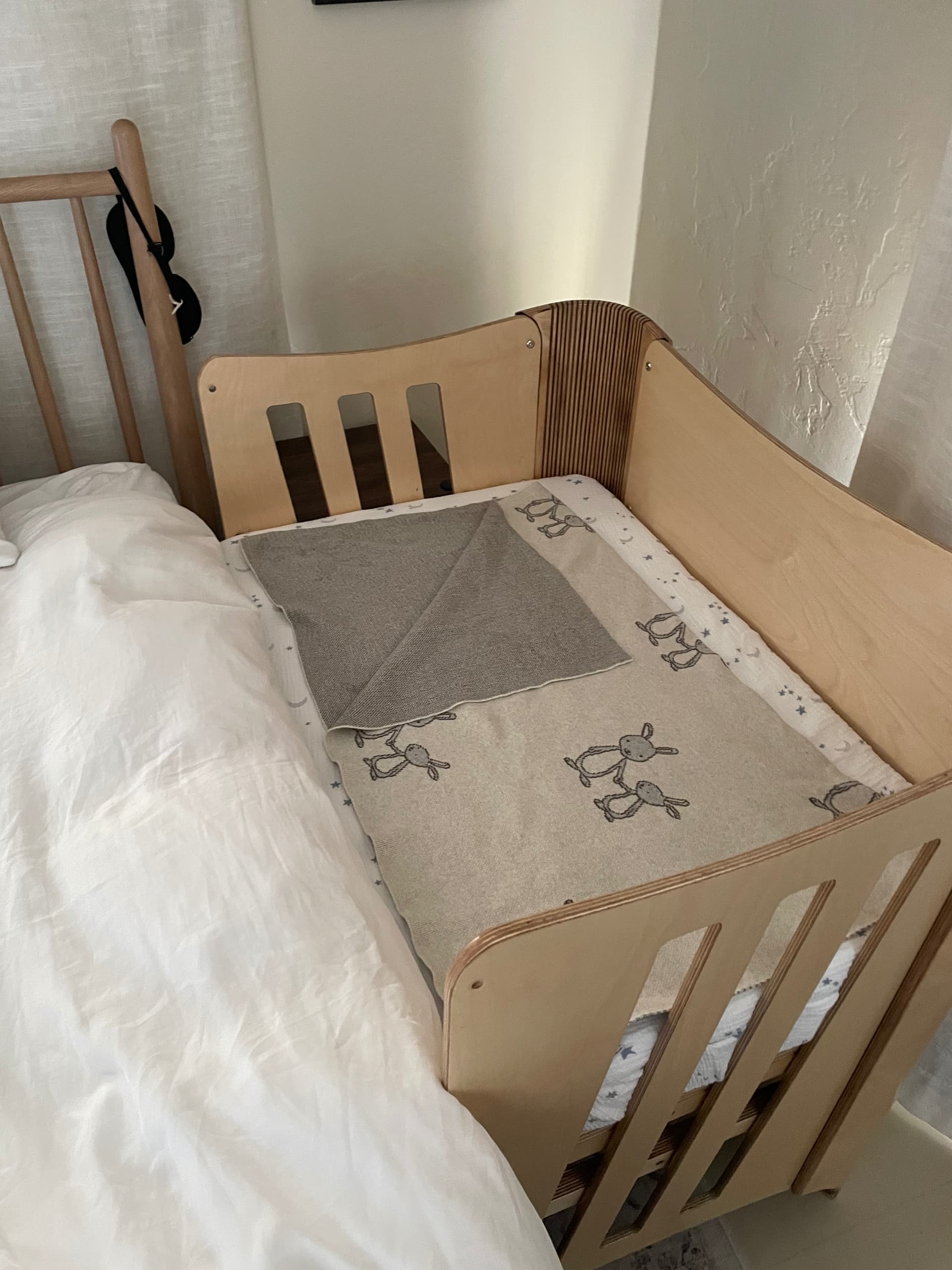

I had planned for the Maslow to do all the fabrication on this, but it absolutely choked on the kerf-cutting for the bent corners. I had to do that with a jig I made. Still, it turned out pretty well!

How did you fill in those kerf cuts? Love that look.
**Author:** ![pholtzman](https://avatars.discourse-cdn.com/v4/letter/p/3e96dc/32.png) [@pholtzman](https://forums.maslowcnc.com/u/pholtzman)\
**Post date:** [October 20, 2025, 9:54pm UTC](https://forums.maslowcnc.com/t/crib-co-sleeper-with-maslow4/25071/5 "2025-10-20T21:54:04Z")
1/8” walnut splines.
The math on smooth kerf-bending is tricky - more cuts = smoother bends but unless you want gaps with a given sweep, the required kerf thickness gets smaller than feasible.
So I decided to lean into this, using a tapered router bit and 1/8” walnut splines. Closing the taper tight to the spline gives an effective kerf of 0.06” and 22 kerfs for a smooth curve.
I wish the Maslow could have done the kerfing, but it kept tracking into neighboring kerfs, going wildly off-course and mangling the workpiece. I’m not sure why.
