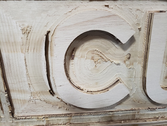

As far as I’ve gotten so far. If i cut another one, i don’t think I’ll go as deep. Takes a long time to make 3 or 4 passes around it. Lol

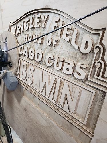

Cutting .2 at 20 speed and 60 percent of bit. Cutting clean.

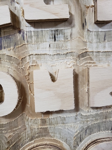

Cutting at .1 and 20 speed at 40 width of bit. Not best as clean. Both running router at max speed.

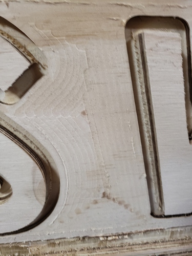

Wow. Not sure what happened here. But that pretty much ruined this sign! Ugh it’s not like that in gc. 17 hours down the tubes. 😭😭

Did it cut the back end of the C off? Could router that c flat and cut another C out of 3/8 or 1/2 plywood and glue it in?
**Author:** ![ScrumdyBum](https://yyz1.discourse-cdn.com/flex031/user_avatar/forums.maslowcnc.com/scrumdybum/32/4779_2.png) [@ScrumdyBum](https://forums.maslowcnc.com/u/ScrumdyBum)\
**Post date:** [July 22, 2018, 10:56pm UTC](https://forums.maslowcnc.com/t/cubs-and-hawks-sign/3677/36 "2018-07-22T22:56:18Z")
May need to do just a chain calibration since you lost connection at one point. Chain calibration is different then Calibration you did in the beginning.

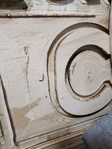

Yup sure did! Cut everything else perfect and cut that at a weird angle and didn’t cut the extra beside it.

It’s complete. It paused itself and asked me to do a tool change. It did it about half way through also. That normal?

Looks great! Unfortunate about the C but that can be fixed. If you have a 1/8 bit you could do a profile around the M to get the corners. Same thing with the connected spots in the G’s. Yeah, if you use different size bits it will pause to do a fool change.
