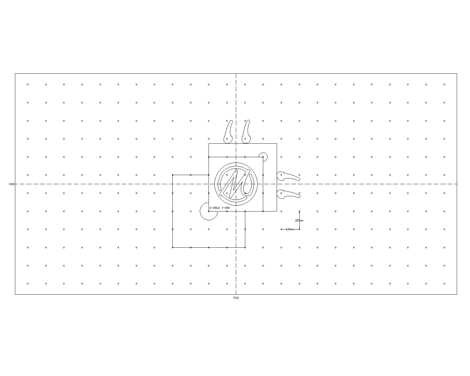

**Author:** ![rbodelon](https://yyz1.discourse-cdn.com/flex031/user_avatar/forums.maslowcnc.com/rbodelon/32/4606_2.png) [@rbodelon](https://forums.maslowcnc.com/u/rbodelon)\
**Post date:** [June 19, 2018, 6:04am UTC](https://forums.maslowcnc.com/t/currently-unrecognized-g-codes/3196/16 "2018-06-19T06:04:21Z")
Is possible to implemet those gcodes G92 to set zero x,y,z on the work piece.
Bit Diameter 0,25	Inches
Touch Plate Thickness 0,1	Inches
Z Axis G-Code G38.2 Z-.5 F1;G92 Z0,1;G0 Z0,25
X Axis G-Code G38.2 X-.5 F1;G92 X0,125
Y Axis G-Code G38.2 Y-.5 F1;G92 Y0,125
I’m very interested in G92 command because i would like to work like this:
 ![MASLOW%20LOGO-OK](https://canada1.discourse-cdn.com/flex031/uploads/maslowcnc/original/2X/b/b77b70657356d69c159da9c9dd3abcdb5e729635.jpg)
I Think is usefull to do a grid, but, because of calibration changes this grid is impossible to stay in the same place and is neccesary to use G92 to position the work piece on the grid.
Thank you.
**Post date:** [June 19, 2018, 9:56am UTC](https://forums.maslowcnc.com/t/currently-unrecognized-g-codes/3196/17 "2018-06-19T09:56:42Z")
The ‘Define Home’ button changes the location of 0,0 to the present location of the bit, and I believe that change persists even through restarts. Will that do what you need?
