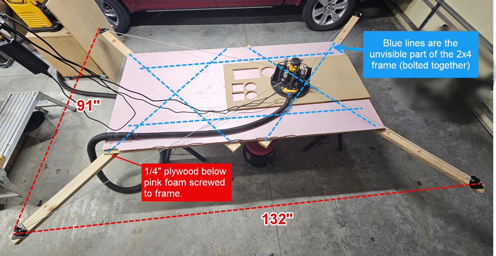

My frame is made out of 2x4" lumber bolted together with a 1/4" plywood screwed at corners. The mount pins are 91"Tall and 132"wide. Then a piece of 4’x8’ pink foam as sacrificial layer. It’s not without flex, but the flex is not in direction that the belts really pull. It’s seems quite stiff in those directions.
 ![MaslowFrameSetup](https://canada1.discourse-cdn.com/flex031/uploads/maslowcnc/original/3X/4/0/404c41c85fa0613b8f30079fd1c572a4df4e1098.jpeg)
I have calibrated three times and still not getting Round circles or Square squares.

hi,
from a quick look, your frame dimensions are quite a bit off from the 132" you are announcing.
What worked for me regarding dimensional accuracies was to measure everything by hand (even diagonals) and calculate the appropriate coordinates accordingly, with BL(0;0). If you don’t know a software to do so, you can try with chatgpt
This would be my first thought but the log seems to look OK.
`[MSG:INFO: Flex measurement: TLBR: 3.646 TRBL: 4.024]`
I do still think that could be a concern. The frame flex test is done right in the middle which like you said will be the direction the arms have the least flex.
Have you tried entering manual measurements for the anchor points locations? Some folks have reported good luck with that

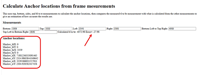

@dlang & @bar
If I understand the process for manually entering. I first need to take the measurements of the belt anchor pin points, Top, Bottom, Left, Right & Diagonals. Can you confirm that those measurements should be center to center at each anchor pin point.
Then take that info and run through that calculator in the other thread that is linked above. If that is correct, then that is what I did and got the following results. Which if I understand that error may be too high, as it should be close to zero. And if it’s too high then that means I measured or entered something wrong?
I double checked my measurements and measuring to 1/16" accuracy at this point, I get the following from the calculator.
 ![AnchorCalc](https://canada1.discourse-cdn.com/flex031/uploads/maslowcnc/original/3X/7/8/7872cfd36aac9f5c99be0927eeae01b521ba5e5b.png)
Then I should edit the maslow.yaml file and updated the Anchor Location values.
 ![yaml](https://canada1.discourse-cdn.com/flex031/uploads/maslowcnc/original/3X/d/7/d74914bf6745e444f83247d75de0d939fe967283.png)
Then I did all that and rebooted the Maslow4.1, then did a retract all, then extend all, pined the anchors, but after pressing tension id did tighted the belts, but it would not let me move the device. It said the Maslow was not ready.
If I understand the calculations, is my issue that the -27.98 error is too large? That should be closer to zero ±4ish?
they can be center-to-center, of left edge to left edge, or right edge to right
edge.
just not left edge to right edge
it’s sometimes hard to determine the center accurately, so edge to edge is
frequently easier to do.
you can even put a hex bolt in and go edge to edge of the hex bolt, just as long
as you use the same edge.
yes, this error is far too large, it should be \<1mm ideally.
this is in here to catch the situation where you mess up the measurements.
