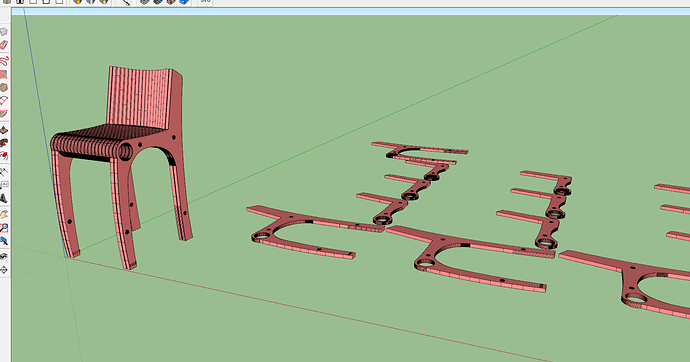

I don’t mind it except I was attempting a chair for my office desk through sketchup using a slicer plugin. This requires X and Y accuracy if you’re trying to get it all on one 4x8 sheet with 6" buffer for Maslow then some of the cuts end up with different orientations. Also the sliced pieces will need to go back together.
Also afraid I might see my error in other ways after I’m done cutting.
 ![image](https://canada1.discourse-cdn.com/flex031/uploads/maslowcnc/original/2X/c/cbfcdc4ce348a1c5b5a9b3a7896b62d6fc259056.png)
 ![image](https://canada1.discourse-cdn.com/flex031/uploads/maslowcnc/original/2X/0/018e718f23edd56187a8936e81a92d833caa378b.png)
btw: does anyone know of a program to automatically organize pieces on a 4x8 so there’s less wasted wood?
