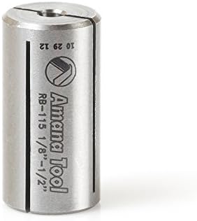

Wow! looks great for a 1/4 bit. Get on Amazon and order this.
> **[HQMaster 10PCS 1/8" 17mm Carbide Flat Nose End Mill CNC Router Bits Double Flute Upcut Spiral Set Tool Nylon Resin ABS Acrylic PVC MDF Hardwood - - Amazon.com](https://www.amazon.com/gp/product/B010NI39WO/ref=oh_aui_search_detailpage?ie=UTF8&psc=1)**
> $14.99
They are basically disposable and I get a lot of cutting time off of them. You will need a Collet to fit into the 1/2 inch router shaft. You will get more detail.
> **[Amana Tool RB-115 High Precision Steel Router Collet Reducer 1/2 Overall D x 1/8 Inner D x 1 Inch Long - - Amazon.com](https://www.amazon.com/gp/product/B00ECCQ0BU/ref=oh_aui_search_detailpage?ie=UTF8&psc=1)**
> High Precision Steel Router Collet Reducers
Thanks for the photos again!
