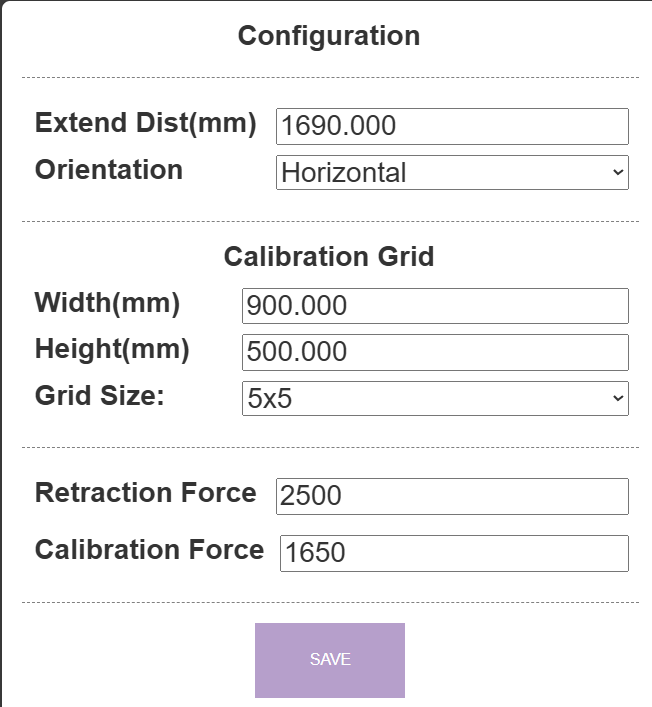

I was able to calibrate my set up with good results (the latest yaml file is attached.) I was able to make a successful small cut, then set it up for a large cut (.nc file is attached). The second cut stopped mid-way through, so I stopped it and tried to cut it again today.
I extended the belts and took up slack multiple times. Each time it ended with “Maslow is not ready to move. Could not perform Jog. Belt lengths are unknown.” So it’s impossible to move forward.
The belts don’t tighten consistently, and every time I attempt to use it another issue pops up.
So far I’ve only been able to make 1 decent cut, the rest are garbage or I can’t get the machine to work (after months of trying.) The serial files from my last 3 attempts are included. I’m not certain this thing will ever work the way it was described.

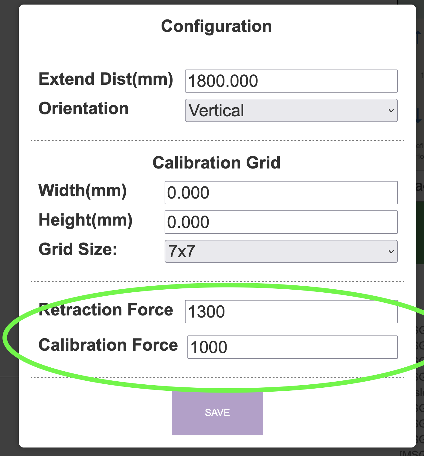

> [@JeffOko](#):
This sounds like the issue to me, what do you have for these two settings here:
 ![image](https://canada1.discourse-cdn.com/flex031/uploads/maslowcnc/original/3X/2/8/2839c334497a3579d51310311f1bde534259e9ae.png)

![image](https://canada1.discourse-cdn.com/flex031/uploads/maslowcnc/original/3X/7/6/766199ba79da29238bcb14c7808d8b13e5943083.png)

Also, note that these settings worked for me to cut on Sunday. It didn’t work today while I changed nothing. The retraction force was changed from 2200 to 2500 during my last attempt. That is what is so aggravating - I set it up the same way on two days - one day it works, the other it doesn’t…
**Post date:** [November 18, 2025, 8:37pm UTC](https://forums.maslowcnc.com/t/different-day-more-problems/25213/6 "2025-11-18T20:37:11Z")
> [@JeffOko](#):
> 2500
This is really really high which makes me think that something is preventing the spools from spinning freely. Are you seeing that all four need that high of a number to retract, or is there one in particular that seems to be binding up?

**Post date:** [November 18, 2025, 8:43pm UTC](https://forums.maslowcnc.com/t/different-day-more-problems/25213/8 "2025-11-18T20:43:41Z")
That Retraction force is really high, what is the lowest force you can get the belts to reliably retract? Do all the belts need that much force to retract?
I sanded, polished and lubricated the arm part the spools rotate on and could still pull the belts in reliably at 900. I realise it a pain to pull the Maslow apart, but it may be the next step for you. If some of the belts retract at a lower value you may not need to touch those. Also I found that setting the two force values to the same was more reliable.

I used fine grain sandpaper on the hubs, I didn’t want to sand the spools in case I needed to replace them later. I used a mixture of graphite and petroleum grease to lubricate them. It was pointed out to me that some plastics react badly with grease, so do your research on what lubricants are recommended.
I suggest before pulling the Maslow apart again, you identify which arms require more force. To do that try lowering the retract value and do extend, retracts until belts fail to retract. Make a note at which value each belt requires to retract. The lower you can get these values the more accurate the Maslow appears to be.
Several people have made tools and techniques to help with this, look for sandpaper in the Search
I also recommend replacing the screws which hold the arms together with a slightly longer screw.
