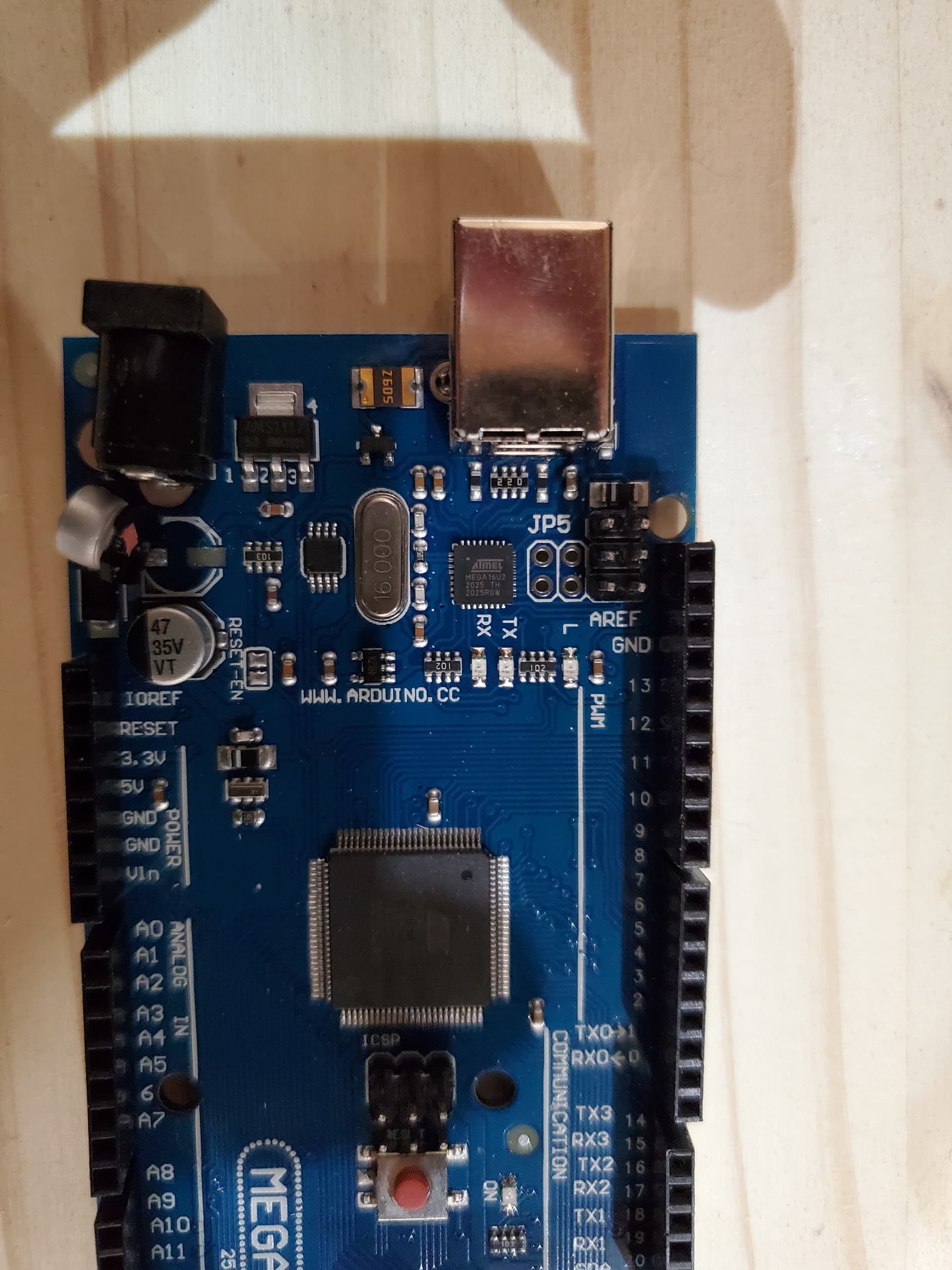

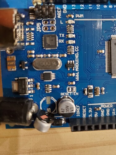

Hi:
I got gifted a eastbay source CNC maslow kit with ZAxis control a while back . and I have just finished up hooking every thing together. While trying to go through the calibration step, I found out that one o fthe capacitors on the main board was loose (Maybe I shook it loose while trying to fix it to the Frame. either way, Right now the motors won’t respond. The board itself seems to be recognized but none of the controls go through. So I have not been able to calibrate the system.
My Question is this:
Do I need to get a new board ? or is this sort of thing covered by warranty ? (even tho its been over 6 months since I got this, its been close to 10 months).
Any help with this is much appreciated

The power is connected to the control board? Motors are not powered via the Arduino but the 12v supply. A bad cap isn’t ideal, but if it isn’t shorted, it should still work to some degree.
**Author:** ![vayu.rw](https://yyz1.discourse-cdn.com/flex031/user_avatar/forums.maslowcnc.com/vayu.rw/32/19966_2.png) [@vayu.rw](https://forums.maslowcnc.com/u/vayu.rw)\
**Post date:** [November 21, 2021, 11:59pm UTC](https://forums.maslowcnc.com/t/eastbaysource-maslow-cnc-main-control-board-damaged/17384/3 "2021-11-21T23:59:53Z")
Hi:
Yes the power is connected via the 12 V power supply. the board itself is recognized by WebControl. (same as it is recognized by the Arduino IDE). However (if the attached images render) the capacitor itself is “disconnected”/“broken” away from the control board. If I need to buy a replacement board then I will do so. But I wonder if the broken capacitor will render the board useless or is it there to just regulate the power.
The motors were not responding. I was getting an error in WebControl when the board was connected :
15218.79: Message: Unable to find valid machine position for chain lengths -10.06, -1.40 . Please set the chains to a known length (Actions → Set Chain Lengths)
(attached are the logs and the JSON config file).

@vayu.rw I am now way an expert, but that capacitor shouldn’t matter too much (I hope someone can confirm for me) as you should not be using that power plug for the machine. Your 12v power supply will plug into the shield that has the motors and what you plug all the motor cables into. That Arduino board will be powered by USB 5v when you plug it in to your computer.
Double check that power connection and see if that works, however, you may need to reset chains first if you are getting that message.

ok, The shield gets power as I can see the green light that indicates power being supplied. I also see a flashing Yellow light the Flashing Yellow light is coming from the Arduino. I will try plugging the USB cable into the other USB ports on the computer and see if it makes a difference.
That said, I am not sure about the statement " but that capacitor shouldn’t matter too much ". I am sure it serves a purpose, I would like to confirm there isn’t a loss in capability or functionality. I will try again.

As for that capacitor, in my very limited knowledge, it’s position right by that barrel connection to the board would tell me that it would regulate the power to the Arduino coming in through that connection. As it shouldn’t be used because the power would come from the USB connection, that is where I was saying “it shouldn’t matter” but I could very well be wrong. If you move that barrel connection from the power supply up to the shield as it should be, then that capacitor shouldn’t have any play when it comes to the 12v power.
I was thinking you could test that and plug the usb into the arduino, and the power into the shield and see if you still get board recognition, and can then move the motors as they now have the requisite power needed.

> [@vayu.rw](#):
You are right, they did put it there for a reason, but luckily we don’t need it for that reason (although it doesn’t hurt). From it’s placement I believe that is a filtering capacitor for the input voltage from the external power plug. Basically power comes in from that jack on the arduino and then gets stored in that capacitor for when the Arduino needs it. We’re not plugging any power in there and getting power from the USB cable instead so I think it should be OK.
