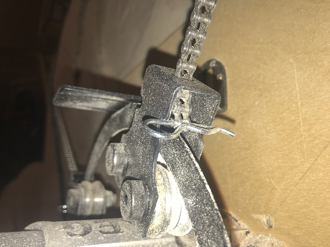

### Author: ![heades](https://yyz1.discourse-cdn.com/flex031/user_avatar/forums.maslowcnc.com/heades/32/12109_2.png) [@heades](https://forums.maslowcnc.com/u/heades)
#### Post date: [March 30, 2019, 12:46pm UTC](https://forums.maslowcnc.com/t/ellipse-instead-of-a-circle/9275/13 "2019-03-30T12:46:31Z")
Or, maybe I do the wrong clamping?

### Author: ![WoodCutter4](https://avatars.discourse-cdn.com/v4/letter/w/bc79bd/32.png) [@WoodCutter4](https://forums.maslowcnc.com/u/WoodCutter4)
#### Post date: [April 1, 2019, 1:46am UTC](https://forums.maslowcnc.com/t/ellipse-instead-of-a-circle/9275/14 "2019-04-01T01:46:14Z")
@heades
> [@heades](#):
I believe you are correct. Change it like the picture from the [assembly instructions](http://maslowcommunitygarden.org/Maslow-Ring-System.html?instructions=truce).

### Author: ![Gero](https://yyz1.discourse-cdn.com/flex031/user_avatar/forums.maslowcnc.com/gero/32/17487_2.png) [@Gero](https://forums.maslowcnc.com/u/Gero)
#### Post date: [April 1, 2019, 4:20am UTC](https://forums.maslowcnc.com/t/ellipse-instead-of-a-circle/9275/15 "2019-04-01T04:20:42Z")
The assembly instruction needs to be updated.
> [@New lesson learned today](https://forums.maslowcnc.com/t/new-lesson-learned-today/3800):
> Just pulled the hollow link off the end of the chain today while calibrating my Maslow. My sled went swinging to the opposite side. No harm done, but thought I’d share the lesson not to attach to a link without a pin in it.
Use the second link. As long as you put the same link on 12 o’clock to feed out, the chain length will be correct.
#### Post date: [April 1, 2019, 1:42pm UTC](https://forums.maslowcnc.com/t/ellipse-instead-of-a-circle/9275/16 "2019-04-01T13:42:34Z")
> [@Gero](#):
You are saying to put the second link on 12 o’clock, if using the second link on the ring?
The calibration instructions say to put the first link on 12 o’clock. Due to the safety issue you linked to, which plenty of others have experienced, should we suggest changing the calibration and assembly instructions to use the second link for the ring kit?
We would have to reference different instructions specific to ring and linkage. I use dlang’s metal linkage and must connect to the first link.
### Author: ![Keith](https://yyz1.discourse-cdn.com/flex031/user_avatar/forums.maslowcnc.com/keith/32/1332_2.png) [@Keith](https://forums.maslowcnc.com/u/Keith)
#### Post date: [April 1, 2019, 1:46pm UTC](https://forums.maslowcnc.com/t/ellipse-instead-of-a-circle/9275/17 "2019-04-01T13:46:09Z")
> [@WoodCutter4](#):
Yes, that is what he is saying.
> [@WoodCutter4](#):
This has been suggested, but apparently not implemented yet.
> [@WoodCutter4](#):
I believe @dlang has a solution for this, but I don’t remember where I saw it. He will likely weigh in shortly.
#### Post date: [April 1, 2019, 1:51pm UTC](https://forums.maslowcnc.com/t/ellipse-instead-of-a-circle/9275/18 "2019-04-01T13:51:37Z")
> [@heades](#):
> B3764169-692D-4C76-8052-B21028A6A51B.jpeg4032×3024 2.44 MB
> ](https://canada1.discourse-cdn.com/flex031/uploads/maslowcnc/original/2X/4/439ebe650935a0c590010a8b3ec945fde19ef6ee.jpeg)
@Keith
Or, could you do it like @heades has done but use the 3rd, or 4th?, link on 12 o’clock? I like how he put the pin through the chain, which will be safe and prevent the issue that @Gero linked to.
#### Post date: [April 1, 2019, 2:02pm UTC](https://forums.maslowcnc.com/t/ellipse-instead-of-a-circle/9275/19 "2019-04-01T14:02:14Z")
You could. The important part is that you put the same link where it connects to the pulley traveler at the 12-o-clock position when you feed out the chain. The only thing I would be concerned about is whether the link ends up in the same position as when the cotter pin is put between the links. If it does, then you should be golden.
