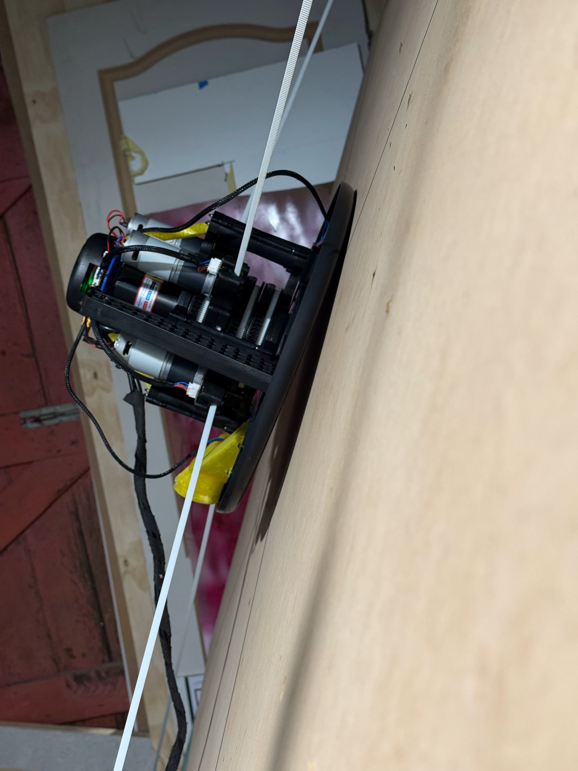

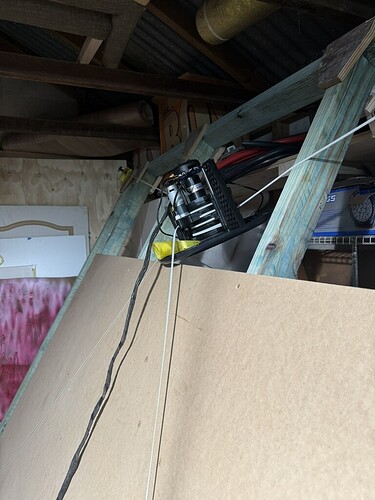

Hi there!
After an initial cut a few months ago, life got in the way and I’ve only now come back to the Maslow.
Around the time of the initial cut, the retraction threshold was getting quite high, so I decided to do some maintenance and see if I could make things a bit better. Unfortunately I made them worse!
Here’s what I did:
- Disassembled arms, applied some grease as the bottom two were binding up
- Reassembled, ran calibration
- machine would always stop at the bottom right and get stuck in endless calculation (left overnight multiple times)
- Found I put too much grease and it was being affected by the cold weather
- disassembled again, cleaned out the grease, applied silicone lubricant
- re-assembled - with the arms from bottom to top: BL, BR, TR, TL
- same issue with the calibration - gets stuck in bottom right
- re-flashed firmware 1.7, uploaded fresh index and Maslow.yaml
- Ran calibration on 500x500 3x3 - successful
- moved machine around the spoil board - when getting to the bottom left, the bottom two belts started to get loose
- Maslow seemed too tight in parts, bottom of sled was lifting, jerky movement
- applied silicone lube to bottom of sled - same issue
- tried re-calibrating on a 5x5 (?) and 1000x1000 grid - again stuck on bottom right.
Log below:

Hey @bar
Not 100% sure about belt tightness all the way through that initial calibration, but certainly when jogging later the bottom two became loose.
The bottom two are the arms I’ve been having the most trouble with - this time they’ve been assembled and when assembling then seemed free, but the numbers are getting high again now
The retraction force was sitting quite happily around the 1200-1300 mark, but over a few attempts at calibration that is now starting to creep up. I’ve noticed that sometimes when sending the retract command, one or two of the belts wouldn’t retract until I chose extend, just move them a little, and then retract seems to work.
So this morning I thought I’d try increasing the retraction force - and I’ve reached 1800 before all belts will reliably go in.
The bottom left belt is the most reluctant. At what force are we entering belt snapping too much force
 ![IMG_1606](https://canada1.discourse-cdn.com/flex031/uploads/maslowcnc/original/3X/3/d/3d28559fa82560a6dc02387ed14f0526d945a6ea.jpeg)
territory?
I tried running calibration at 1800 retraction and calibration force, but then the bottom of the sled lifts so high I stopped it.
Could this be something to do with the sled being lighter because of the spindle instead of a heavier Dewalt router?
As previously mentioned, the first time I managed to get a full, successful calibration the sled was lifting at the bottom when the Maslow was on the left side of the frame. I saw somewhere in the forums people commenting on arm order, and I’ve now got it configured from bottom up, BL, BR, TR, TL. Is this bad?

Incidentally - when the calibration actually completed on the 5x5 at 1000x500, I thought - oh great, let’s see if I can increase it. So I upped it to 1500x750 and 7x7 - then hit calibrate. Suddenly the machine took off and climbed the board and tried to jump off the top - luckily I managed to grab it and pull the power before it jumped off the edge. Yikes! Any clue what gremlin could have caused that?
 ![0AEF71F7-FF6F-4869-8FDC-39CB2F042FD6_1_105_c](https://canada1.discourse-cdn.com/flex031/uploads/maslowcnc/original/3X/6/2/62a50540d5972856cc137fd5af5ce47fbf49db42.jpeg)
