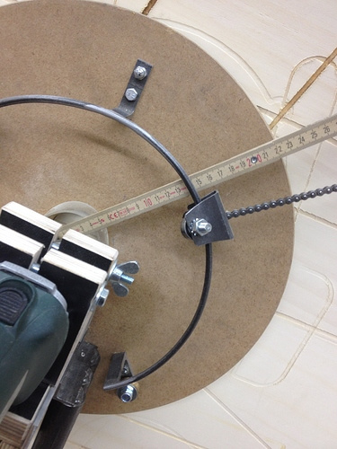

> [@sarham6](#):
> what is the Rotation Radius
The distance from the centre of the cutting-bit to where the chains attach to the sled.
![image](https://canada1.discourse-cdn.com/flex031/uploads/maslowcnc/original/2X/0/02e3c03f70270ae90d24cbb415696443bd4aabce.jpeg)
**Post date:** [November 28, 2018, 8:50pm UTC](https://forums.maslowcnc.com/t/error-message-during-uploading-arduino/7855/22 "2018-11-28T20:50:45Z")
Rotation radius is (generally speaking) the distance from the router bit to the point on the ring/linkage kit where the chain is attached.
