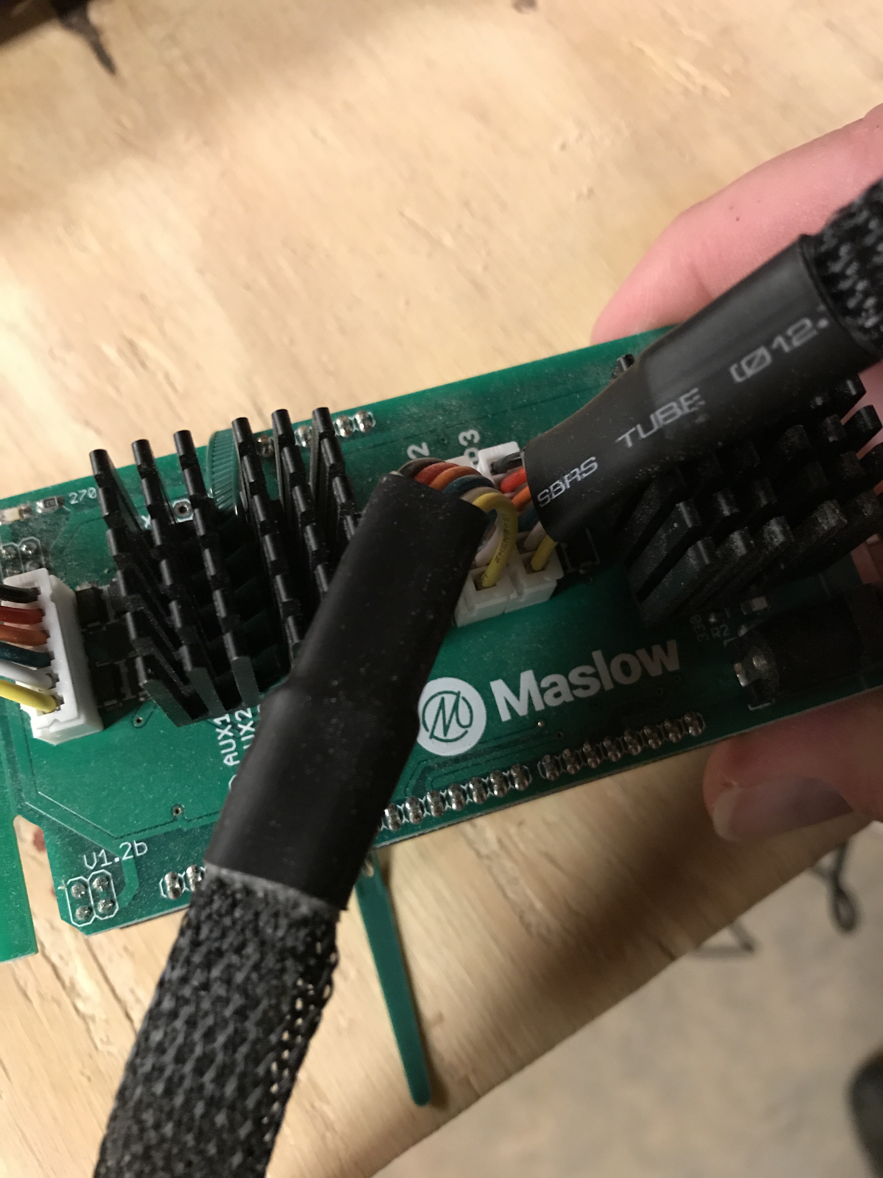

> [@blurfl](#):
> A couple pieces of information that would help in troubleshooting this issue would be
> - What PowerControl board are you using - stock Maslow, BlueSmoke, other (which?)
> - What is the version number shown on the silkscreen of the board
> - what version of firmware
I am using Stock Maslow v1.2b (I can attach picture if needed)
I am currently using GC and Firmware 1.2
 ![IMG_5706](https://canada1.discourse-cdn.com/flex031/uploads/maslowcnc/original/2X/d/d73be2db577fc1802f6469451771ff7300b5d1bb.jpeg) ![IMG_5707](https://canada1.discourse-cdn.com/flex031/uploads/maslowcnc/original/2X/8/8477fb9c3275eeb680d71a122693e5f3f7333400.jpeg)
