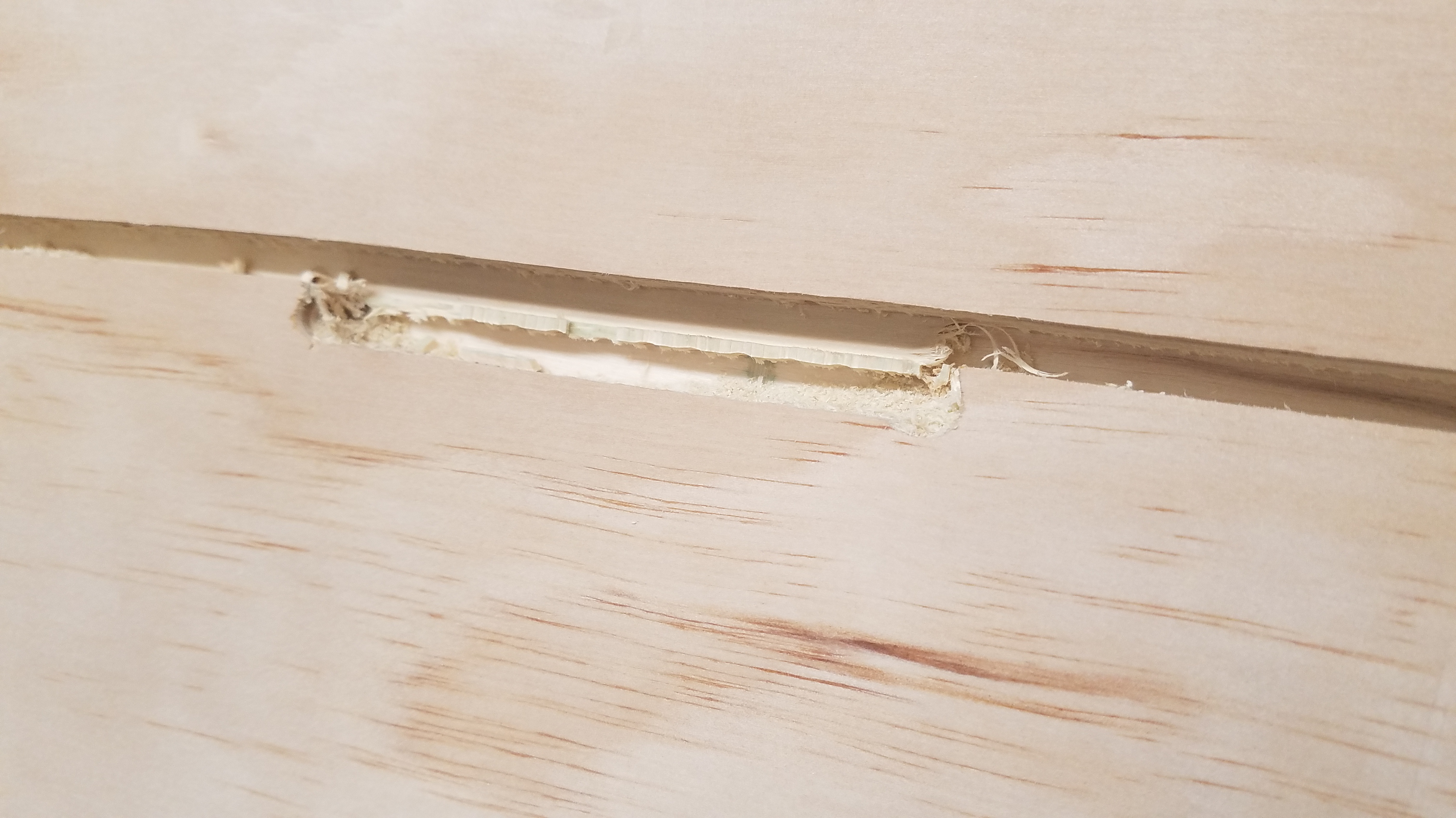

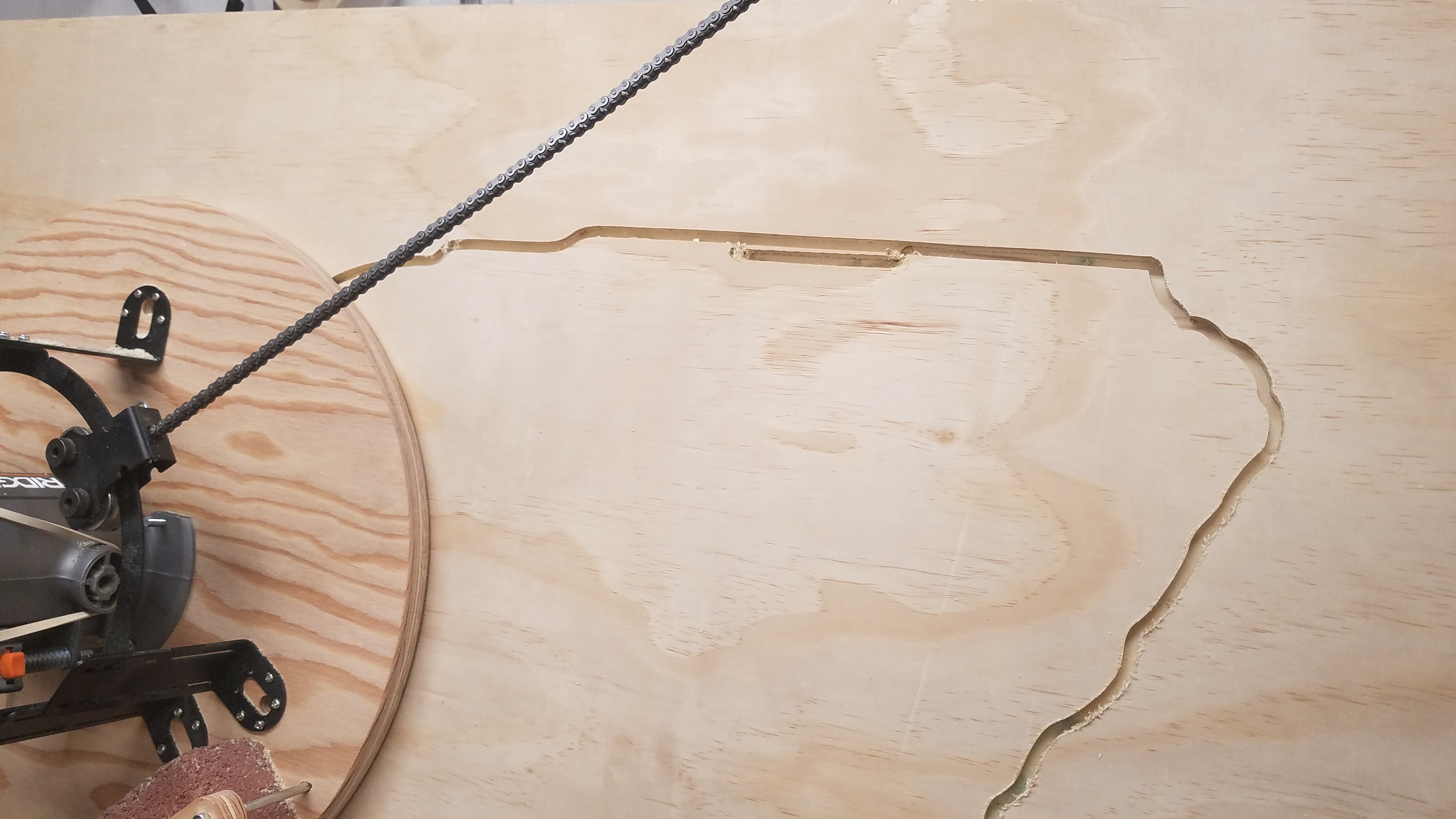

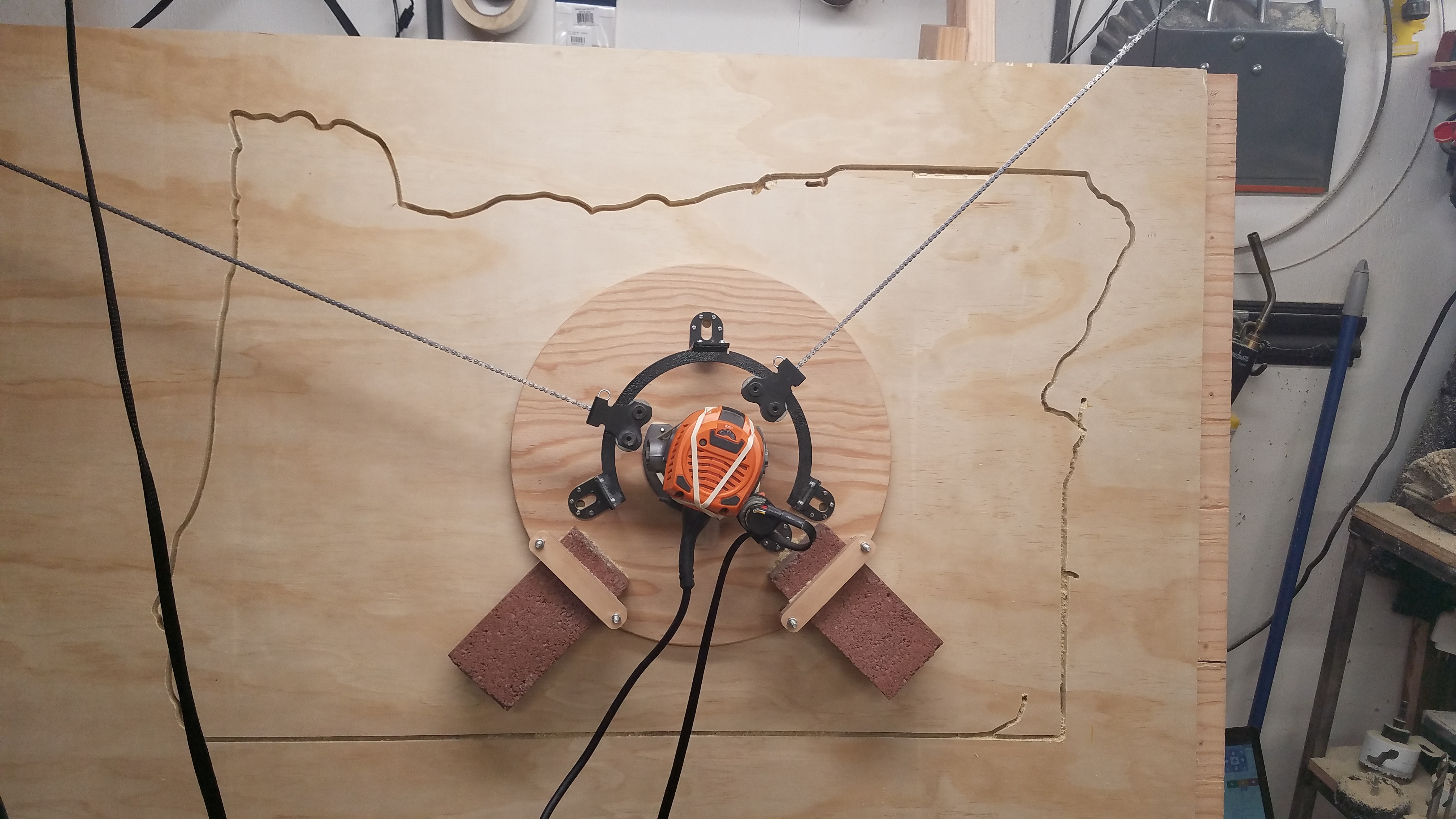

To enjoy a little this machine, I gave the calibration problem a break. Then I stumbled into another issue. I was cutting an outline of Oregon on ply.
Speed of cut set at 1000mm/min
Passes 3mm
1/4" flat end mill, up spiral.
Speed dial or the Ridgid router set at 19000
The 3 passes went well. Then something happened in the upper part of the contour (see picture). The bit started moving down.
I stopped the job, went back to center and restarted the job. Once back, the beginning of the cut did not align with the first passes. Like if the whole thing has moved, like if the chain or sprocket skipped.
Any idea? Can I save this cut?

**Post date:** [April 23, 2019, 10:05pm UTC](https://forums.maslowcnc.com/t/first-cuts-uneven-edges-of-cut/9579/16 "2019-04-23T22:05:03Z")
you can try moving a chain a tooth on the sprocket, but it’s hard to get it
right.
that does look like what happened. make sure that the chains are parallel to the
workpiece (both the side towards the sled and the slack)

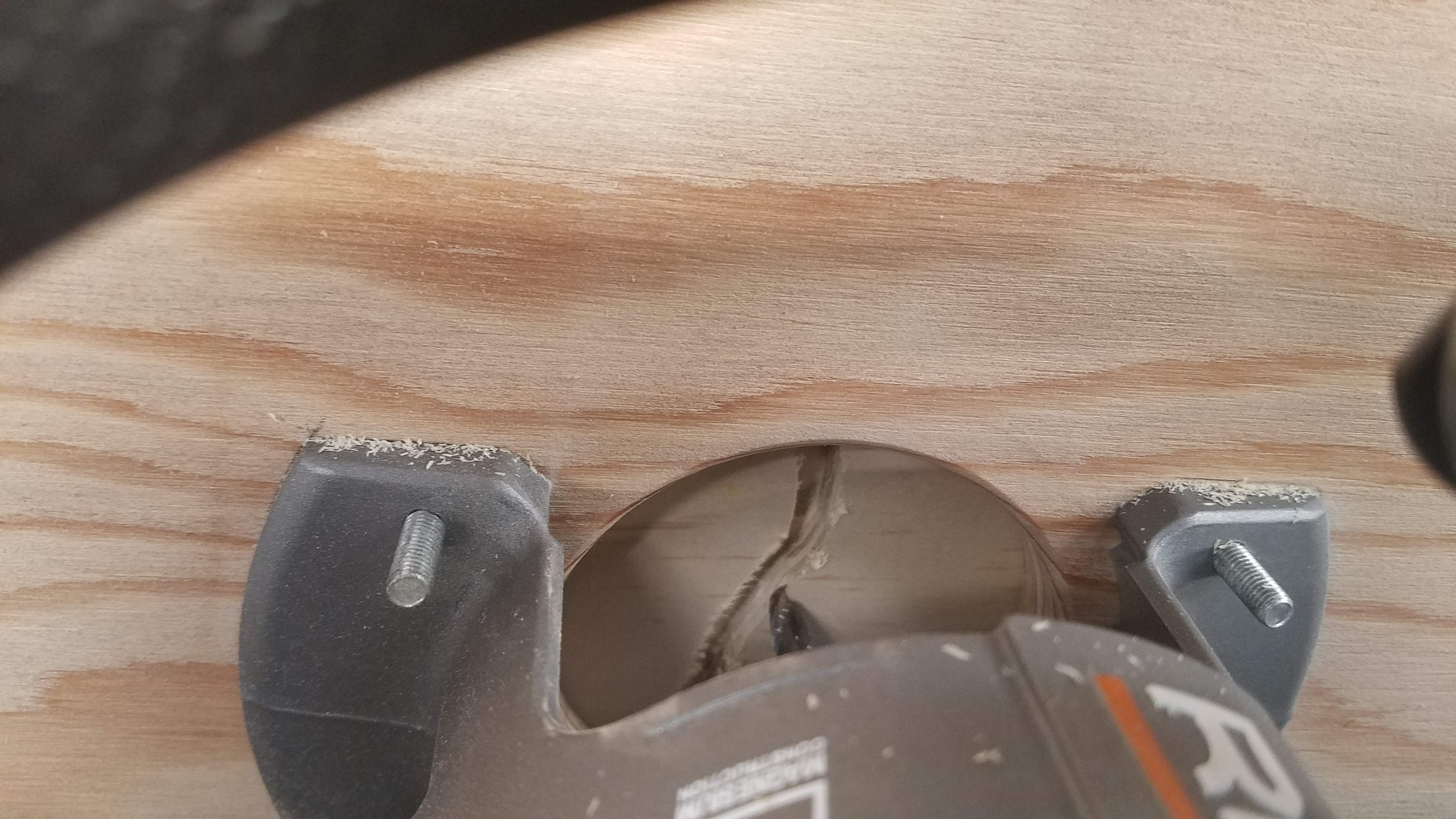

I was able to get it back into position. I started to cut again and after a good pass is started biting into the path again ☹
The chain is parallel to the workspace. I checked that when I built the sled. As for the slag, I am using the bold on frame. Any suggestion about how to keep that parallel?

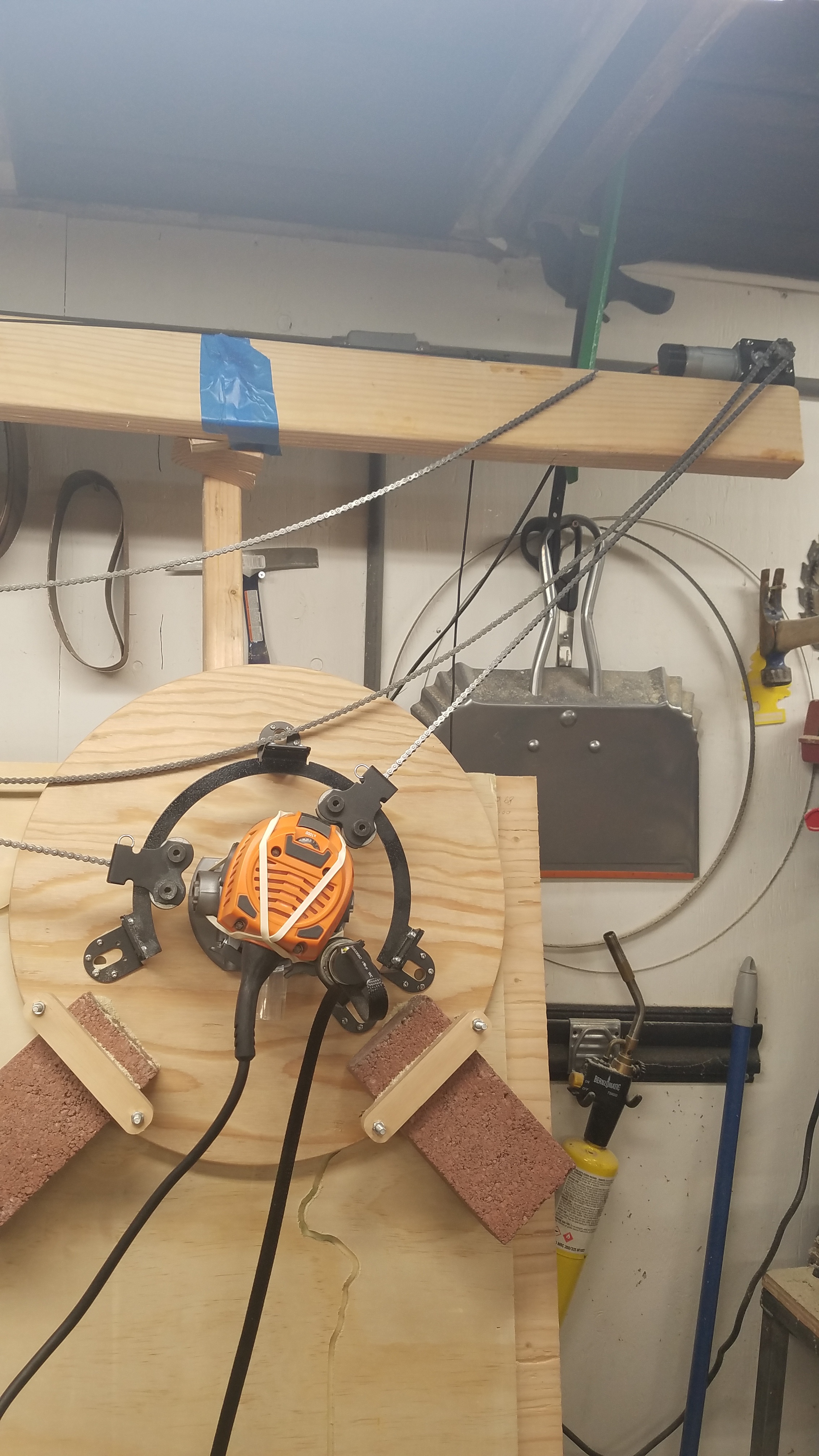

I am attaching a picture of the right top of my frame setup.
So basically I need to keep the router as slow as I can? As for the cam, is 1000mm/min a good speed? (it should be maslow maximum speed).

**Post date:** [April 23, 2019, 10:59pm UTC](https://forums.maslowcnc.com/t/first-cuts-uneven-edges-of-cut/9579/19 "2019-04-23T22:59:50Z")
you don’t want to have that little tension on the slack side, but with the
standard stretchy cord you don’t have much tension. you can try doubling up the
strechy cord, or replace it with a weight.
**Post date:** [April 24, 2019, 12:02am UTC](https://forums.maslowcnc.com/t/first-cuts-uneven-edges-of-cut/9579/20 "2019-04-24T00:02:04Z")
it also looks as if you may be having trouble with your sled sticking, can you make a video of it cutting? that may help us figure out where it’s going wrong.
