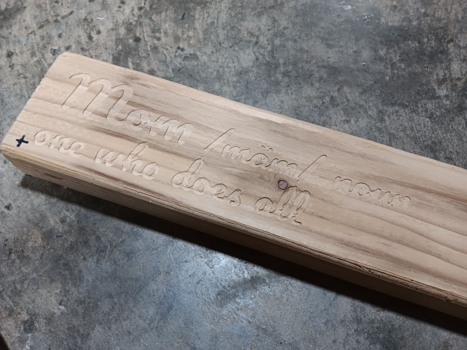

Started my first v carve and it appears that there is some edge roughness. Not sure if it is due to the inaccuracies in placement or cutting too fast or what exactly. Will do another attempt slower and at less depth.
Open to any suggestions. Thanks.
![Screenshot 2024-05-04 233250](https://canada1.discourse-cdn.com/flex031/uploads/maslowcnc/original/3X/c/7/c7b3068d1e4d35a5a06b70c3c16d2de2fcc329b0.png)
Marked the center on the wood which lined up with the g code home position. This technique worked well.
 ![20240504_221215](https://canada1.discourse-cdn.com/flex031/uploads/maslowcnc/original/3X/f/1/f1e8c28b82f9d6c3edfb504174721eb99c40ab8c.jpeg)
Cut Part
 ![20240504_232504](https://canada1.discourse-cdn.com/flex031/uploads/maslowcnc/original/3X/1/7/173f608176c9fdbe92b3be3f6b82e7c803b50c67.jpeg)
Zoomed in to show the bumpyness
 ![20240504_233703](https://canada1.discourse-cdn.com/flex031/uploads/maslowcnc/original/3X/4/5/450a5cb3573370d22689573ae2984188c6de6a8a.jpeg)

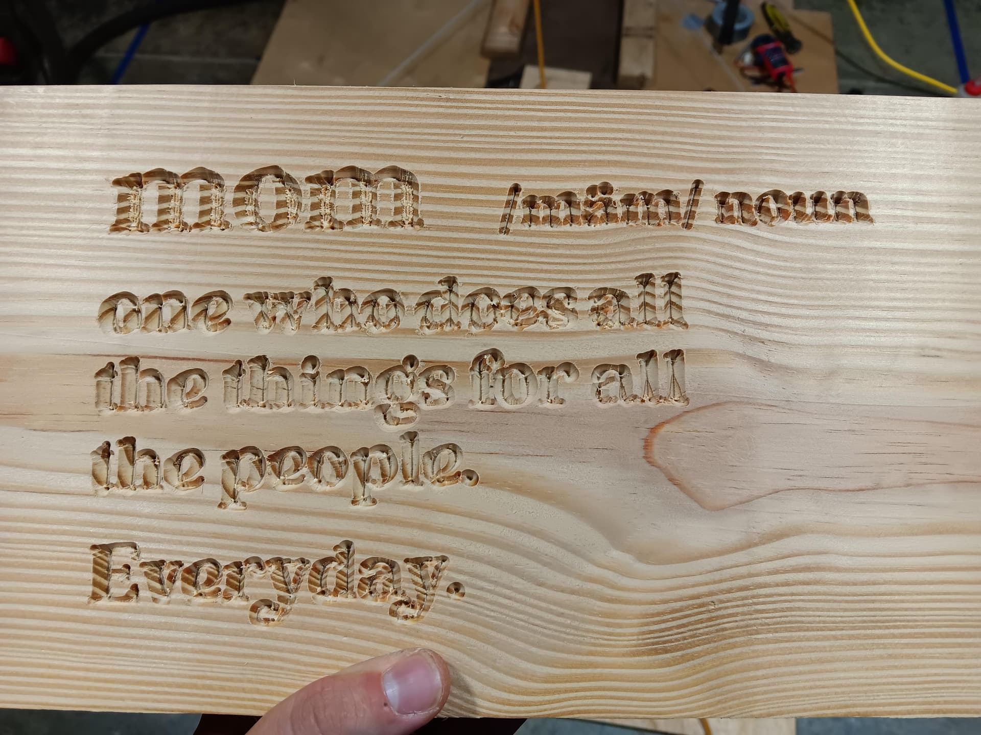

Slowing the speed down to 5ipm as well as 0.025in passes seemed to have helped. Overall depth 0.05 inches.
 ![20240505_090149](https://canada1.discourse-cdn.com/flex031/uploads/maslowcnc/original/3X/0/4/04b8fb27c4122d3617141fa17ea4cf265c409a31.jpeg)
 ![20240505_091525](https://canada1.discourse-cdn.com/flex031/uploads/maslowcnc/original/3X/b/6/b658f927f3c62880d846957cd57781762db6039c.jpeg)
**Post date:** [May 5, 2024, 3:43pm UTC](https://forums.maslowcnc.com/t/first-v-carve-attempt-mom-sign/20948/3 "2024-05-05T15:43:11Z")
I think that this looks pretty great!
We still need to tune the PID controller which should help improve that kind of fine movements at higher speeds too
