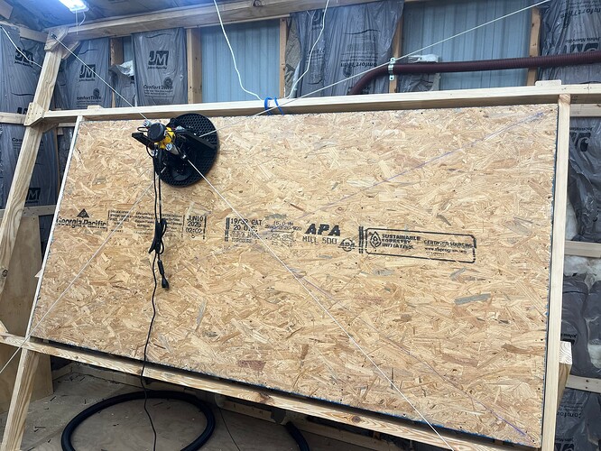

Ok. Recommended wood frame build and screwed to the wall and floor. Machine assembled and updated with the 1.07 firmware (usb updated). I’ve attached serial logs of the test, retract, extend, calibrate and fitness loop. I’ve tried small grids and large grids vertical setup.

![IMG_1280](https://canada1.discourse-cdn.com/flex031/uploads/maslowcnc/original/3X/0/6/064453dcf57688f2486539ada28b20aabf23206f.jpeg)
 ![IMG_1281](https://canada1.discourse-cdn.com/flex031/uploads/maslowcnc/original/3X/a/2/a212bd1ac9edea0aa3691d9c7455a83a6b0d99c5.jpeg)

The video is too large to send
**Post date:** [August 15, 2025, 12:02am UTC](https://forums.maslowcnc.com/t/fitness-loop-and-calibration-issues/24727/4 "2025-08-15T00:02:52Z")
Thanks for posting the logs, those are super helpful!
From a quick look at the data something is going super wrong, but it’s hard to tell what.
Can you try uploading the video to YouTube? I think that seeing the video would help a lot with spotting it.

I’m pretty sure that what is going on there is that the machine is running in horizontal mode when it should be in vertical mode. This is the stetting here that you want:
 ![image](https://canada1.discourse-cdn.com/flex031/uploads/maslowcnc/original/3X/f/a/fada8f50c9d28fa6700200afd26d42ff54e16846.png)
Basically it’s not expecting gravity to be pulling down on it like that. The two different modes handle gravity differently.

It is in vertical mode. I make sure each time I connect and after every change I make. It was defaulted to horizontal when I first connected after my usb update. I’ll try tomorrow to select horizontal and save then switch back to vertical and save it. Then try again to calibrate.
**Post date:** [August 15, 2025, 12:56am UTC](https://forums.maslowcnc.com/t/fitness-loop-and-calibration-issues/24727/8 "2025-08-15T00:56:13Z")
Hmmm interesting, I believe you it does look like it could be in vertical mode.
Can you try replacing your Maslow.yaml file and see if maybe there are some strange numbers in there that are messing things up?

**Post date:** [August 15, 2025, 2:53am UTC](https://forums.maslowcnc.com/t/fitness-loop-and-calibration-issues/24727/13 "2025-08-15T02:53:23Z")
> [@Bryan1](#):
> Also it never runs a “grid” pattern like the video of you calibrating your vertical setup. The machine just seems to make its way up to the top of the board in a few moves and then starts the fitness loop.
I think that this is the first thing that we need to figure out. Let’s try fully deleting and replacing the .yaml file and then starting fresh from powered off so we’re in a state that we know is fresh.
Sometimes if there is something weird like totally crazy numbers in there from some past calibration that didn’t work right it could cause some unexpected behavior.

I just had this EXACT SAME thing happen.
That’s not a solution, but at least I’m able to replicate it. Working on figuring out what it is now.
**Post date:** [August 15, 2025, 5:55pm UTC](https://forums.maslowcnc.com/t/fitness-loop-and-calibration-issues/24727/17 "2025-08-15T17:55:58Z")
OK, I’ve got some bad news. I discovered the issue and it was…I forgot to switch the machine from horizontal to vertical mode 😛
The behavior was IDENTICAL to the video though so I’m 99% sure that is the issue. It doesn’t mean that you didn’t set it, but something was preventing the machine from recognizing that it is in vertical mode.
Can you try updating to 1.09 replacing the maslow.yaml and index.html.gz files also. That way we’re starting fresh and we know that your system is set up just the same way that mine is.
Then can you try running a pretty small grid like this:
 ![image](https://canada1.discourse-cdn.com/flex031/uploads/maslowcnc/original/3X/6/2/62e3f502ace5146fd0ab8dfd49042eafbc1e1edb.png)
