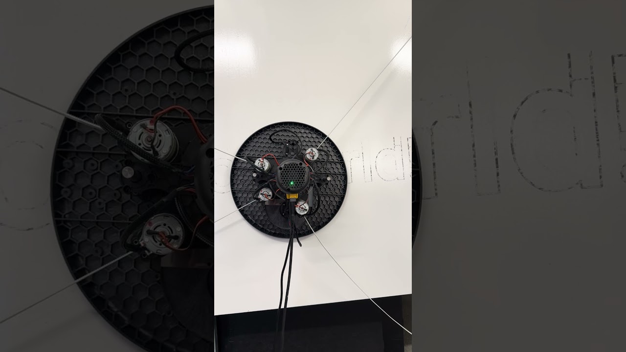

![IMG_1284](https://canada1.discourse-cdn.com/flex031/uploads/maslowcnc/original/3X/a/9/a9e427d331877e9f9d7706245850a4050c082cfd.jpeg)
 ![IMG_1281](https://canada1.discourse-cdn.com/flex031/uploads/maslowcnc/original/3X/a/2/a212bd1ac9edea0aa3691d9c7455a83a6b0d99c5.jpeg)
**Post date:** [August 15, 2025, 9:41pm UTC](https://forums.maslowcnc.com/t/fitness-loop-and-calibration-issues/24727/22 "2025-08-15T21:41:07Z")
`[MSG:INFO: Calibration starting in VERTICAL orientation mode]`
The machine knows that its in vertical mode for sure
Is the behavior that you are seeing still looking exactly the same as in the video? It’s not moving along a grid?

Yes. I’m trying send the video. Just a second

Ok so I first wiped out all the old uploads from my laptop then updated the board with the usb to 1.09. Did the power off, disconnect and reconnect. Extended belts retracted belts, set grid size and all that. Saved. Powered down, disconnected, powered up, reconnected, hit retract the extend. Hung the machine and hit calibration. The movement is the exact same every time I calibrate. Same pattern. Then stops at the top in the fitness loop. Fitness rarely goes above a 0.03. Thanks from looking the files over. The unnumbered log was after the update and hit the test button. The number sequence should match the steps I listed here. Also included the yaml file.

It’s OK to just post one log file at the end, it will capture everything that happens before it and it’s not too hard to match up what I’m seeing with where in the file each thing is happening.

**Post date:** [August 15, 2025, 9:58pm UTC](https://forums.maslowcnc.com/t/fitness-loop-and-calibration-issues/24727/28 "2025-08-15T21:58:39Z")
> [@bar](#):
> ```auto

I keep watching that video and it looks so much like what it looks like to run in horizontal mode on a vertical frame. Here is my machine in horizontal mode for comparison:
[![](https://img.youtube.com/vi/VMIgFpUwG5s/maxresdefault.jpg "Running Horizontal Mode on a Vertical Frame") ](https://www.youtube.com/watch?v=VMIgFpUwG5s)
The similarity is really striking and I can’t figure out what else could cause that…but clearly that isn’t what is going on.
