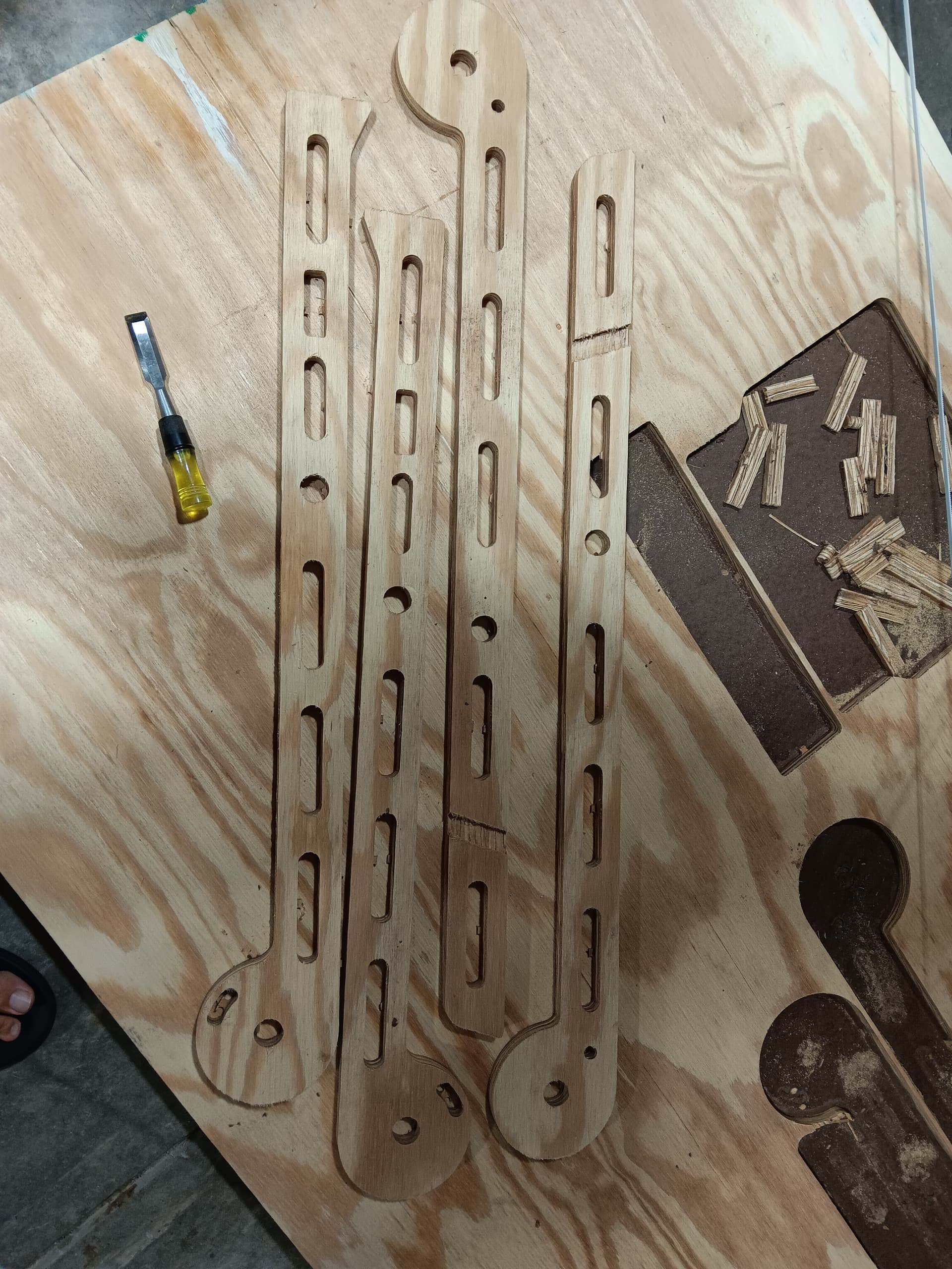

Test fit of dowel and hole. Really impressed with the overall accuracy
 ![20240920_181039](https://canada1.discourse-cdn.com/flex031/uploads/maslowcnc/original/3X/7/6/76549d9e133aa8622e3205e2da1e588fac6be54c.jpeg)
Leg Cut
 ![20240921_110952](https://canada1.discourse-cdn.com/flex031/uploads/maslowcnc/original/3X/3/b/3b0b9975725b17fa978f27c6f5930ebdb4b68eab.jpeg)
 ![20240921_121644](https://canada1.discourse-cdn.com/flex031/uploads/maslowcnc/original/3X/b/7/b777d55ca3335e40b4f041bd653ef48efa8fbb93.jpeg)
 ![20240921_114920](https://canada1.discourse-cdn.com/flex031/uploads/maslowcnc/original/3X/5/4/54e44369a76fdaa7a05def9af8958cf2dac21fc7.jpeg)
Sawdust removed from the cuts
 ![20240921_121940](https://canada1.discourse-cdn.com/flex031/uploads/maslowcnc/original/3X/a/7/a71d5dd90e052ccc359a6f11fce818f81db79fe4.jpeg)
Legs removed from the sheet.
 ![20240921_122136](https://canada1.discourse-cdn.com/flex031/uploads/maslowcnc/original/3X/5/3/533cd2733700042c6e9584047eac0c3089417657.jpeg)

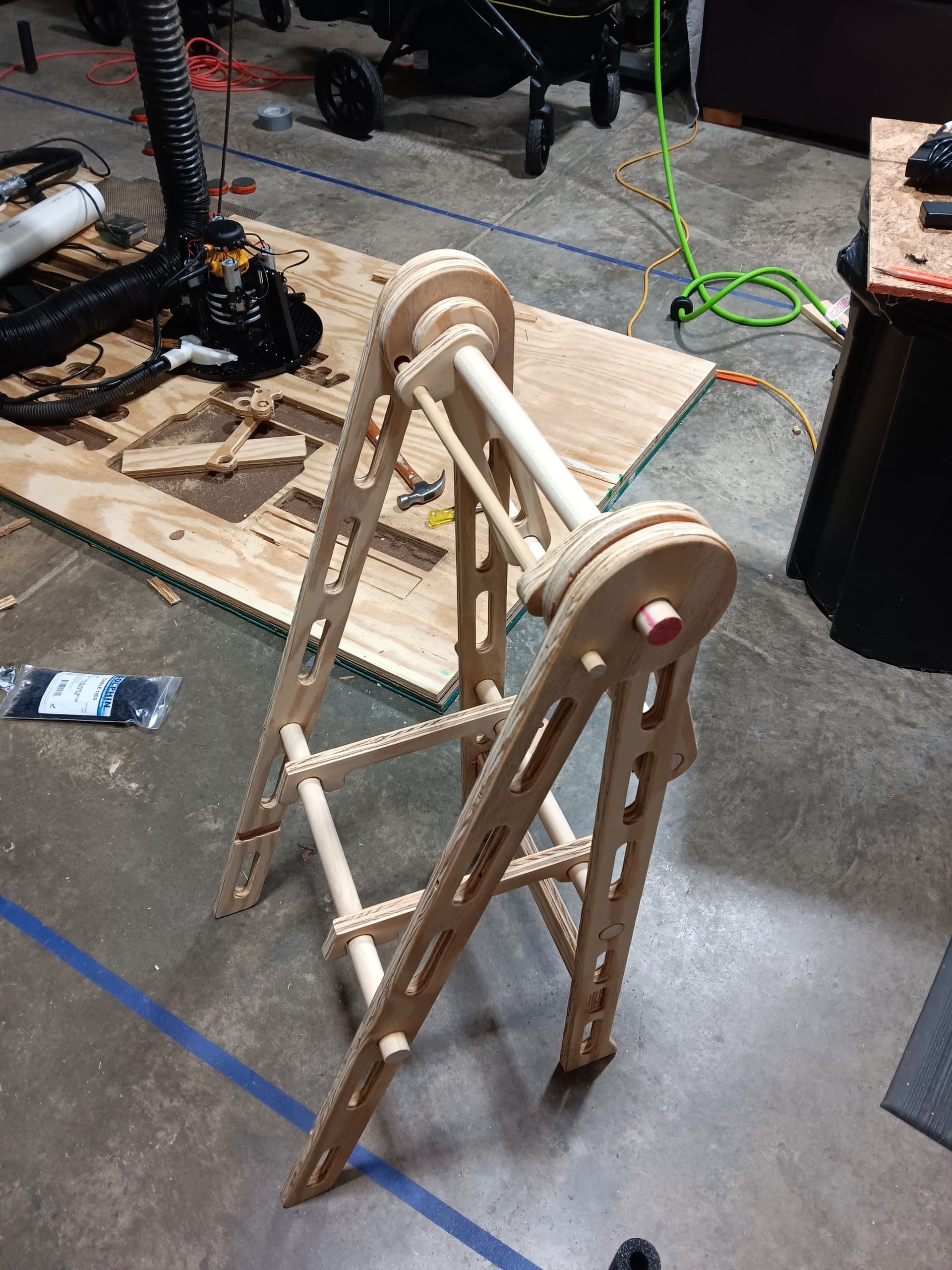

Unfolded in real life test. Obviously the dowels need to be cut to the right length 🙂
 ![20240921_143818](https://canada1.discourse-cdn.com/flex031/uploads/maslowcnc/original/3X/f/5/f5a1da1110b90543045f91d07b16adcebc4af7a0.jpeg)

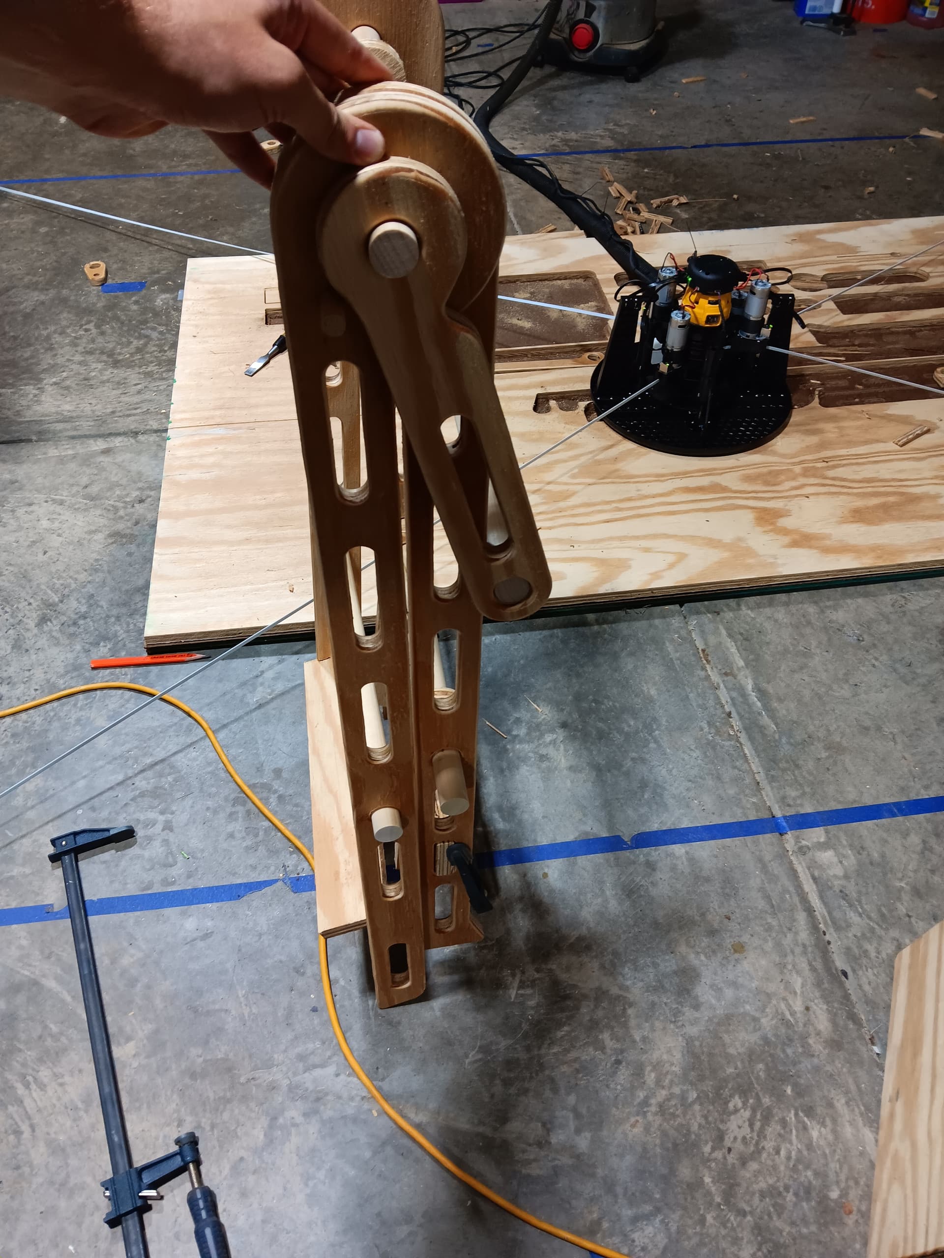

Folded in real life test
 ![20240921_143830](https://canada1.discourse-cdn.com/flex031/uploads/maslowcnc/original/3X/5/f/5fb8791000a1b8081c0fb975b9dcde7b724e2770.jpeg)

Dry fit is complete with some additional changes to the design.
**Changes**
Just to note that I have moved extended the rotating arms outwards from the original design. This is mainly because my little one is HUGE at 99% so YMMV but it seems to work well so far. Here’s the upper arms in their original as designed position. Arrows denote where they were moved to in order to make the upper area for the child ~ 3" wider than originally designed.
 ![20240925_214017_](https://canada1.discourse-cdn.com/flex031/uploads/maslowcnc/original/3X/3/b/3b1e221dd0b7e8717089a8a9ace2401350013aa8.jpeg)
The lower step which is fixed sets the width of the angled legs. However, it appears that when this would be glued there isn’t enough clearance for the platform for freely swing. In the design I added clearance on each side which appears to be too much. I will go back and recut this lower step at .1" longer to solve the lack of swing clearance for the main platform.
 ![20240925_224936._edjpg](https://canada1.discourse-cdn.com/flex031/uploads/maslowcnc/original/3X/d/b/db6f2383c714183f9ad012e4c2ab628cb3aab321.jpeg)
Dry Fit
Overall Looks after dry-fitting everything together.
 ![20240925_224936](https://canada1.discourse-cdn.com/flex031/uploads/maslowcnc/original/3X/e/3/e389832c96b11d44403bf21d682924204d2f1194.jpeg)
 ![20240925_224245](https://canada1.discourse-cdn.com/flex031/uploads/maslowcnc/original/3X/9/0/902f8b232de7bd73fd19c8a9334b95ae7f02da3a.jpeg)
 ![20240925_224525](https://canada1.discourse-cdn.com/flex031/uploads/maslowcnc/original/3X/8/3/830d1074a672ebda55da1ea5aea6d6f7069dee6c.jpeg)
The folding process being tested:
Upper support being folded back
 ![20240925_224558](https://canada1.discourse-cdn.com/flex031/uploads/maslowcnc/original/3X/d/d/ddb64cdc8369a56319886c2059ae538b9bc9e7f7.jpeg)
Platform folded inwards
 ![20240925_224639](https://canada1.discourse-cdn.com/flex031/uploads/maslowcnc/original/3X/6/9/693dce464cae5014cbc8cb7748d3409c30c0a1a8.jpeg)
Leg folded towards vertical leg
 ![20240925_224641](https://canada1.discourse-cdn.com/flex031/uploads/maslowcnc/original/3X/c/b/cb460258d33a7166f8e7fbd8fd736994c3228caf.jpeg)
Done!
 ![20240925_224716](https://canada1.discourse-cdn.com/flex031/uploads/maslowcnc/original/3X/9/b/9bc7bddd8cf6362fd978a6c5a8a7e9a449452f1e.jpeg)
