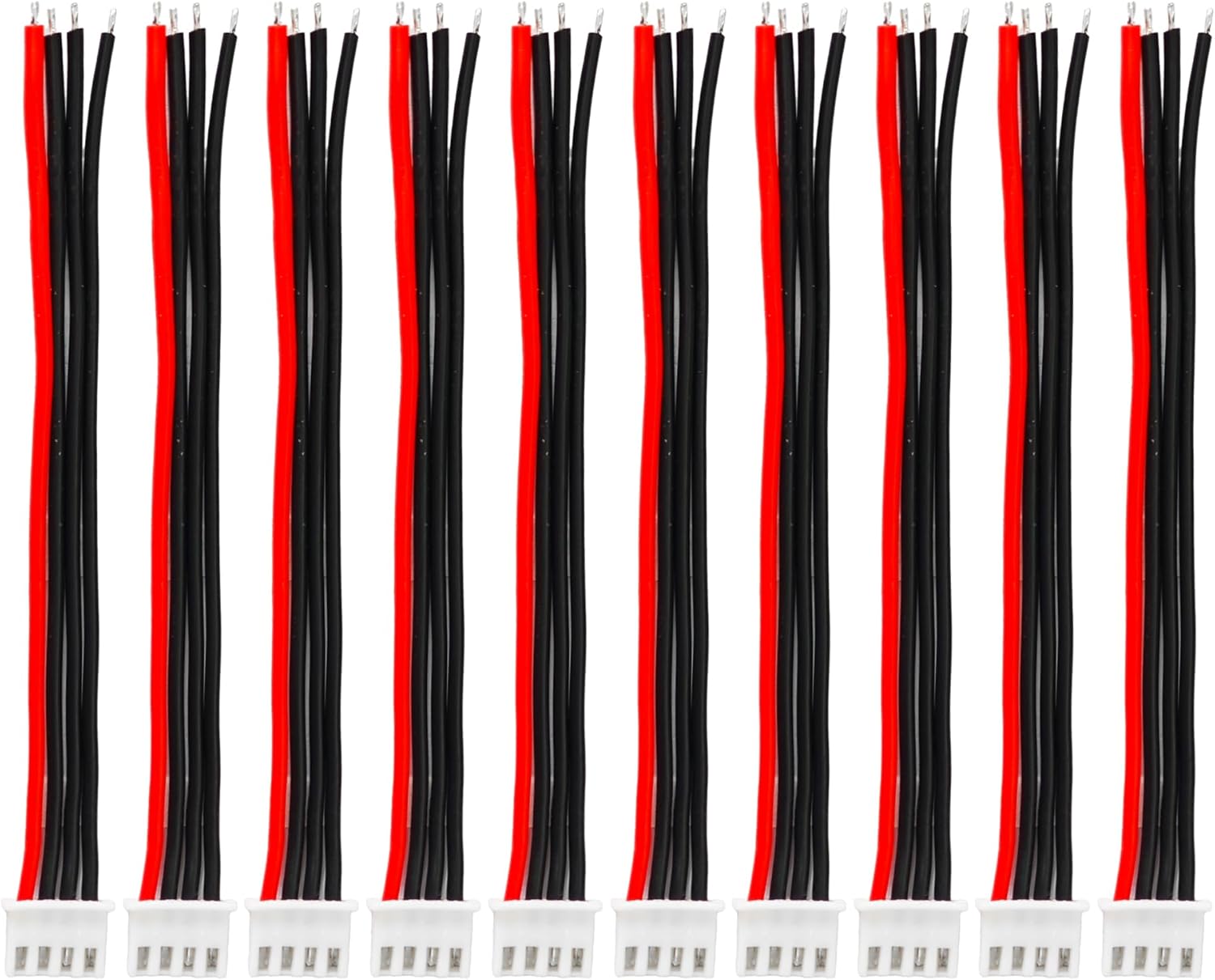

get a short pigtail like these:
> **[Amazon.com: bociloy 10PCS JST-XH 3S Balance Extension Cable, 3.9" 22AWG Silicone...](https://www.amazon.com/bociloy-Balance-Extension-Silicone-Connector/dp/B0FJFM66G1?tag=maslowcnc0d1-20)**
> Product Description: Features: Strong Construction: High-grade silicone coating protects 22AWG copper wires from wear. Built for repeated use in RC hobby applications. Easy Connection: JST-XH plugs provide secure mating with battery balance ports....
and then I drilled holes through the side of the cap where the board was, but
two bolts through the holes with this pigtail on the inside, then I can use
either clips or magnetic jumper wires like these
[https://www.amazon.com/Magnetic-Professional-Silicone-Flexible-Switches/dp/B0BY1GVR6M/](https://www.amazon.com/Magnetic-Professional-Silicone-Flexible-Switches/dp/B0BY1GVR6M/?tag=maslowcnc0d1-20)
(I like the magnets, if I forget to detach them they will fall away)
I haven’t decided if I want to cut the other end of the wire and leave them
permanently attached, or just use the magnets to hold them to the bolts.
