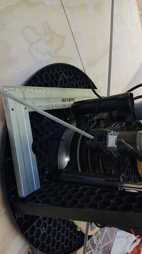

These are definitely not the best settings, as the job took a long time, and the drill bit ended up black at the tip. The depth was 3 mm, and the step down I used was 0.1 mm. I think the feed rate was 700 mm/min, and the plunge rate was 80 mm/min. Next time, I’ll use higher speeds and depths.
> [@norelation](#):
> What speed was the router set at?
Here I also think I made a mistake, because I set my DeWalt router to the maximum speed at 6.
> [@norelation](#):
> What do you mean you used a ruler to dissipate the heat?
The stepper motors got too hot, especially the one opposite the one connected to the vacuum cleaner. I put an aluminum ruler that cooled it very well.
 ![WhatsApp Image 2025-08-25 at 17.21.04](https://canada1.discourse-cdn.com/flex031/uploads/maslowcnc/original/3X/5/4/5478e1d31f42cb44941121d29a447f6f50ac9937.jpeg)
I think all of these are examples of how not to do it, although it all depends on the material and the cutter used.
