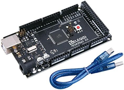

#### Post date: [September 17, 2019, 11:11am UTC](https://forums.maslowcnc.com/t/have-not-been-able-to-even-get-through-the-setup/11136/20 "2019-09-17T11:11:46Z")
If you don’t want to wait for a response something like:
> **[Amazon.com: ELEGOO MEGA 2560 R3 Board ATmega2560 ATMEGA16U2 + USB Cable...](https://www.amazon.com/ELEGOO-ATmega2560-ATMEGA16U2-Projects-Compliant/dp/B01H4ZLZLQ)**
> $14.99
Would be a drop in replacement for $15
