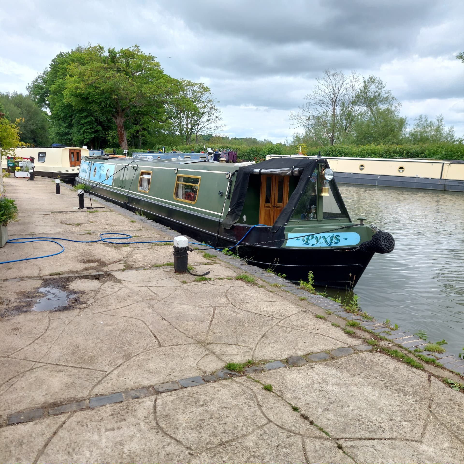

Hello. Long time maker, first time Maslow user. Please be gentle.
I retired from the electronics industry a couple of years ago, sold my house (with very large, heated/air conditioned workshop… _sigh_), cars, 50 years worth of packrat accumulation, etc. in the US, moved to the UK, and bought a 59ft narrowboat. Because I can’t do art on anything without an “undo” function, I’ve been thinking of different ways to paint art on the cabin of our boat. Basically, two flat, very nearly vertical slabs of steel 50 ft long x 4 ft high with holes for windows, lights, fittings, etc.
I kicked around things like using an engraving laser to cut something like vinyl applied to the surface or burn away something paint-resistant like wax to create in-place stencils for manual painting, and lots of other half-baked ideas.
Then I remembered looking at early Maslow designs years ago, discovered there have been continuous improvements, got all excited, and ordered one last night. Looking at it in the clear light of day, I’m wondering if it’s going to be too big and unwieldy to work for my purposes. My thought was to use heavy-duty magnets to attach the belts to the hull, rig up a way to mount a paint pen or other color-dispensing apparatus in place of the router, and go to town. I was hoping the baseplate could sort of “float” near the hull without touching it, so it wouldn’t smear the paint. Am I completely insane for thinking this could work? I guess I can always donate the unit to a local maker space if it doesn’t work out. Thoughts? I’ve read what I can find on using the Maslow to hold a pen or paint marker, but most of those discussions are a few years old. I have only hand tools to work with, and very limited space, but there are fabrication companies in most larger cities here that could presumably make me adapters, etc.
 ![20240603_130857](https://canada1.discourse-cdn.com/flex031/uploads/maslowcnc/original/3X/2/6/2636b69bd7d17384ead7df8a275038e2c20d0ee9.jpeg)
 ![20240603_140620](https://canada1.discourse-cdn.com/flex031/uploads/maslowcnc/original/3X/d/6/d6594b58bd50ae9ce1e455902273d92121525930.jpeg)

Which Maslow did you order?
Re: the M4:
Your biggest issue with doing things the way you are suggesting is that you will constantly be changing the frame size between each cut by not using the same frame each time (because you’d be remounting those magnets) and would need to calibrate before each section.
So, even if the magnets are enough, its still going to be very tedious, if it works at all. I personally wouldn’t want to deal with that, it’s already frustrating to have to re hang it after having it off overnight, I can’t imagine calibrating it before _every_ job.
What I _could_ see being reasonable is using it to cut large stencils and then using those as masks for a paint sprayer, but I dont see you directly attaching any form of Maslow to the side of this and having a worthwhile time.
The only thing I could even potentially see working even a little bit would be a hollow frame with set dimensions that you anchor to a surface with tie downs or something. You’d have to make sure it’s taut and square before trusting your calibration values. It still wouldn’t be able to handle the curves present here, though, and stencils are still way easier to do instead.

I really love what you are trying to do! But I think for this project you 'd be better off with a classic Maslow, with just 2 chains on a top rail ( the lower anchorpoints of an M4 will be underwater I fear), which can slide up and down on some sort of vertical gantry, the gantry then can ride on a track on the roof, while the lower end of the gantry rides with a horizontally placed wheel on the side of the boat. This is when you dont want a sled on the material, when using paint or a spraygun.
But when you are just going to use a marker, a sled on the material is no big deal. Make a topbeam with two motors and stands to put on your roof, which you can relocate to paint other parts of the boat. And a sled with a z-axis and a marker holder.
And I think there will be lots of Classic Maslow Parts available secondhand 😀

I’m going to be a contrarian and suggest that without the router the sled would be considerably lighter, so it might be possible to suspend the sled slightly away from the surface. The things I would be worried about are how much the surface curves, and what you are using to apply the color. Spray paint would probably require a separate mechanism to measure the distance to the “canvas” and adjust its height. Markers might work, but would be subject to some accuracy degradation if you are using a spring loaded mount.
The most important thing you need to consider is that you are going to be way outside the known space, so you will probably need to spend quite a bit of time trying things before you reach a solution. On the other hand, I bet many of the fine folks on this forum will be willing the offer ideas as you hit roadblocks.

I’m going to throw in my own “this is not the way”, but not for the reasons already shared.
I’m basing my “nay” on the basis of using magnets as anchor points in your use case. While magnets can be _incredibly_ strong anchors, their strength is almost completely normal to the magnetic poles (i.e. normal to the surface they’re connected to). While you may not be able to pull a strong magnet directly away from a surface, you can (more or less) easily _slide_ a magnet.

The biggest issue with the frame being for this kind of thing is having it stay rigid, because you would also need it to be completely hollow. You could potentially use tied own straps to help the frame resist the pull from the belts and have it not warp.
I just still see issues with the Maslow sliding across the surface and smearing paint or being suspended and being bounced around by inherent forces from the sled moving or from wind (the sled is basically a sail at that point).
The hollow frame, tie downs to keep it in tension, and some form of gantry to keep the sled level and suspended are all things I’d expect you to need to make this work.
All that said, if you don’t go with a full size frame, the gantry gets less expensive.
