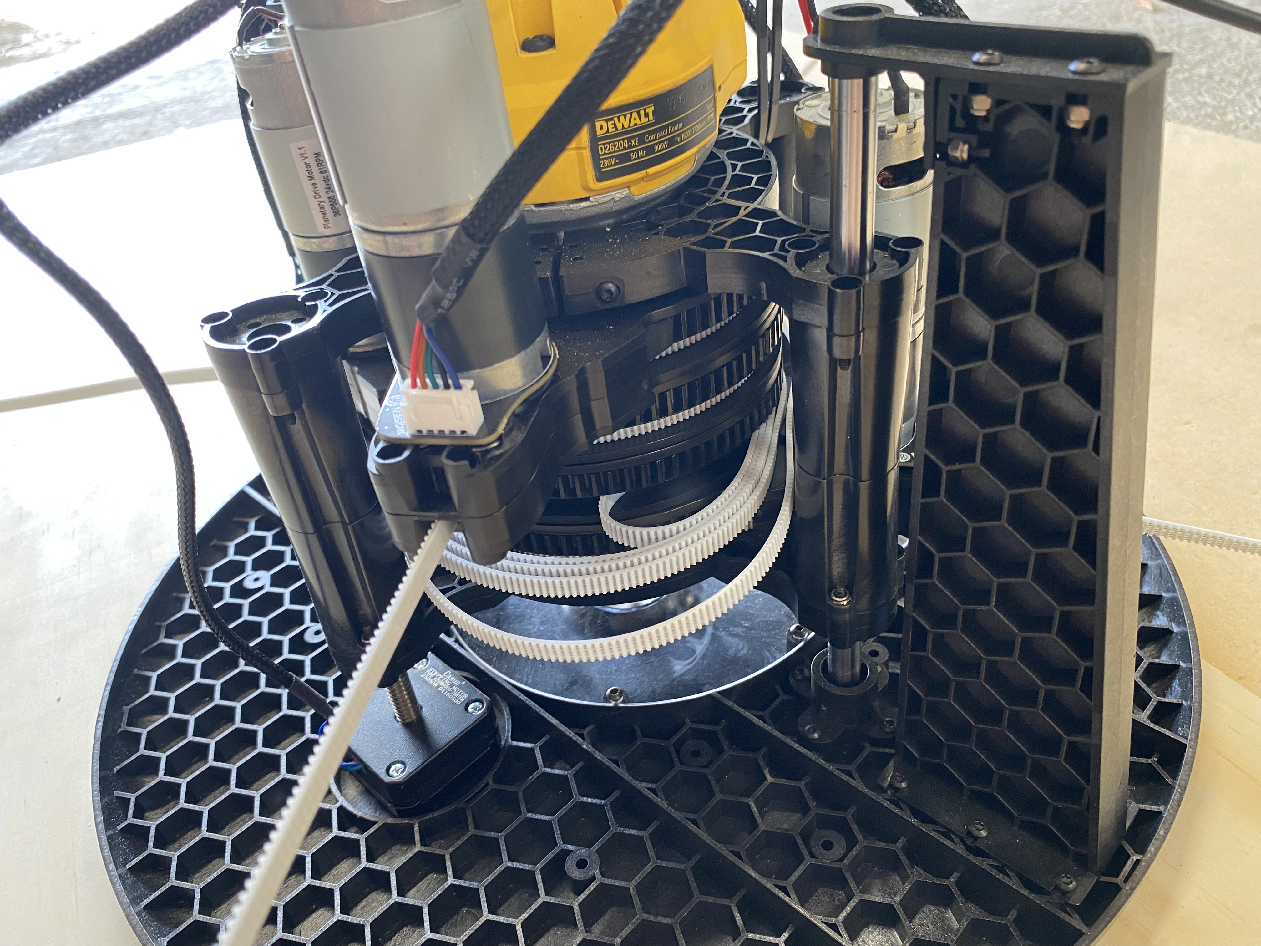

Quick update, today I thought I was finally making some progress. Got it to “ready to cut” state. Generated a small square in Krabzcam, uploaded the file. Did everything with the router bit, got all that set up. Turned the router on, hit play. Nothing happened for about 10 - 15 seconds, I thought maybe it’s taking its time or something, and then I noticed it was doing something, it was unspooling one of its belt entirely. Only one mind you. I tried hitting the Estop, but it wasn’t responding. It continued to unspool until I pulled the power.
So now I’ve got one of the belts unspooled all the way to the point where I think it’s started going the other way on the spool. Not sure how I fix this now.
 ![IMG_8398.HEIC](https://canada1.discourse-cdn.com/flex031/uploads/maslowcnc/original/3X/b/c/bc37aa97bceb73d58bb242763c56977adf86b4c9.jpeg)
**Post date:** [November 2, 2025, 6:34am UTC](https://forums.maslowcnc.com/t/help-with-troubleshooting-unsure-how-to-label-this-yet-to-get-it-to-cut/25134/3 "2025-11-02T06:34:15Z")
The spool which has unspooled, you may be able to ease the belt out without pulling the machine down, Don’t try applying to much force or you may damage the belt. The idea is to work the belt out slowly and carefully.
If it is too difficult you may have to pull that arm apart.

Thanks @ian_ab I managed to slowlyy ease it out and then back in eventually, so thats sorted. But I can confirm that regardless of what Gcode I try, it results in the same thing, zero movement from the maslow, then some tiny little vibrations from that top right motor, and then quite quickly it starts unspooling itself entirely.
If I pause the device at this point, it responds but then I can’t do anything else, zero commands seem to work. If I stop the device it seems to crash entirely and restart itself?
See video below.
