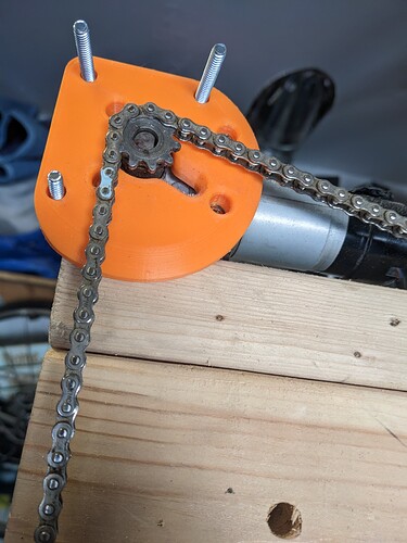

Ok, so I put on chain guards:
 ![PXL_20230225_204054532](https://canada1.discourse-cdn.com/flex031/uploads/maslowcnc/original/3X/6/d/6dd3254bce09b6a0a0a3fcf99ccd056c2aa9f85c.jpeg)
 ![PXL_20230225_204041687](https://canada1.discourse-cdn.com/flex031/uploads/maslowcnc/original/3X/3/6/369b063754420cc16e2194968bbc35094cd125bb.jpeg)
The top guards held on by the wing nuts are removed in both pictures.
I changed the motors in a round robin and found that they all do the same thing. More on what might be the issue behind that later.
This is a 1.28 modified version for my specific shield with TB6643 chips on it.

**Post date:** [February 26, 2023, 6:54am UTC](https://forums.maslowcnc.com/t/home-offset-after-every-cut/18645/8 "2023-02-26T06:54:14Z")
actually, the encoders don’t measure the absolute position, the measure
movement, so just like steppers, if there are hiccups (power issues, connection
issues), they won’t report movement (or if the problems are timed exactly wrong,
they can report movement in the wrong direction for a step)
