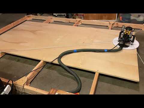

We had a request a little while back for some more testing in the horizontal configuration and now that the long lead time parts are in production I had a chance to play around with it.
The upshot is that horizontal works great which was pretty much to be expected given how much less force is needed for horizontal cutting vs vertical cutting. The only real issue that came up was how to keep it from cutting it’s own power cord and the solution as to tape it to the dust hose.
Here’s some random clips. Nothing is sped up, this is 1900mm/min at 3mm depth of cut and 2500mm/min when repositioning. Everything felt great and I’ll probably do 5mm depth of cut next time I cut something.
[![](https://img.youtube.com/vi/dUDiG9LDilU/maxresdefault.jpg "Horizontal Test Footage") ](https://www.youtube.com/watch?v=dUDiG9LDilU)
Notably in here you can see how much a difference having four belts makes when the sled is close to the edge of the sheet without support.
You can also definitely see the flex in the sled when the weight transfers from one direction to the other which we will need to fix before we ship. I’ve got lots of parts on the way for fixing that so hopefully we’ll be able to test them soon.

Oh yeah and ignore those mess ups in the right corner, those are left over from a firmware/encoder issue that I was having at first. I’m 90% sure I’ve got it fixed, but I want to verify that I know exactly what was going on and write about it in the next update.

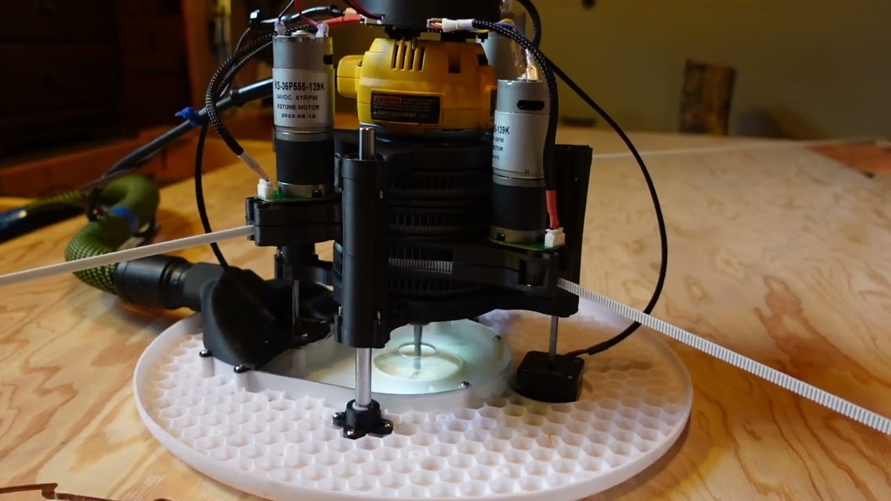

**Post date:** [September 24, 2023, 5:48pm UTC](https://forums.maslowcnc.com/t/horizontal-configuration-test-footage/19391/3 "2023-09-24T17:48:27Z")
please test with the anchors at a height to make the belts parallel. I think
that will reduce the pressure on the sled and make it a little less tippy.
I also see that the tower is screwed to the sled, is that a temporary thing and
the mounts will be cast into the injection molded sled? or will that be a
permanent option? I like the idea of it being a permenent option, I expect to
see a plastic sled damaged over time (even before looking at options like a
plasma cutter) the ‘slippery’ plastics aren’t as durable as some others

**Post date:** [September 24, 2023, 7:15pm UTC](https://forums.maslowcnc.com/t/horizontal-configuration-test-footage/19391/5 "2023-09-24T19:15:50Z")
I was actually referring to the entire mechanism, but those are the feet screwed to the sled that I was referring to
**Post date:** [September 24, 2023, 8:10pm UTC](https://forums.maslowcnc.com/t/horizontal-configuration-test-footage/19391/6 "2023-09-24T20:10:48Z")
Gotcha, yes everything attaches with screws (I think they are technically bolts because there are nuts). Everything can be taken apart and put back together with a single Allen wrench and we will absolutely have spares available for anything that could wear out.
**Post date:** [September 25, 2023, 7:46am UTC](https://forums.maslowcnc.com/t/horizontal-configuration-test-footage/19391/7 "2023-09-25T07:46:01Z")
Thanks, one of the earlier videos made it look like you were going to do more
with the injection molded sled and mold towers into it that everything else
would attach to. That would make it significantly harder to change out
