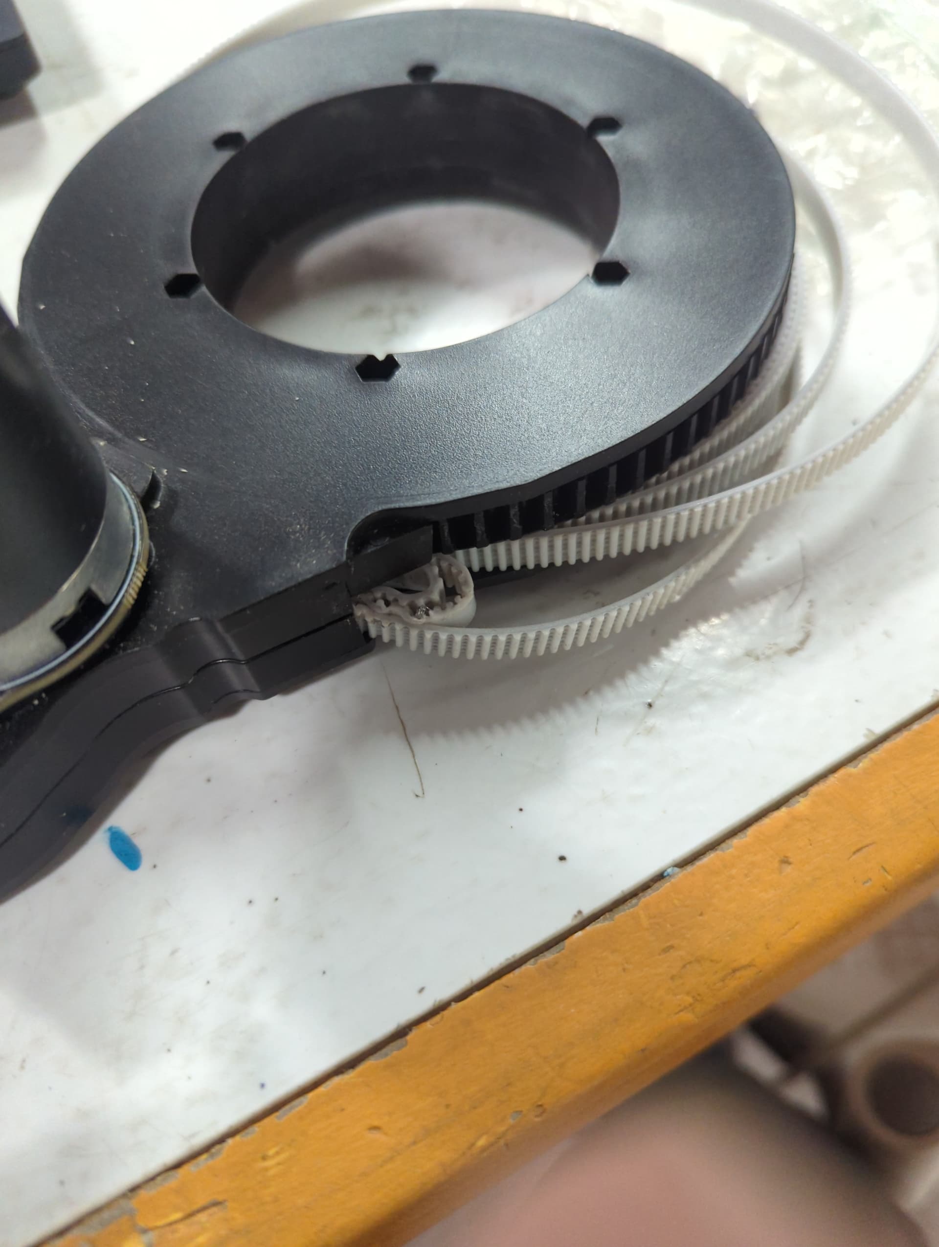

I had a working yaml file and decided to run calibration to see what difference it made
This is on the super simple frame with gussets top and bottom (a very rigid frame)
This frame is ~30” square, a usable working area of 350mmx350mm
I did a 9x9 calibration over the entire area, fitness just over 2
I then tried to jog and it refused saying it didn’t know the belt lengths, that they needed to be retracted (see attached log file)
Then I noticed that all the belts were slack, with the belts way out on the spool, and the top spool was slowly moving (the belt wasn’t moving, it was tangled quite badly.
so something went significantly wrong here, and I have no idea why @bar

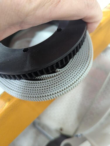

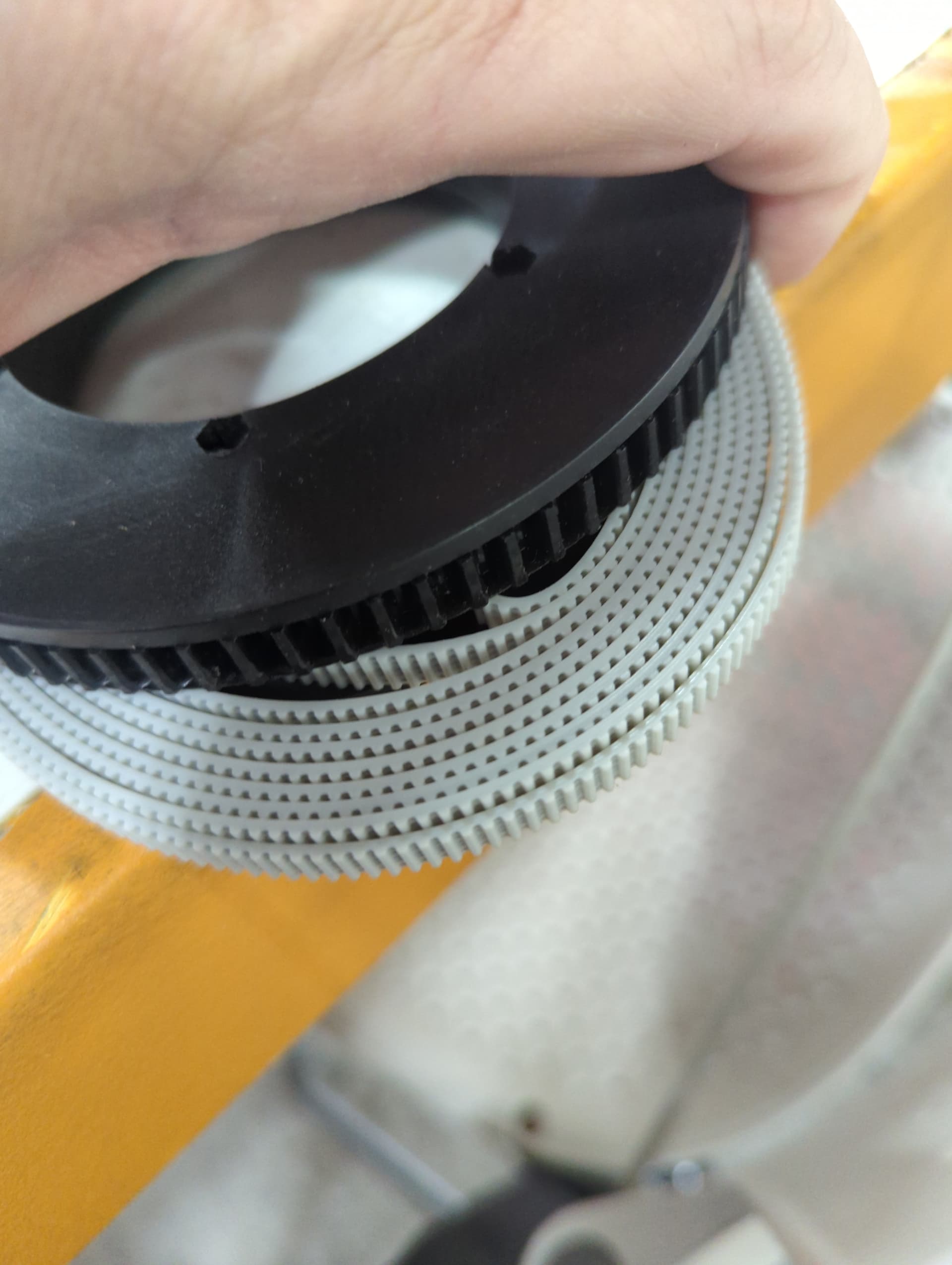

Also, with a small calibration area, the first 5 points don’t scale down, they
move a fixed amount, and feed out WAY too much belt in the process.
**Post date:** [September 7, 2025, 1:49am UTC](https://forums.maslowcnc.com/t/horizontal-machine-finished-calibration-then-extended-belts-while-complaining-they-hadnt-been-retracted/24826/5 "2025-09-07T01:49:06Z")
both of these belts unwound to the point that the belt doubled back on itself,
one destroyed the belt, the other was stopped by me unplugging the machine in
time.
